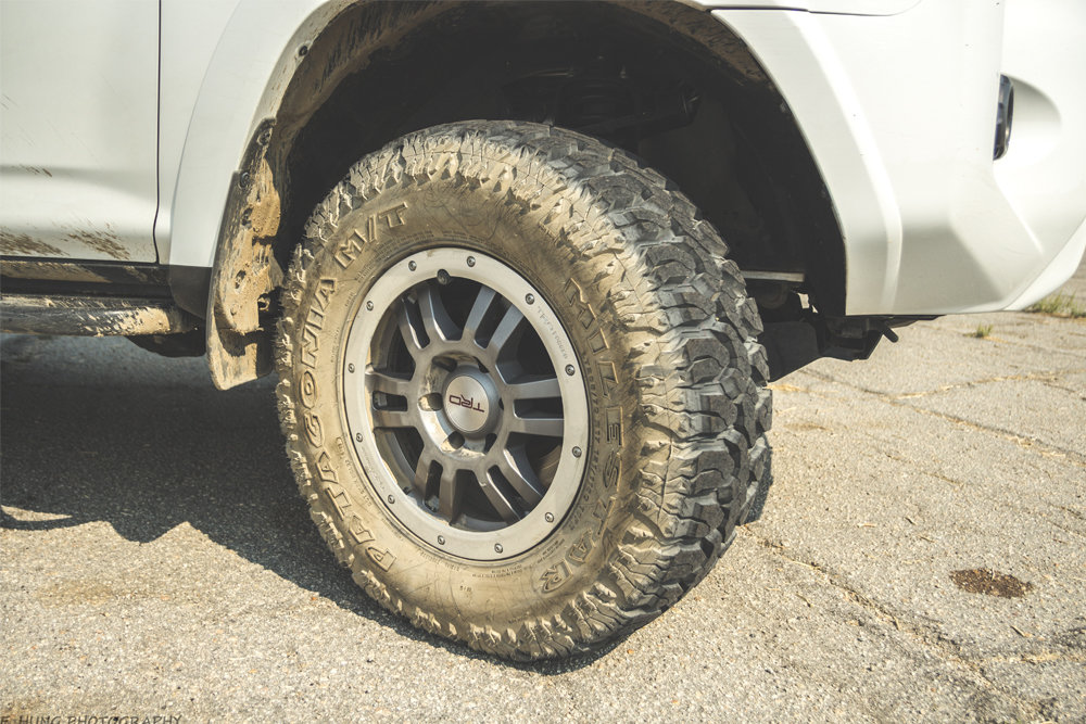

    The TRD Pro wheel is 17x7 and has an offset of +4.
    The TRD Offroad wheel is 17x7.5 and has an offset of +15.
    SR5 wheel is 17x7 with an offset of +15.
    None of the current stock offerings reflect the stats he gives for "forged wheels." Maybe he's talking about something aftermarket since he mentions faux beadlocks in the line below that one??

    Edit: this is the forged wheel
    milestar_patagonia_m_t_off_road_tires_review_5th_gen_4runner_05.jpg.
    Slopemaster and nimby like this.
