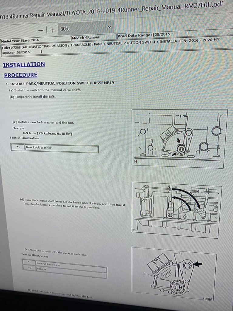

    Brainstorming here… is the D indicator on when you reverse and put it in D or N… could be a case of neural safety switch? It’s common isn’t it? I heard something about this possibly
    Edit, or the other way around it still shows like P or R or N while you have it in D then, it jumps into D and on dash it changes to D ?

    Thanks again for all the suggestions! The gear indicator flips through all gears like normal, no delay in the indicators at all. I get it from park to Drive, indicator says D, I sit for a sec idling, take foot off the brake or give some gas and it launches forward into gear im assuming. The indicator never has changed or been delayed at all. There are no dash lights on either that would make me aware of any issues.
