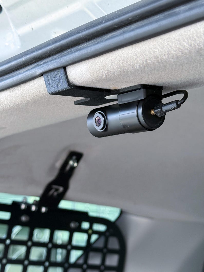

  4. Jul 27, 2025 at 6:38 AM
    3,792
    This isn't my ride, but it shows how easy it can be mounted to the interior.
    Bagman and whippersnapper02 like this.

    There's no doubt that the headliner mount is simpler, and I considered buying the same bracket as in your photo. It seems that mounting the cam on the liftgate itself would give a better image.
    I'm wondering if it would be worth the effort to do that.

    I think this mount is a great idea:
    BUT, invert it, trim it, find some rattle can spray paint so it matches your body color. Then mount it on TOP of the rear spoiler. You'd have to drill into the spoiler to run the wiring. But it would have an OEM-ish look and it would have an obstructed view.

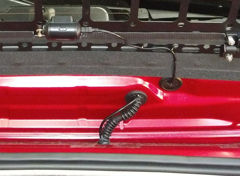

    I mounted rear cam to the hatch. Running the cable for the cam was not to bad. I moved it to the hatch because I kept knocking it off every time I reach for things in the cargo area. Now it is out of the way when I open the hatch.

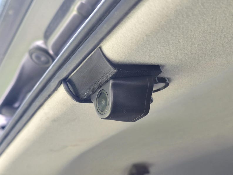

    I have a 3D printed mount for the rear but just purchased the mount @Borracho Loco posted. I ran the rear cable down the passenger side door sill following existing wiring and the rear washer tube.

    That looks like a good solution, and mounting it to the interior using one of the three trim fastener spots would definitely be easier than trying to run the cable through to the liftgate. Thank you.

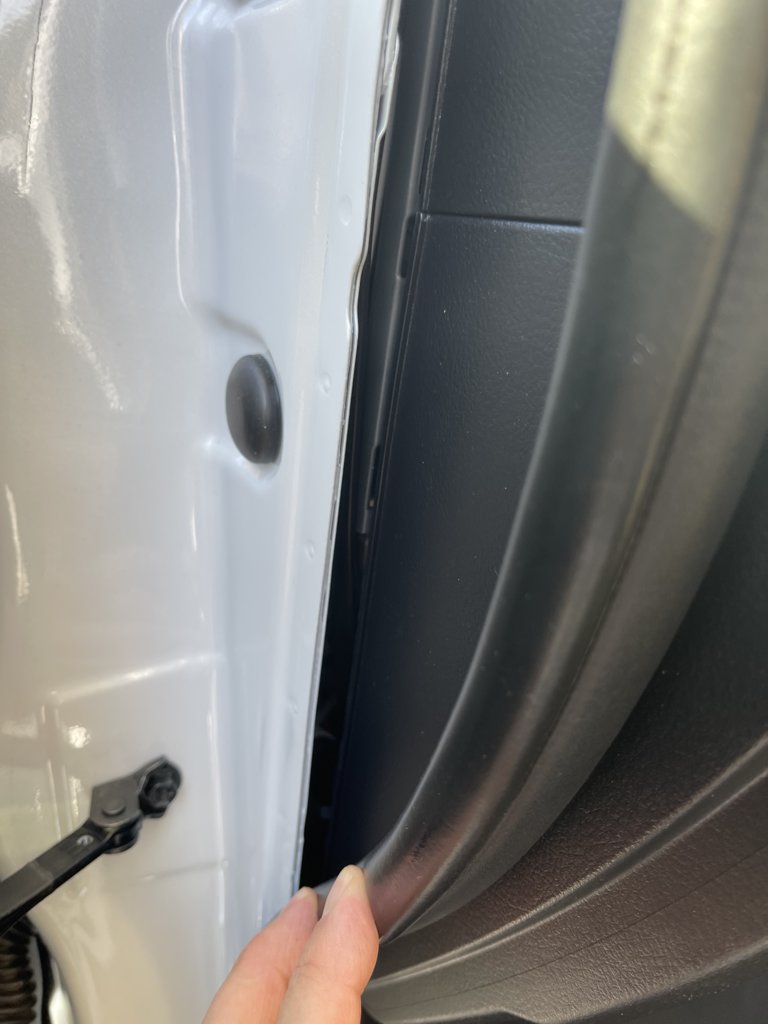

    Run the cable behind the door rubber seal and slip it through the hole inside and down to the fuse block.
