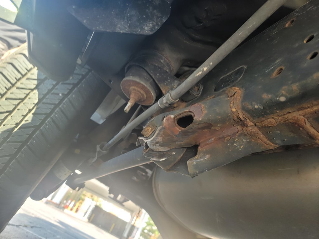

    I just bought my 5th gen sr5 3 weeks ago and a drainage grate decided to mess my car up has anyone seen damage like this and do you think I need a new frame. It didnt bend my frame just that part.

    I was driving and a street grate caused some damage. Just wondering if anyone has seen damage like this and thinks I need a new frame?

    looks like you will need to cut away that frame section, weld in a new one and fabricate a replacement lower link bracket.

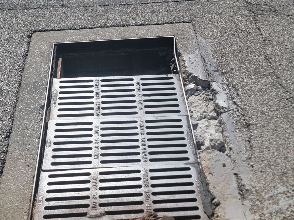

    A drainage grate popped up and destroyed my rear passenger side wheel and tire and bent that part of my frame. Freak accident but that's my luck.

    Thats the whole after the grate fell back down into the drain.

    That mount looks very damaged.

    I think you will need to have that control arm mount cut off and a new one welded on. You’ll also need a new lower control arm.

    I imagine that can be fixed, but it's probably going to need to be done by a frame shop, I would think. Any chance you could report this to the city and see if they'll cover the repair? Street grates aren't supposed to just jump up and damage vehicles.

    Toyota sells that bracket under P/N 5150C60030 Buy from your local dealer or online at a site like https://parts.lakelandtoyota.com/p/__/3955714/5150C60030.html
    A shop can torch off the old bracket with a plasma cutter and weld in the new one without much trouble.
    You'll need a replacement lower link as well: https://www.rockauto.com/en/moreinfo.php?pk=10907964&cc=1445180&pt=10401&jsn=462

    You will need a new lower control arm..

    Repairable by a good weld shop. I See rust on frame parts- post more pics of entire frame.

    Its just a control arm bracket. They get beat up on these. A 4x4 fab shop can weld in a new one, its not a big deal.

    Find a reputable body shop with frame repair experience and let your insurance handle it.

    I highly doubt it gets totaled due to a bent bracket.

    Might not want insurance to handle it if it's under say $800. The parts add up for ~$100 from the links I posted.
    It looks like an easier repair than a cab mount chop commonly done for tire clearance. Off-road specialty shops can do this too, even some 4WheelParts locations.
