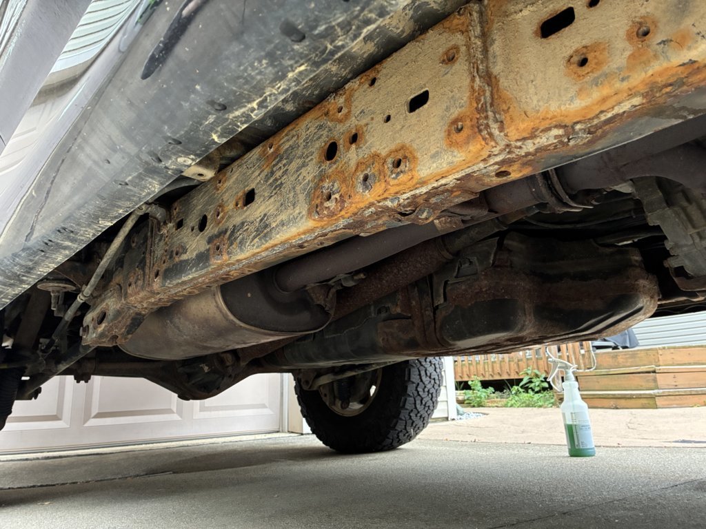

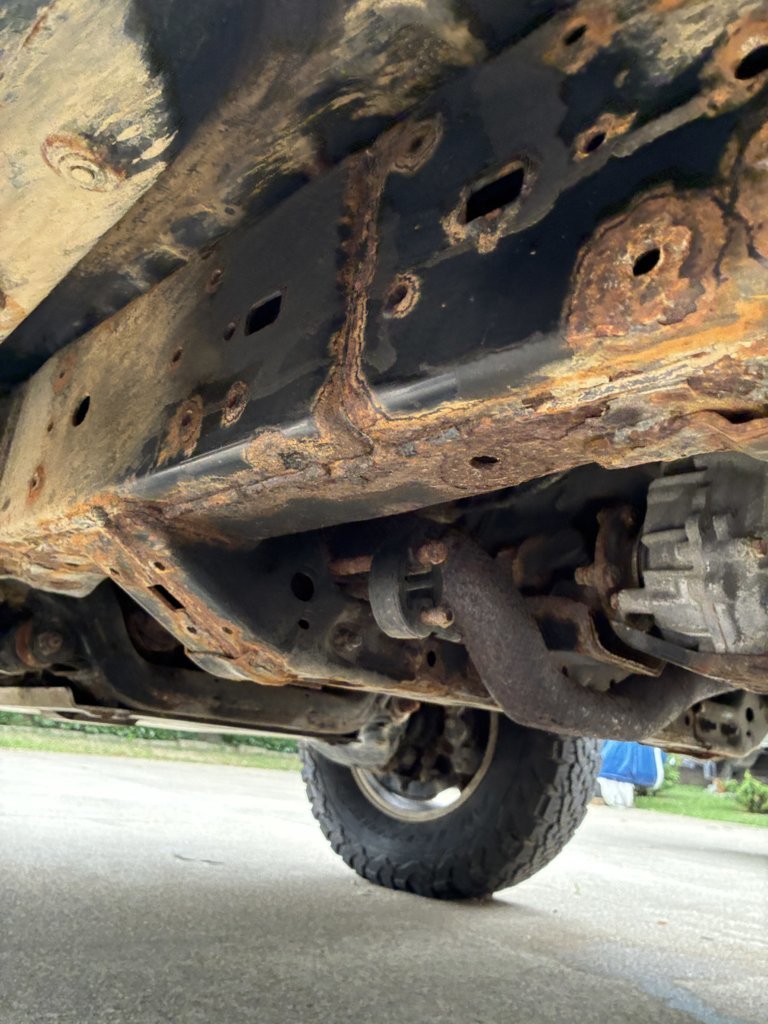

    How bad are we looking, scale of 1-10?
    This bad boy spent 5 years in Newfoundland, now in New Brunswick (Canada).
    Am I in big trouble? Or worth it to get some undercoating?
    Don't plan on towing anything or off-roading, just trying to survive Canadian winters.
  2. Aug 11, 2025 at 6:31 AM
    Ripper238
    Ripper238 New Member
    #30792
    1,303
    2019 TRD OR
    Its not that bad, a little more than superficial in some spots. Easily taken care of with some Blaster surface shield rust protectant.
    GobBluthEsq[OP] likes this.
  3. Aug 11, 2025 at 6:33 AM
    3,401
    IMHO, 7.
  4. Aug 11, 2025 at 6:57 AM
    GobBluthEsq
    GobBluthEsq [OP] New Member
    Aug 11, 2025
    #48458
    5
    That's what I was afraid of :confused:
  5. Aug 11, 2025 at 6:59 AM
    GobBluthEsq
    Aug 11, 2025
    #48458
    5
    Was gonna get a full underbody rustproofing from a local shop - would that do the same or worse than blaster surface shield?
  6. Aug 11, 2025 at 8:15 AM
    Ripper238
    #30792
    1,303
    2019 TRD OR
    That's a good question. Anything is beneficial, especially it being done professionally since its a pain to do your self without a lift.
    But Blaster does have some advantages over others according to some testing.
    That said you could ask the shop on there thoughts. But getting it done is key.
  7. Aug 11, 2025 at 8:34 AM
    3,401
    Get it rustproofed yearly and it should survive another 5 years or more.
  8. Aug 11, 2025 at 8:38 AM
    3,401
    Depends on the product they use. Rubberized undercoating offered by dealers is a death sentence. The thin-film coatings Rust Check, Fluid Film, Woolwax, Krown, etc. are good.
    4onto, Too Stroked and Ripper238 like this.
  9. Aug 11, 2025 at 8:45 AM
    6,288
    If you have a shop do it, make sure they don’t use rubberized or hard coatings. Those will trap water behind the hard coating wherever they chip. It will look great until you realize the frame has dissolved underneath the hard coating.
    Best bet is to find a shop that applies “wet-film” coatings like fluid film, wool wax, NH oil coating, or anything oily really (like surface shield. Personally I coated mine with Wool Wax, which is natural lanolin. It’s greasy at first, but it the road grit/trail dust will be absorbed by the lanolin and it slowly oxidizes over time. If you recoat it/touch up every year or two, it turns into a durable crust that is still pliable. It looks like crap, but it does a really good job. Touchups are necessary with any product, since there are spots where weather will erode the coating.
    Coating the insides of the crossmembers and frame rails is important as well. Do not let a shop drill holes anywhere to spray product. Body plugs already exist to get inside anywhere. That said spraying inside the rocker panels runs the risk of plugging up the drainage built into them.
    Ironguy and Ripper238 like this.

  12. Aug 11, 2025 at 2:49 PM
    GobBluthEsq
    Aug 11, 2025
    #48458
    5
    there’s a krown by my place I was gonna check out!
  13. Aug 11, 2025 at 3:57 PM
    GobBluthEsq
    Aug 11, 2025
    #48458
    5
    Dang, I hope I can make it more than 5 years only o_O
  14. Aug 11, 2025 at 4:45 PM
    10,975
  15. Aug 11, 2025 at 5:05 PM
    Dillusion
    Dillusion Resident A**h***
    Dec 10, 2018
    #7998
    3,338
    Kyle
    2018 TRD OR
    If this is a 7 some guys here have 20s

  18. Aug 12, 2025 at 6:43 PM
    Trail Runnah
    Trail Runnah New Member
    May 8, 2020
    #14189
    3,249
    2013 T4R Trail Edition
    It's not really that bad. All the people from out west will say that it's terrible, people in the Northeast will say it looks fine.
    My 2013 that has spent its whole life in New England looks about that, with heavy rust on the trailer hitch and wiring plug like you have. When I got it 6 years ago I spent some time wire brushing everything off and treating it with fluid. Film, hasn't really gotten worse since. I had it applied professionally the first year, and then I've touched it up myself every year since with spray cans.
    The comment about treating it and getting 5 years is very pessimistic, you could do zero to it and still get more than 5 years out of it. If you treat it and stop it where it is, there's no reason why you couldn't get 10+ more years out of it.
    4RunRap556, Toy4X4, R1200Jedi and 2 others like this.

  22. Aug 15, 2025 at 2:43 AM
    9,352
    Welcome from Wisconsin! Just think what it could look like if it had been coated from new. It's a 5-6 on a scale of 10, it can be cleaned up and treated, but it may take some time and a good rust preventative. Good luck.

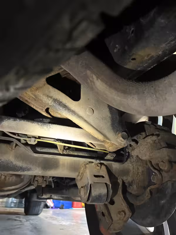

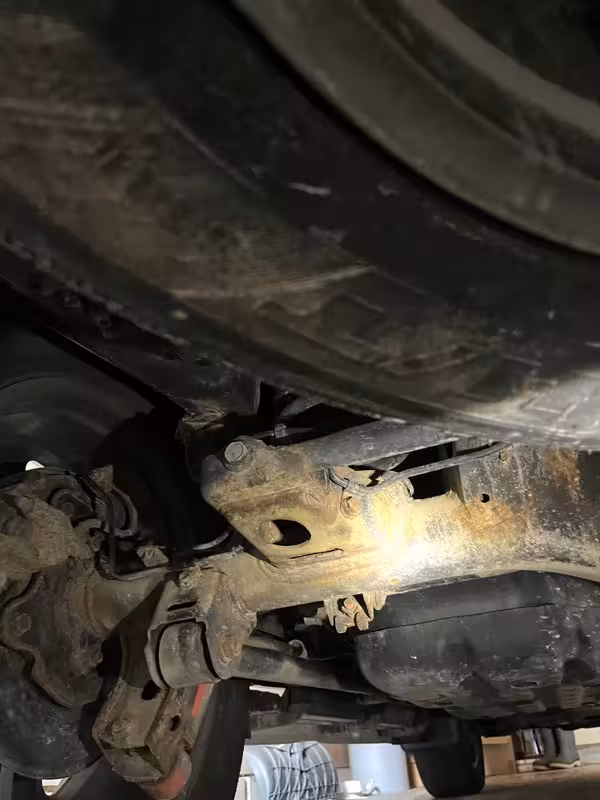

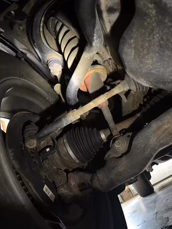

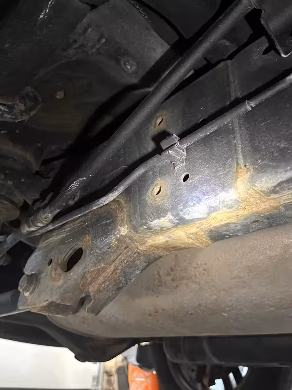

  23. Aug 24, 2025 at 5:18 AM
    giddyup22
    giddyup22 New Member
    Saturday
    #48655
    2010 T4RSR5, 2023 TacomaSR5

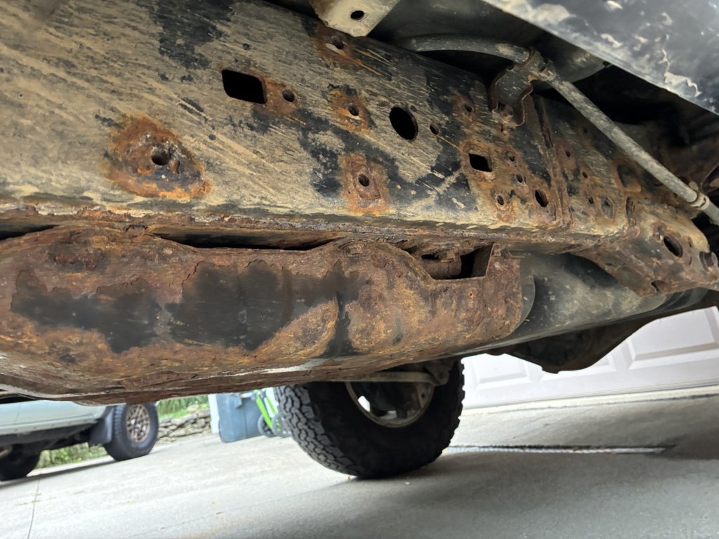

    I wouldn't worry about your frame one bit.
    Here's my 2010 w/184k, lived in OH its whole life. I took it to a welding shop last summer so he could blast air at the frame and check it. He wasn't able to punch any holes through it. Though it looks rough, it's solid. This is my 4th runner, the (2) 3rd gens I owned, well that's a different story :(

  24. Aug 24, 2025 at 7:51 AM
    Ripper238
    #30792
    1,303
    2019 TRD OR
    Even that's no so bad. A good amount of Blaster shield or Fluid Film would stop/fix that.
    I grew up with solid frame vehicles and it takes quite a bit of rust for it to be an issue.
    Trail Runnah likes this.
