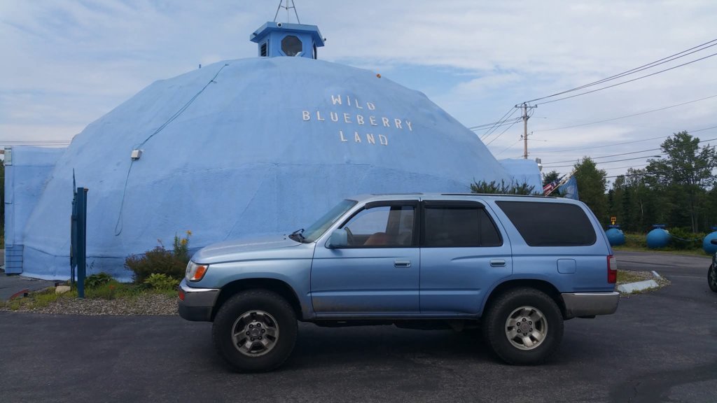

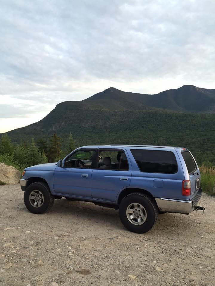

    98 4runner sr5

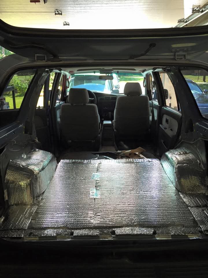

    Using this vehicle for hunting, camping, fishing trips and sleep inside alot cause its just me and I'm either at the end of a logging road somewhere remote or a sketchy trailhead parking lot.

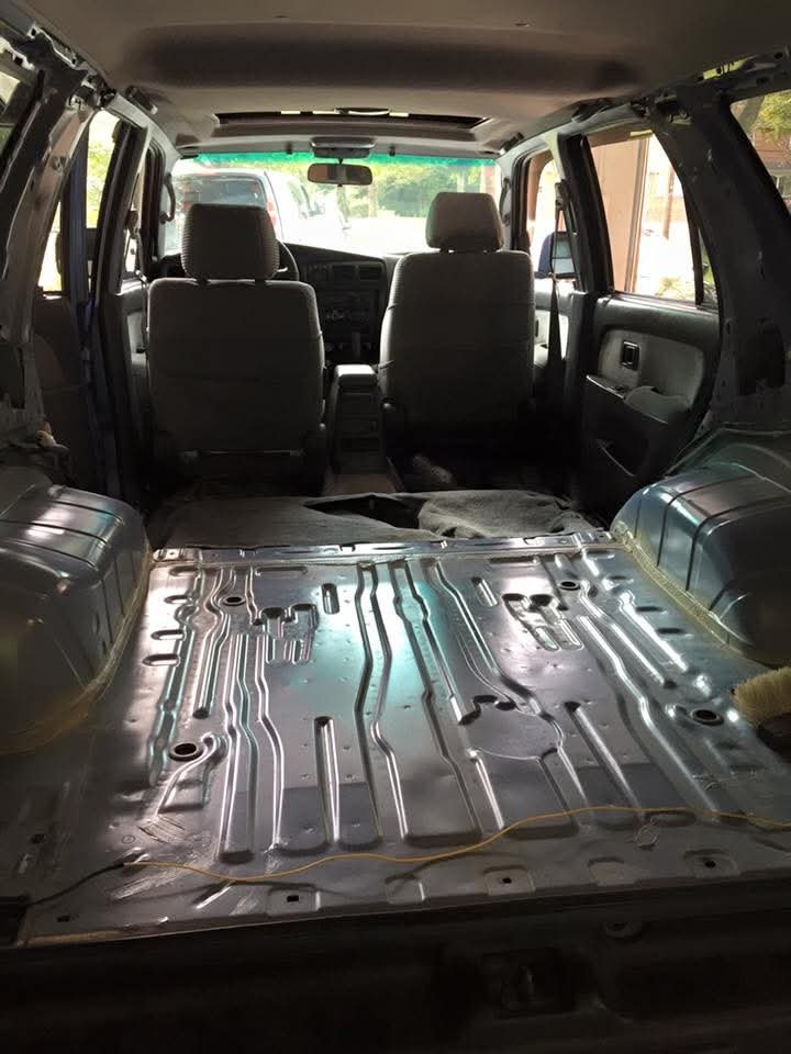

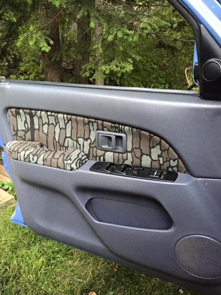

    Gutted everything out of the inside and layed down 2 layers of reflectix insulation. Even managed to get a layer in the doors too.
    Goal is to keep the inside cool or warm based on the seasons.

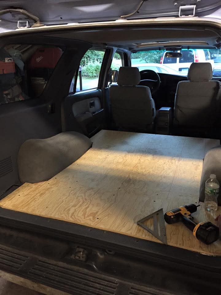

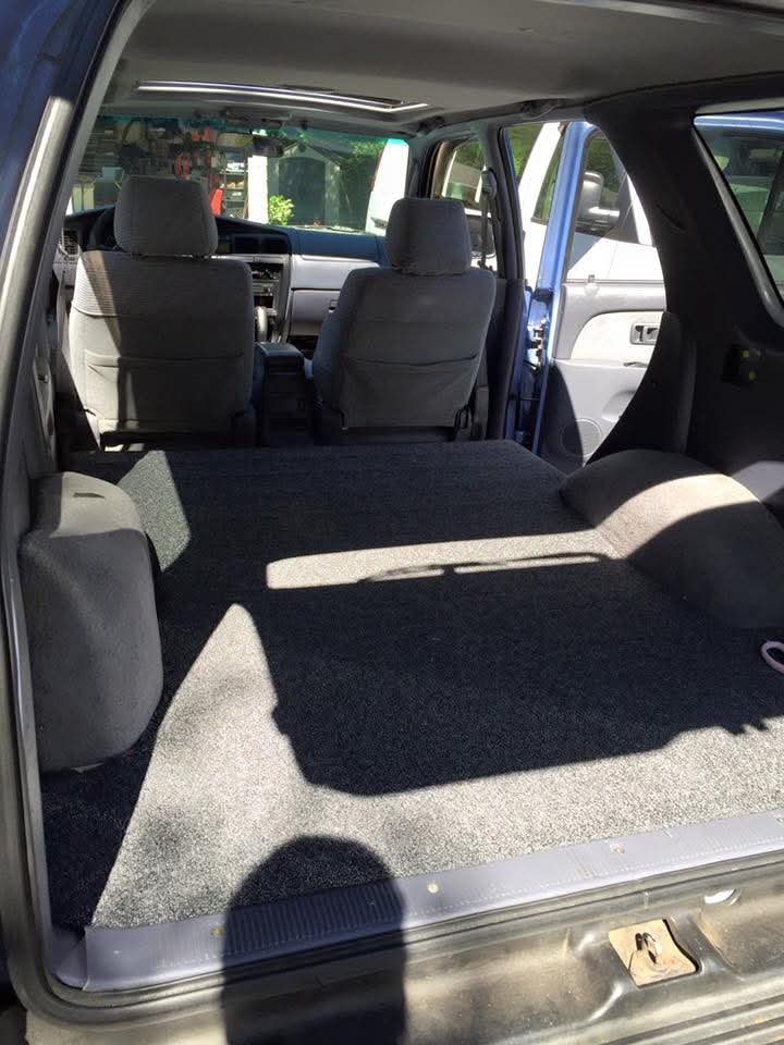

    Deleted the back seats and made a level subfloor. There's a bit of storage under the front half that I keep tow straps, an air pump and tire patch kit and a battery start pack. Also first aid kit and a small fire extinguisher.

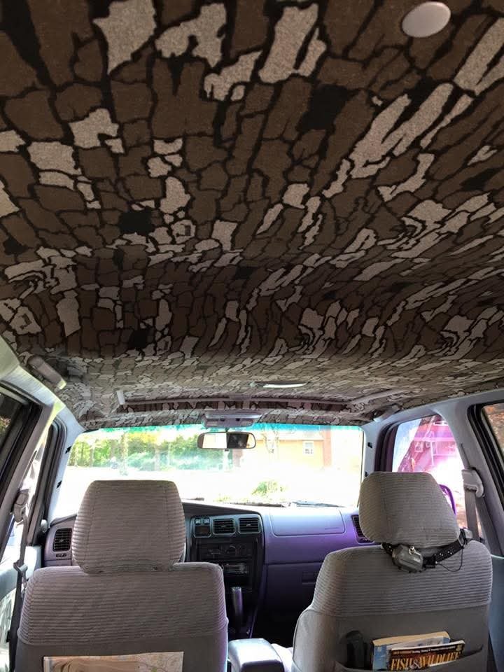

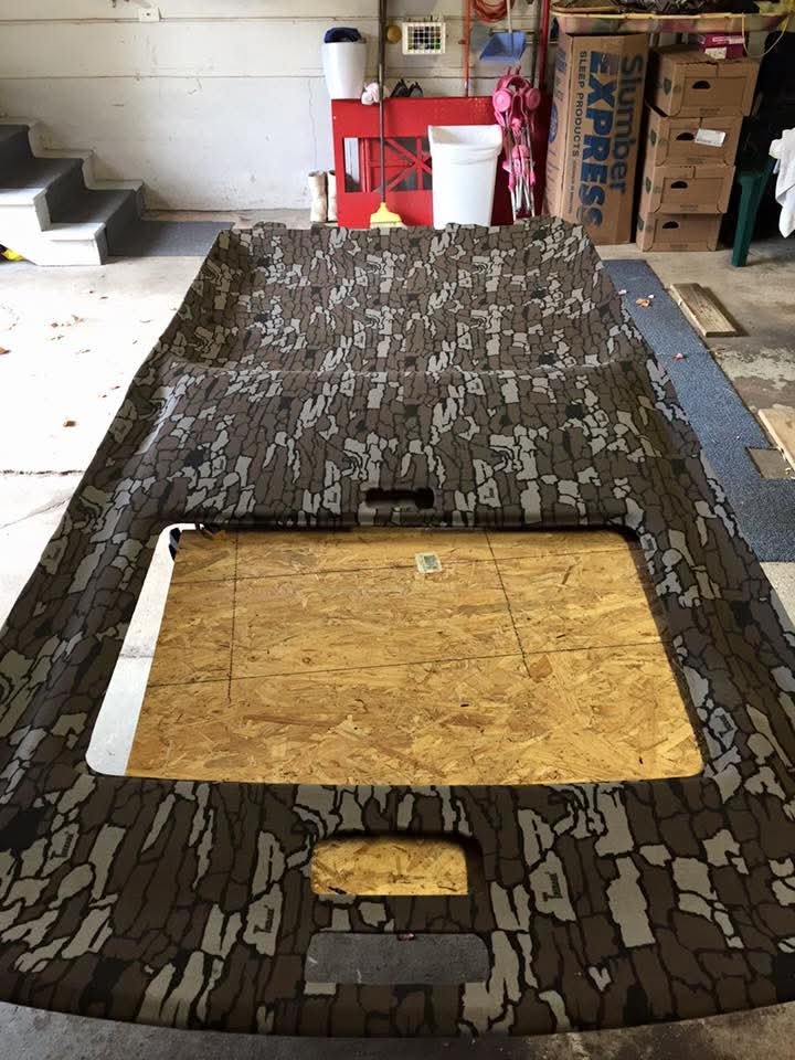

    Carpet on the floor and then did ol school trebark camo on the headliner, sun visors, and door panels.
    The glue I used is the permatex orange can spray adhesive which I feel works the best compared to other brands I've tried in the past.
    Anyway, here's some pics I thought you might like. FB_IMG_1754511095234.jpg FB_IMG_1754511138839.jpg FB_IMG_1754511153806.jpg FB_IMG_1754511162525.jpg FB_IMG_1754511169285.jpg FB_IMG_1754511176746.jpg FB_IMG_1754511193609.jpg FB_IMG_1754511199520.jpg FB_IMG_1754511031571.jpg
