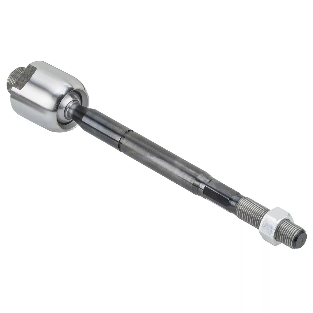

    Also the inner tie rod, is a ball and socket mating surface that DEFINITELY goes bad with age. Normally on the offroad/gravel road 4runners they wear out around the 200,000-250,000 mile range. Bigger tires wears them out even quicker.
    If the tires are braking, and causing the tires to "wander" along the road surface, a little slack in that ball and socket could make the wheel feel like its pulling or wobbling side to side.
    Normally they are diagnosed by a funny "rattle" or vibration in the steering wheel going over rough terrain especially gravel roads, and you can notice a difference in the vibration when you are turning, and not turning. This extra load on the ball and socket during a turn can make it feel tighter, or more loose and vibrate or rattle more or less depending on load. This ball and socket is what is inside the boot on your power steering linkage. These definitely go bad, country driven Toyotas wear these out in the 200,000-250,000 mile range.
