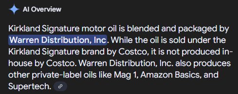

    Does anyone know who makes the engine oil for COSTCO? Wifey is on my case to start buying oil from COSTCO. (For my T4R, so it would be 0W-20 Synthetic)
    I have been a diehard VALVOLINE user for decades, but she is on a penny pinching kick.
    I haven’t priced COSTCO oil yet, so I’m not sure just how many pennys we would actually be saving, not to mention the quality of the oil- I don’t want to cause long term harm to my “bullet proof” legendary 4.0L V-6. (2022 model)

    Warren is where Costco and many other manufacturer oils come from. Project Farm ran a test on multiple oils and for everyday use, it won’t make much of a difference.
    I have been using Kirkland oil for years on all of my cars. The only issue that I have had in the past with Costco, was that it was only available in 5 quart jugs. They solved that and you are now able to buy in 12 quart cases online.

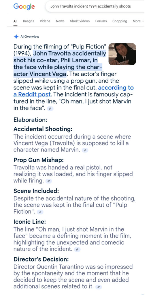

    Beware of "AI" and similar large-language model/generative answers as the first (and last) stop for truth!
    The technology is great at creating correctly-written text in response to a prompt but problems is that randomness is inherent and the training data quality varies. (and that's before touching the human, social, political, financial pressures at play too. https://kaveland.no/posts/2025-06-06-library/)
    Steely123[QUOTED] likes this.

    Kill yourself over a USB? seems kinda extreme, but hey if the interwebs says to.
    icebear[QUOTED] likes this.

    He didn't???
    Steely123 and icebear[QUOTED] like this.

    According to Oil Geek testing, Napa Oil (made by Valvoline) had fewer wear metals in the oil analyses when compared to the Costco/Walmart oil made by Warren Distribution. Napa's oil had more Moly in its additive package.
    They were all pretty close though.
