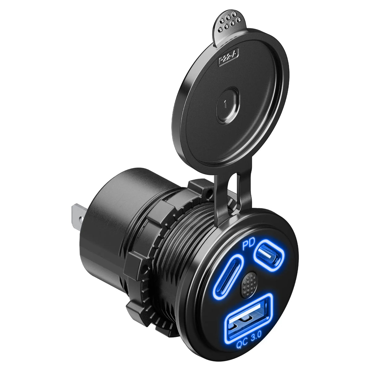

    I'm converting my front cigarette port to this week to this - I'll let you know how it goes: https://powerwerx.com/panel-mount-usb-typec-qc40-75w

    Usually had for around $45. Plug and play Toyota accessory:
    Electronics, Dual USB Power Port - Toyota (PT976-03201)

    No drilling, just light filing down of the plastic hole where the cigarette socket was, since its a bit smaller diameter than the USB socket I installed. I'll post some pics soon

    Here's the thing people in here linked installed in the rear.
    I recall the cigarette lighter being slightly difficult to get off and I think I just cut it, then dremelled the hole larger.

    Labops 5th Generation 4Runner Dash Mount - Injection Molded
    Powerwerx PanelUSB-DualQC4 (Used on Labops dash mount)
    Powerwerx PanelUSB-75W
    Shout out to Ham Radio Outlet for such fast shipping on the USB sockets (even though their local store is an hour away). My Labops RAM dash mount came with a dual USB-A socket (outdated) so I decided to change it out for a dual USB-C socket from Powerwerx. Figured if I was going to go through all the trouble of wiring it up I might as well switch out the front cigarette port I never use to USB-C as well. Super easy considering I don't know much about wiring stuff up.. would recommend. Only "cutting" I had to do was a slight bit of filing down of the hole where the cigarette port was, as it was slightly smaller than my USB socket. I went a bit extra and skipped the t-taps provided and soldered, inline-fused (7.5a each socket on 15amp cabin fused line), then used heat shrink on everything as I'm not interested in any safety issues down the road

    This is what i did. I like the little volt meter
