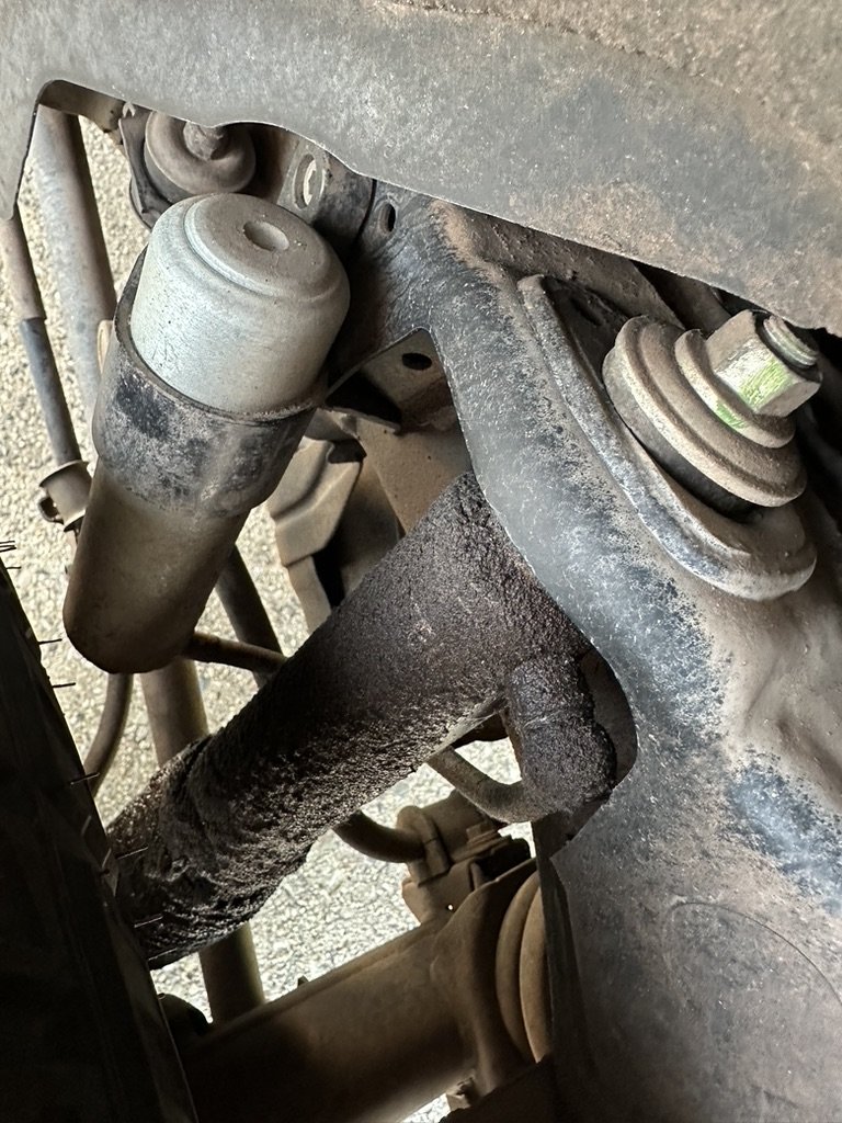

    Researching shocks I was led to believe Bilstein 5160s were a good choice and that issues with leaks had been addressed by the manufacturer. Not true. The warranty claim process with Shock Surplus has been a days long nightmare. Can anyone recommend a quality shock from a reputable supplier?upload_2025-6-12_21-28-28.jpg

    How many miles on them?

    About 3,000. Put them on in February.
  5. Jun 12, 2025 at 7:29 PM
    815
    wow that looks awful for 3000 miles
    those puppies have been leaking since day 1

    Ugh... that's not good. Think I have about 20,000 on mine. So far so good, but I'll keep an eye on them.

    Why didn't you install the anti-rotation washer/pins?

    Huh?

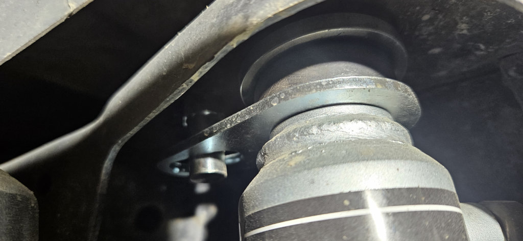

    There is supposed to be a pin and washer to prevent the shock from rotating. This is what it looks like looking up from the bottom.

    Thanks for the pic. I was totally unaware. I had these put on by a local guy who works on 4runners and Tacomas. Good guy and seemed quite competent. He's an Ironman distributor so I don't know how many Bilsteins he installs. I'll take a look tomorrow. Not going to submit a warranty claim if it's leaking from improper installation. May have to buy a new one, the other looks fine. May have to see if I can get hardware for the other side.
    I appreciate the heads up.

    i have 5100s in the rear of my 2011 (70k on shocks) & 2022 (50k on shocks) with no leaks. Im always suspect of those remote reservoir shocks regardless of brand.
  13. Jun 14, 2025 at 6:21 AM
    2,428
    probably the reason why they leaked from pulling and twisting on that line.
