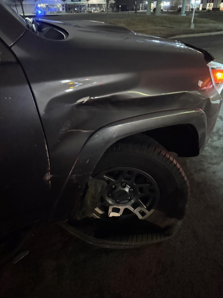

    My beautiful 2023 ORP got hit by an idiot next to me who decided to abruptly turn left into my right front wheel well. No one was hurt, and it is currently being repaired at a Toyota certified collision repair shop. Insurance has been pretty helpful, although they initially tried to get me to send it to one of their favorite repair shops. They relented when I insisted on the shop it's at.
    Any advice on how I can make sure that the repairs don't miss anything to avoid problems later? What should I ask or look for? Should I visit the repair shop and have the technician explain all of the damage to me? I'm not knowledgeable about these things and would appreciate advice.

    The biggest thing you'll need to worry about is making sure the paint matches. Before you sign ANYTHING to confirm their work is "Done" inspect the paint very carefully and with great lighting. If it's dark, cloudy or raining, don't agree to pick up the 4Runner.
    Most of that damage looks minor. But you should also inspect the UCA, LCA and brake rotors/lines.

    If it's a reputable shop you will have a warranty on their work, ask them about that. I agree with Loco, make sure it's a bright day, look at several different angles and distances, make sure the paint matches perfectly.

    In addition to good advice given here,
    the wheel could be slightly bent. Any marks on rubber or wheel its self?
    A tire shop can check for roundness and runout (wobble). They should dismount tire first.
    Verify this inspection is covered by insurance.
    The bill will probably be around $2,500 - $3,000 after all is completed.
    What does other vehicle look like?

    According to the repair estimate they are replacing the wheel and tire, along with body panels and bumper. I didn't see mention of the UCL or LCL, so I'll ask about that. Thank you all for the good advice. I'll make sure about the paint and ask about warranty.
    The other vehicle had front end damage where they turned into me (made the job easy for police to find fault).

    One thing some shops by me (at my Honda dealer collision and one independent shop) do is they give a lifetime warranty on the work they perform (obviously not with standing another accident in same area). As Borrwcho mentioned check your paint match many times and in good light. I say fluorescent lighting and definitely out in the sun and move the vehicle in different directions to make sure it matches.
    Also lots of folks on here without an accident had issues with the bumper meeting that front quarter panel. Make sure that looks tight and gapped properly and not loose

    Is the air box inside damaged? I had a truck a few years ago, got hit where the engine air box is, they repaired, a year later I was chasing MAF codes, and all sorts of things. Make sure no nicked wires and everything is OEM, not OE or equivalent… and the paint obviously. But you don’t want to mess around with air/fuel mixture because it’s a parts cannon road if it comes to that
    it should be brought back to “pre loss” condition meaning it didn’t come from the factory with non OEM parts, so it gets OEM parts.

    Depends on how the impact transferred its energy through the wheel / suspension, but I would certainly have them inspect all the suspension (UCA, LCA, tie rods), as well as the steering rack. Insurance is paying, so may as well have literally everything inspected. Some super diligent folks would ask for a frame scan, frames are meant to absorb energy and aren't as bulletproof as some think (that said, highly unlikely any issues there). My 2022 4R with 15k miles is on its second frame, so I'm a little biased.

    Thank you all for the excellent advice. I went to the repair shop today and found out (no surprise) that there was more damage than the initial estimate indicated. Suspension parts on the wheel in question need to be replaced. They did confirm that they use all OEM parts. I will make sure to be picky on the paint as this seemed to be the consensus issue (in addition to insisting on OEM parts). Thanks again. It will be 2-3 more weeks as they wait for parts. I miss my 4Runner.
