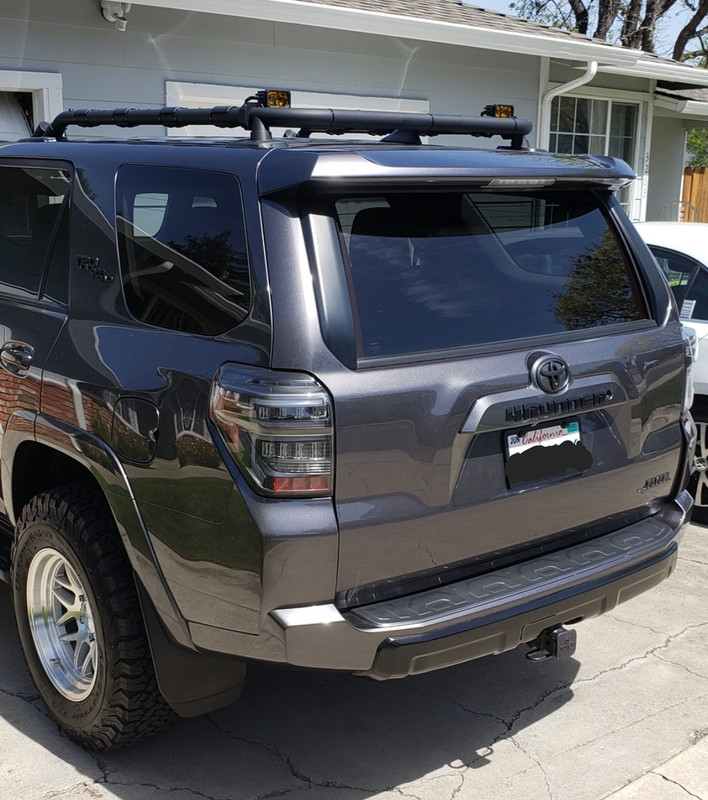

    chase lights.jpg I love my chase lights, probably my favorite part of my rooftop setup. There are 2 Baja Designs S2 Sports, wiring runs along the Prinsu rack, meets up with the XL linkable light bar, down the sides of the windshield and into the engine bay Switch Pros mount.
    Easy to do if you have a full length roof rack. If you have the Oem rack, it could certainly be done. You'll love it, I've had two buddies tell me on trips in dusty conditions that the chase lights really helped them keep distance.
    Also, have actually used them once on the street when a car became disabled in front of me to warn traffic behind. The first cop to show up was in his personal car and he actually asked me to turn on all my lights (chase and BD linkable front light bar) to strobe mode until the real lights and sirens arrived. That was pretty cool :)

    Hi there. I am a new member to the 4Runner community. I circle the black panel piece on your picture. Did your 4Runner came from the factory like that or did you black that panel out yourself? On my 4Runner, it is silver and I would like to get it to be black like on your 4Runner.

    Mine came standard with that in black, imagine it is either a part of the TRD Off Road "package", or perhaps it was an individual package. I believe there are all sorts of ways to turn those black. Black overlays perhaps, an OEM black piece from Toyota, or plast-dip is always an option. Others would certainly have more knowledge on that as I know a bunch of members have done it. I bet if you searched "black 4Runner tailgate badge" or similar on Amazon or google you would find some ideas.
