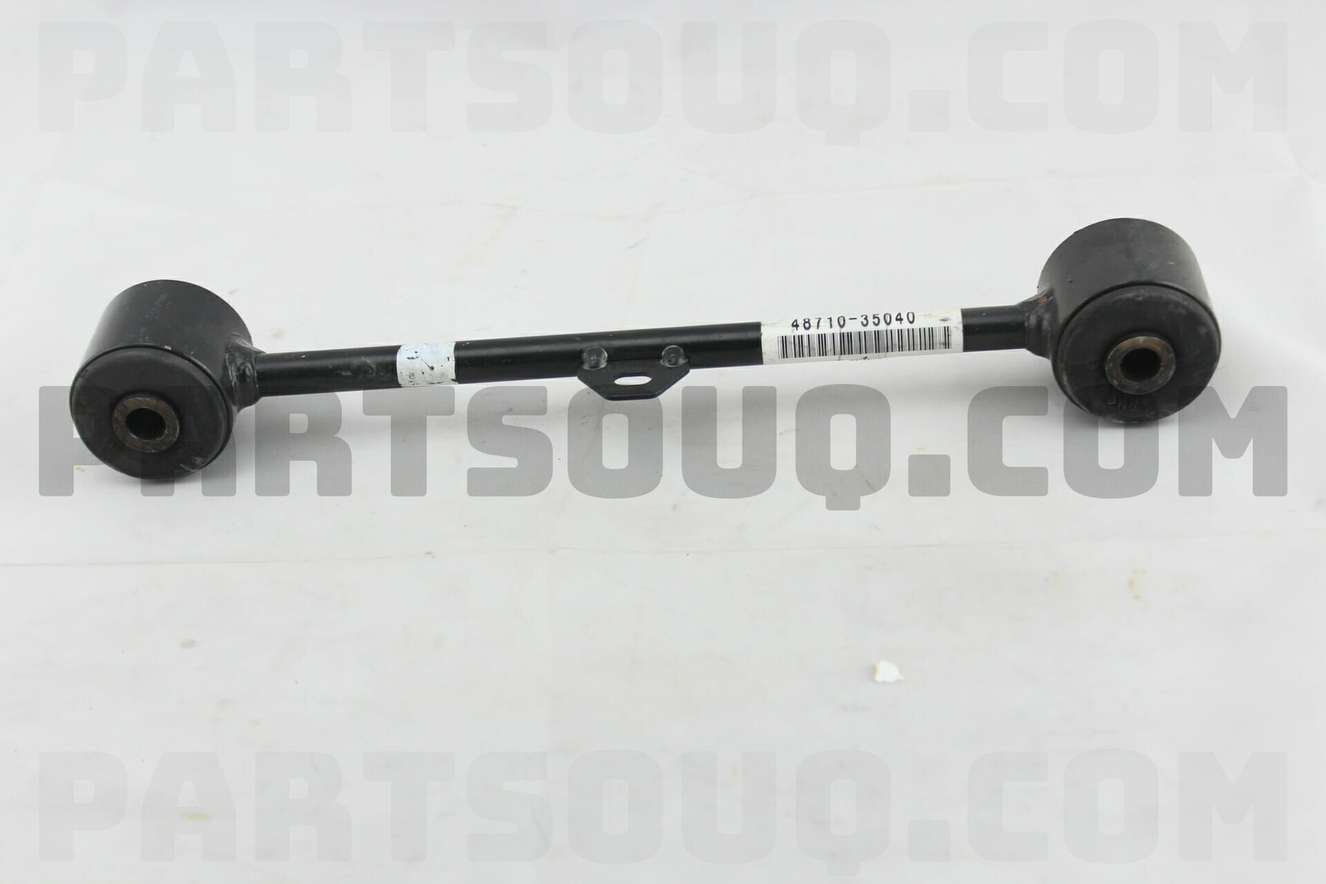

    The upper rear control arms have a good solid rubber bushing design that I really don't think is likely to go bad. https://partsouq.com/tesseract/assets/partsimages/Toyota/4871035040.jpg
    Same with the panhard bar bushings.

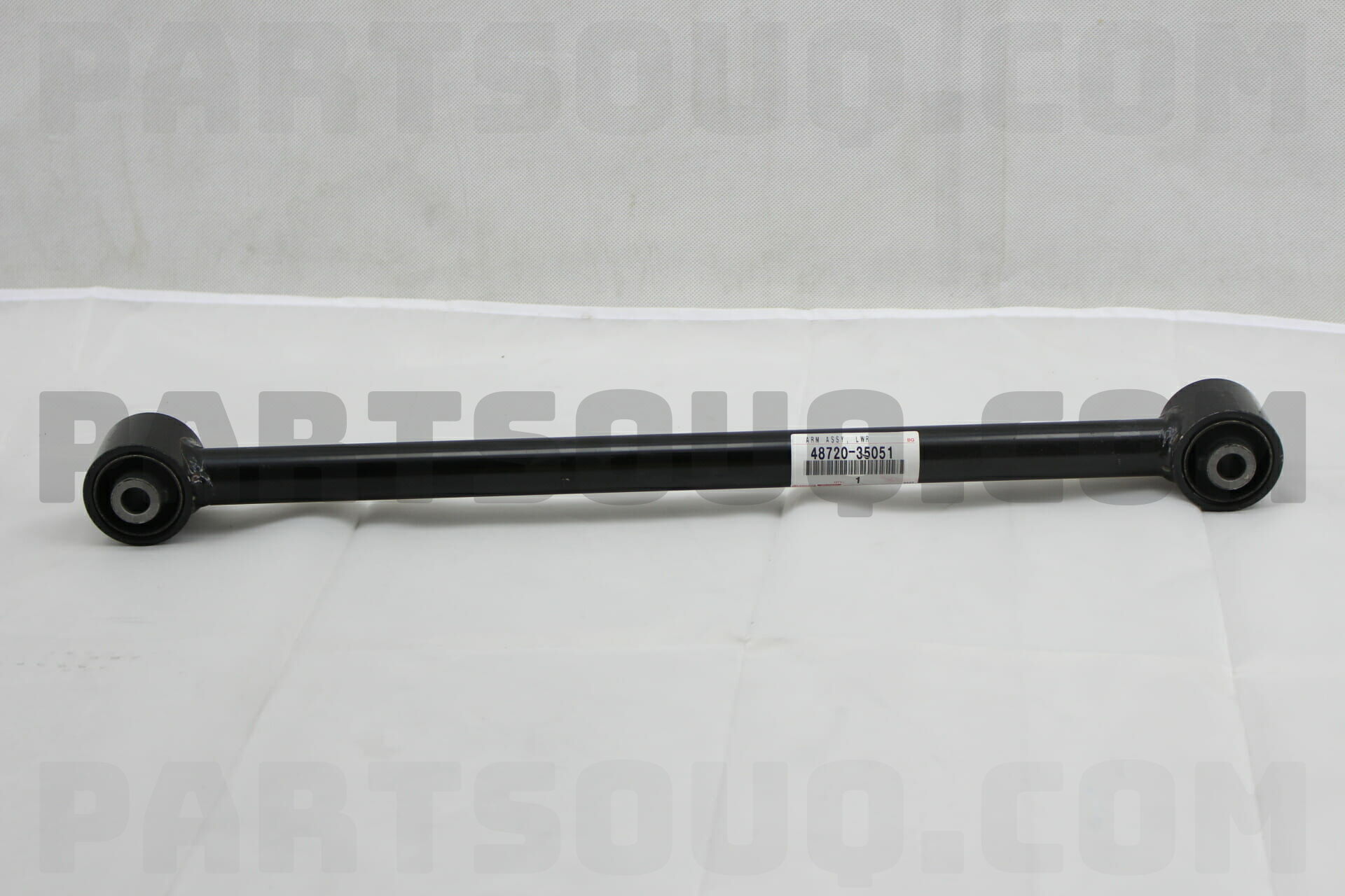

    The design of the lower control arm bushings is not solid and definitely looks like a wear item. https://partsouq.com/tesseract/assets/partsimages/Toyota/4872035051.jpg
    I think I will replace just the lower control arm bushings in the rear of the car and see how she goes. The job looks really easy and I can go back and do more later without feeling like I wasted much effort.

    So. I pulled my rear lower control arms one by one and replaced the bushings with OEM ones from TOYOTA.
    Felt no real difference around town up to 55mph. Got on the highway and it's a huge difference from 60-95mph. Before she would weeble-wobble a bit and I'd just use a light touch on her through bumps. Now that sway really seems to be gone. She felt so good driving on the highway. I don't remember her driving like this new but she must have. I just got used to her bad habits at high speed over the last 20 years.
    Some tips:
    Do NOT jack up the rig on jack stands. Leave the wheels on and the rig on the ground.
    Jack up the OPPOSITE rear corner of the vehicle frame from the side you are working. Lift the body high but do not bring the wheel off the ground. This literally removes all tension from the control arm you want to remove. No need to fight it. No need for a pry bar. No need for a ratchet strap.
    Unbolt the lower rear control arm you want to work on.
    The OEM ones need to be pressed off and on. It will laugh at your 6 ton press. Go to Harbor Freight and get their $199 20Ton shop press. Now you do the laughing. I had a 32mm impact socket that worked to press them out.
    Look at the bushings. If you are replacing them with OEM, notice how the nubbins in the rubber are LINED UP with the arm. You need to do the same before pressing in. If you go to a shop with your arms and bushings, make sure they know this.
    If using aftermarket, there is nothing to line up and they don't need to be pressed in.
    OEM ones were about $32 each from an online discount Toyota dealer. $52 each if you get them locally at retail. So ~$130 vs ~$210.
    If you just don't care how much you want to spend, you can buy the whole arm for like $165 each, I think. I priced it but forgot. Then the job is ridiculously easy.
