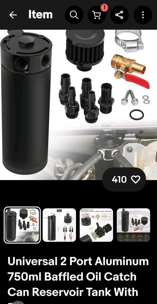

    I’ve heard this term before, but I’ve never understood it. Would you mind explaining who would want a catch can and why?

    Well, quickly it filters gunk from your crankcase before it’s fed back to your intake. (Through the PCV). Do some You Tube browsing on the topic. The can will have the most disgusting crap in it to dump out every 1000 miles or so, more often in the cold months.

    I dont think a catch can is needed:jellydance: in this application. Some of the Tacoma guys have it but no major gains really. Just another thing to watch/install/clean etc.

    Yes there's usually a mesh or steel wool that lets the oil come out of suspension and fall into the can.

    1,729
    Back in the day, we would use a water/oil catch for a shop air compressor and some hose. $170.00 is kind of crazy.
