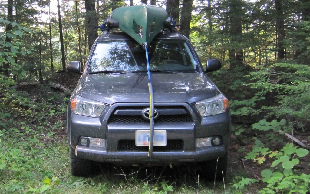

    I've carried kayaks and canoes on various vehicles for years. It might seem like the additional front and rear straps are unnecessary, but they keep the canoe/kayak stable and centered. If the other straps loosen or break or if the rack shifts, then the front and rear straps keep the boats on the roof. They also take some of the wind-load off the rack. If you strap solely to the rack with no front and rear tie-downs, all the wind lift on the boat is pulling entirely on the rack. With the additional front and rear tie-downs you're strapping the rack to the roof.
    They also provide an easy way of keeping check of the boats ... If those front straps loosen up or go a little floppy while driving, you need to check the other straps. I had an 18-wheeler blow by me on the highway and it shifted my 16ft canoe about 6 inches hard right. The front strap kept the boat in place until I could pull over and replace the busted left-to-right strap over the top front of the canoe.

    Same here, works fine for me. For a canoe I use additional strap I hook up for recovery points under front bumper to keep rope centered:
