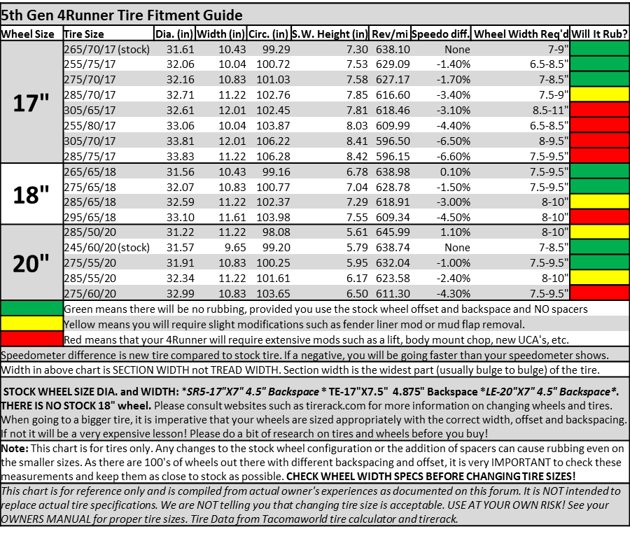

    Hello everyone,
    Just wondering if anyone knows whether I will have any rubbing issues, if I go with a 31.5" tire and 0 offset, vs the +30mm offset of factory Gen 4 wheels with no lift.
    About to pull the trigger on a purchase but trying to avoid surprises.
    Thanks for any input

    Check out the attached doc I saved from one of the other discussions regarding tire fitment.

    Thanks for the chart, I wish it took different offset into account, looks like with keeping stock offset everything is good, I expect Im in the yellow going from 30 offset to 0.
