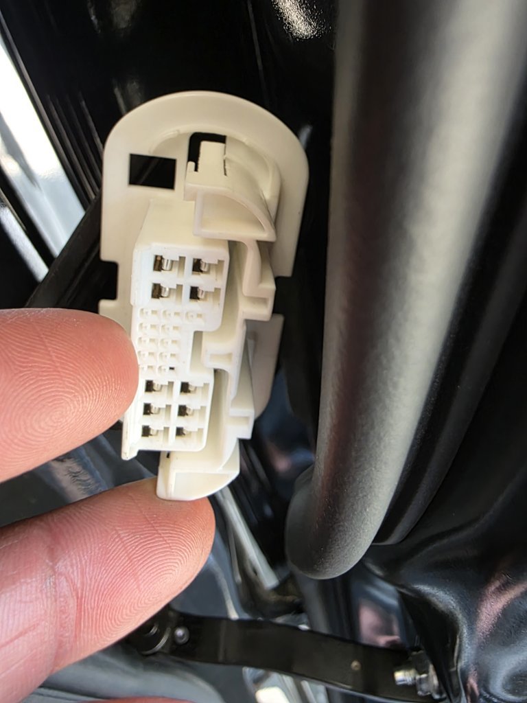

    Hello all,

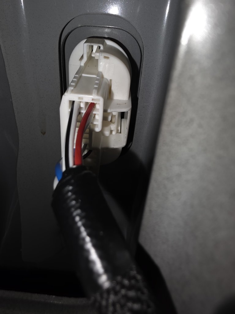

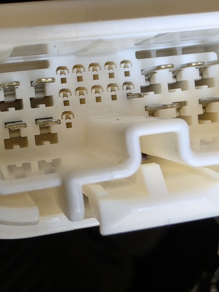

    Running 14ga speaker wire in my 2024 TRD ORP non JBL. The rear doors have a molex plug connector blocking the door boot. I plan to VERY CAREFULLY DRILL OUT the area without pins in the center to feed the wire through the door boot (near my index finger).
    Has anyone tried this? Is there another way to run speaker wire? I don't want to drill out the plug in my truck if I don't have to.

    Seems you might void warranty?
    Amazon has lots of small round rubber gaskets to press into holes in sheet metal. Also small hole saws to match. Cut a hole nearby metal, debur hole press in rubber gasket. Razor blade a small slot in gasket and feed your wire thru.

    That connector has plenty of open slots available for you to use. Why not get some pins (male and female) and add your wires to the existing connector? How many leads to you need to have pass through there? I see ten open spots.

  7. Aug 22, 2025 at 11:13 AM
    3,169
    22 ORP
    I had that thought too and then I reread the original post. 14 gauge. Tiny pins. Hmm.

    Why not use an adapter harness and use the factory wiring?

    I used that stock plug. Found the stock speaker wires and just crimped my 14ga into the speaker wires coming out of that plug. Works great.
    Now. Maybe thats not idea because the size of wire drops briefly down to what ever the factors is. And like you I used 14ga......but the rear speakers arent supposed to give you your good sound anyway and its. It's a very short run with the stock wiring through that plug resistance so its fine.

    After a quick search, “14awg vs 16awg resistance at 10 meters” the difference is about 0.05 ohms higher at 10 meters, but you would still have all the Toyota reliability with the wiring installation. If you run new 14awg wire, and get one connection less than perfect you’ll end up with higher resistance than the factory 16awg. Additionally, you’d be surprised how seldom your amplifier actually puts out its rated power at loud listening level, except for subwoofer frequencies where the current output can be pretty high. For subs I run 12awg, but I’ve never installed anything above 800w on the sub.
    I picked 10 meters because that’s plenty long to cover the factory wiring circuit out and back anywhere in the car
    I’d just use the factory wiring with a good adapter harness.

    I managed to snake the 14awg through the door boot without drilling holes.
