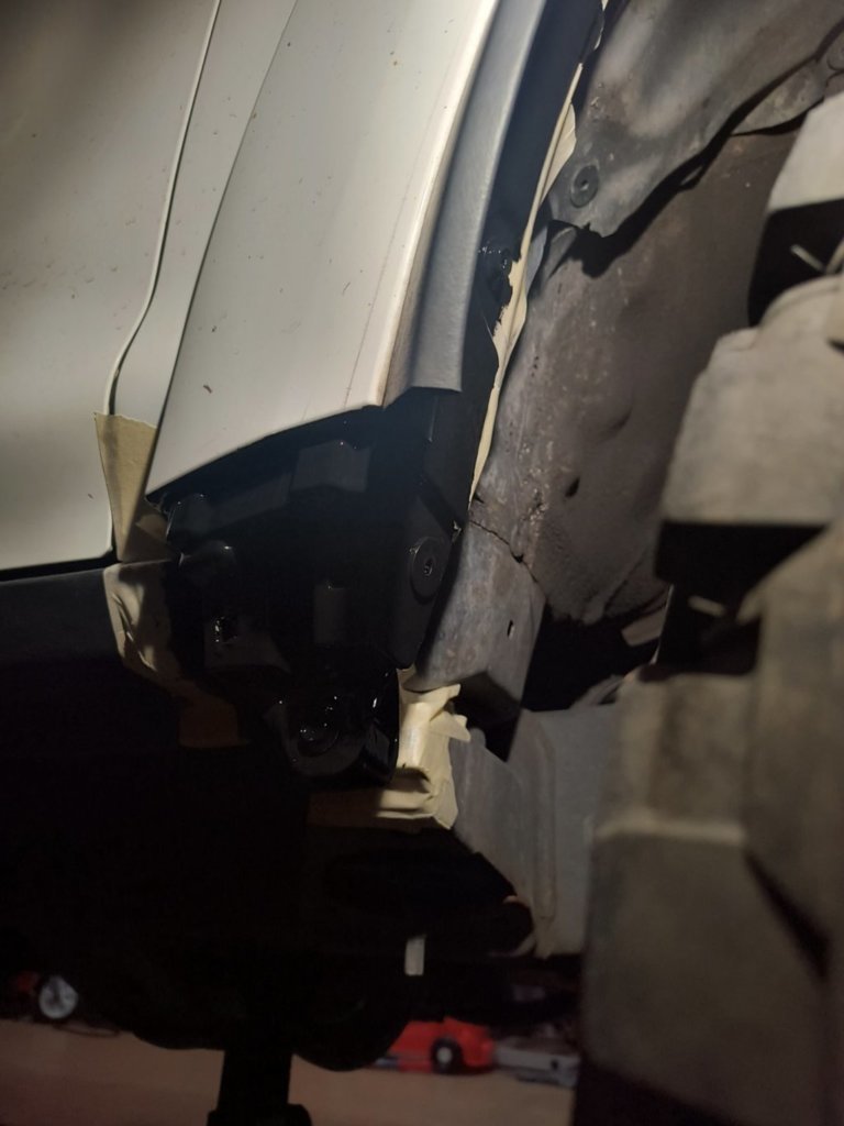

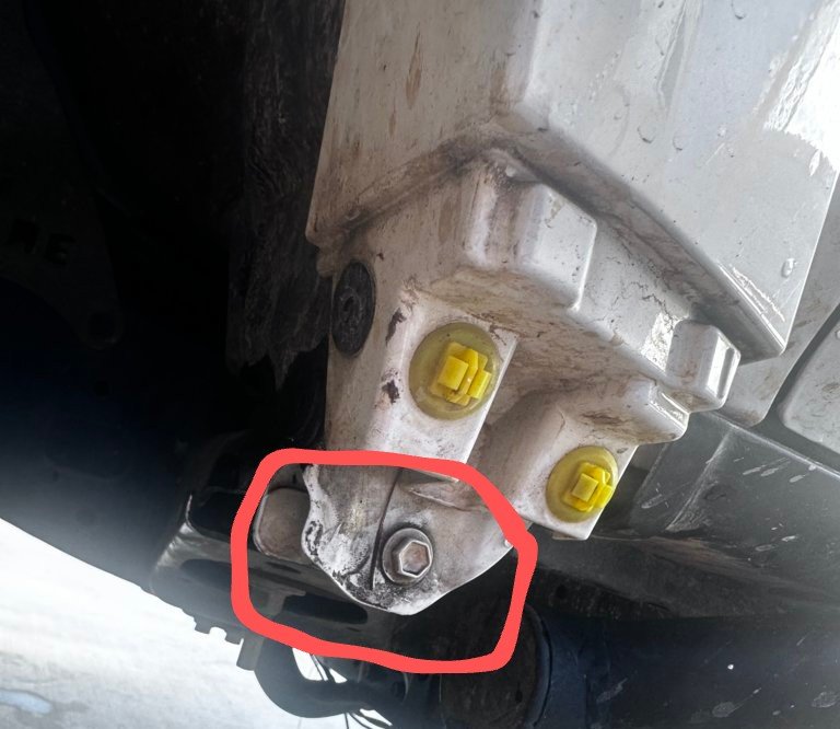

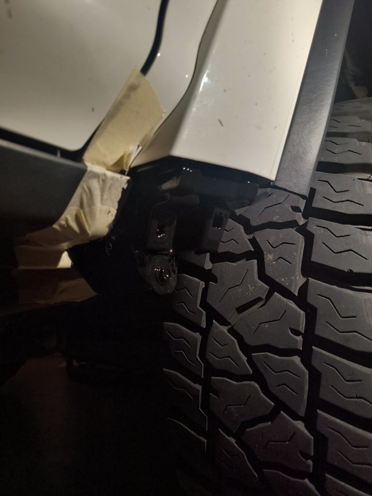

    I have a tire rubbing issue and it caused a small puncture in my tire but thankfully no air out of it. Im specifically talking about the white piece that sticks out at the bottom

    Shit so I can just pound the metal piece down? Basically trim it?
  4. Aug 12, 2025 at 7:52 AM
    3,421
    That bolt holds your outer fender to the inner fender structure. You can remove the bolt and see how much the fender flops. I suspect it will move half an inch easily because the fender is wafer-thin. So cutting off the piece completely wouldn't work unless you come up with an alternate way to secure the fender.
    You can trim the front portion of the flange all the way to the bolt though, to give you a bit extra tire clearance.

    Alright, if I can trim as much as I can to the bolt it would solve all my problems

    I really only need just a small amount cut off

    I wouldn't trim it, you should be able to bend it in, either with pliers or a hammer.

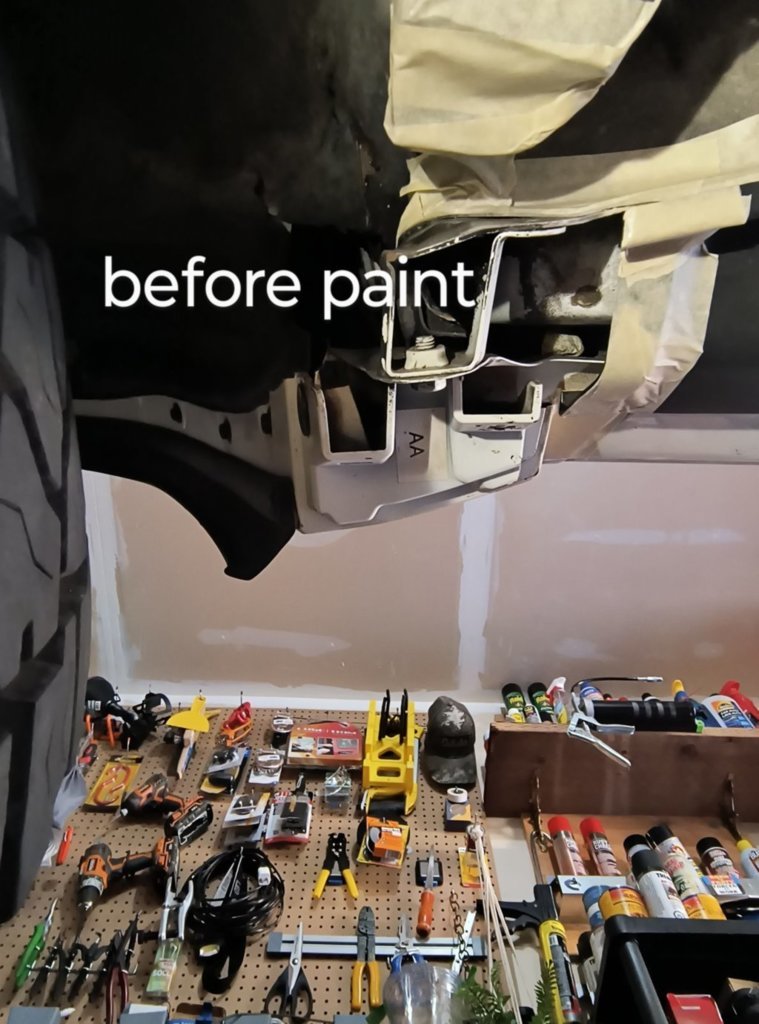

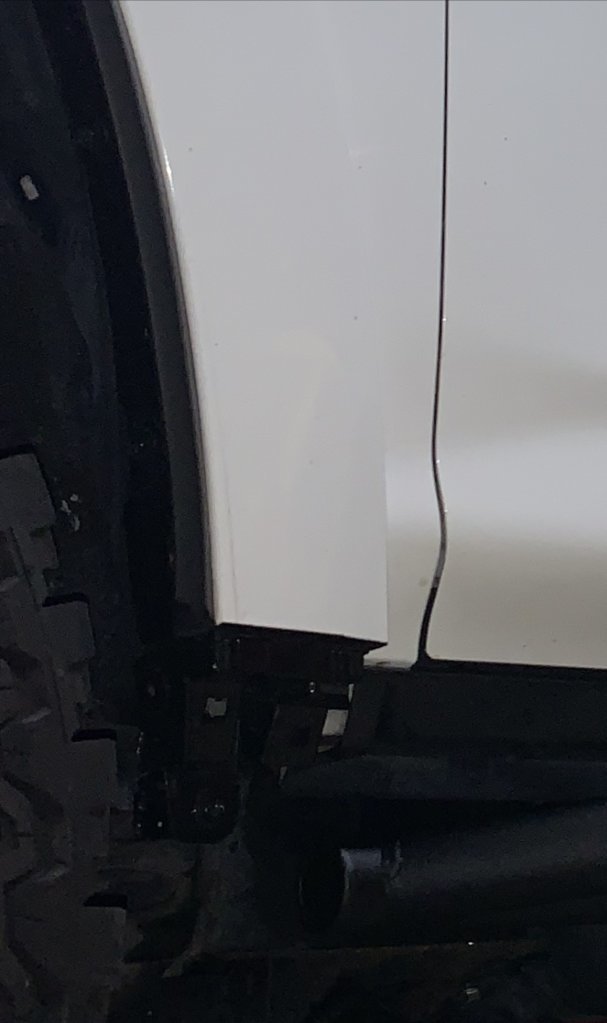

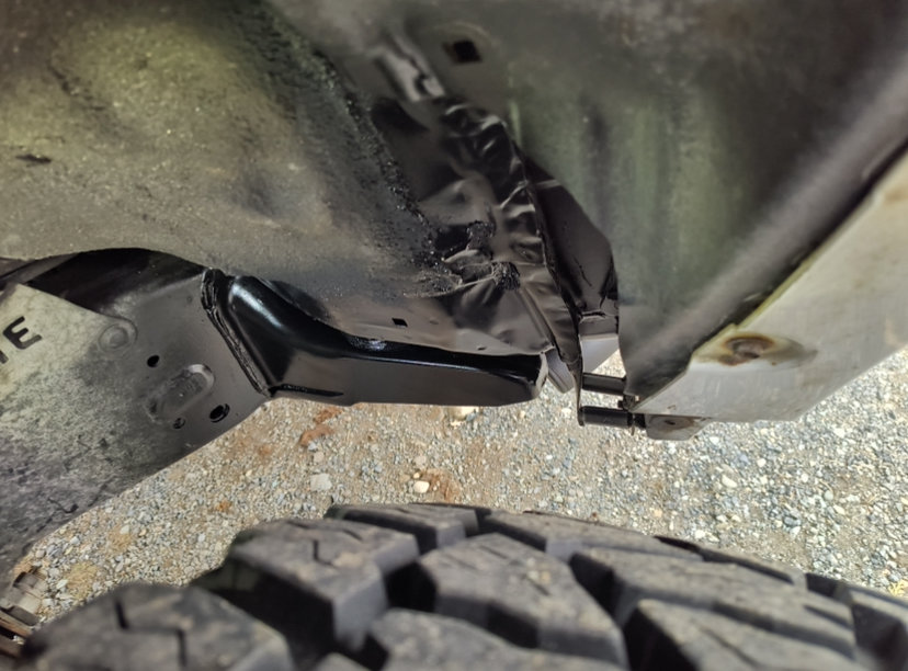

    @3JOH22A is correct that’s your fender mount don’t buck it off.
    @Hashkaash
    I have done this mod already on both sides:
    -trimmed valance caps
    -had my guy chop off and and weld together the fender mount flanges, for tire scrub clearance.
    -then ended up removing caps (permanently) and sanded and painted the exposed fender mount
    *Fender mount flange bending or chopping is a very common mod that commonly goes in hand with a body mount chop.
    Like @Imdav2u said, start with hammering and bending, and perhaps trim ur valance cap and reinstall it. I removed the cap and those yellow toyota plugs
    *edit: reference photos

    Ill definitely look into it. Its manageable for now until I can find a person to fab for me. When im full turn it rubs so obviously if im on rocks it hurts or if im trying to park @djwantke

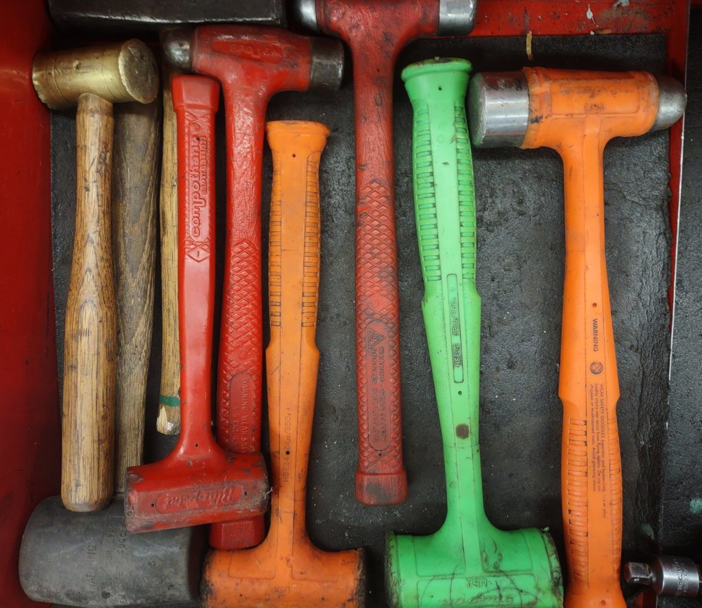

    use your BFH and whack away!

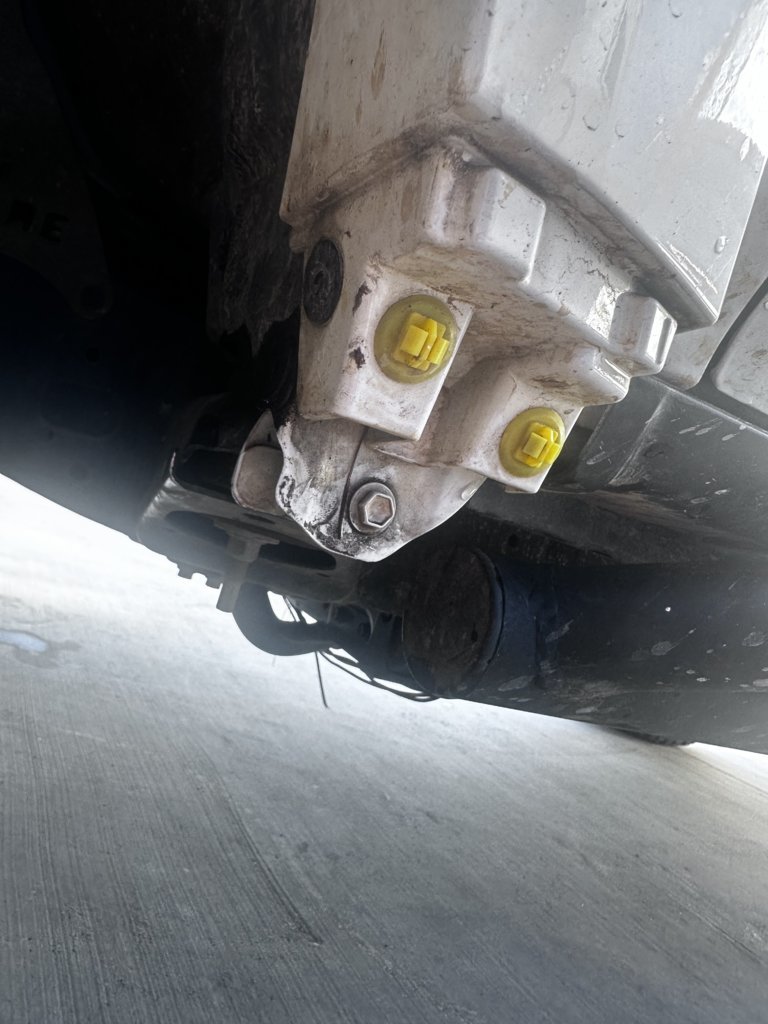

    what are those wires dangling under the middle

    Well I decided it was an amazing idea to throw some light bars under before I started modding my 4runner. Long story short lets just say I dont have them anymore

    Your sure ur not rubbing body mounts too a little bit under compression.

    Either way, the body lift won’t change how you’re rubbing the body mounts, may still even contact fender mount flanges :)

    Understood, ya no you’ll be fine, these things are a common chop, or there’s even weld on body mount relocation kits. But, I remember I was originally not interested in chopping my 60k truck
