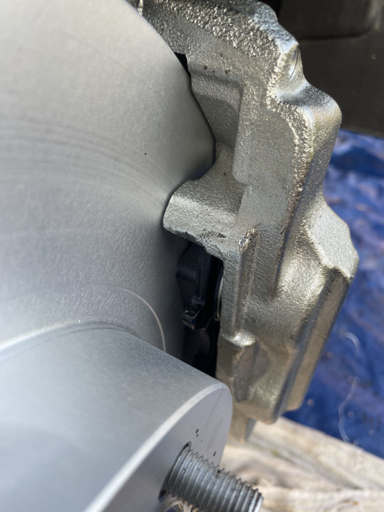

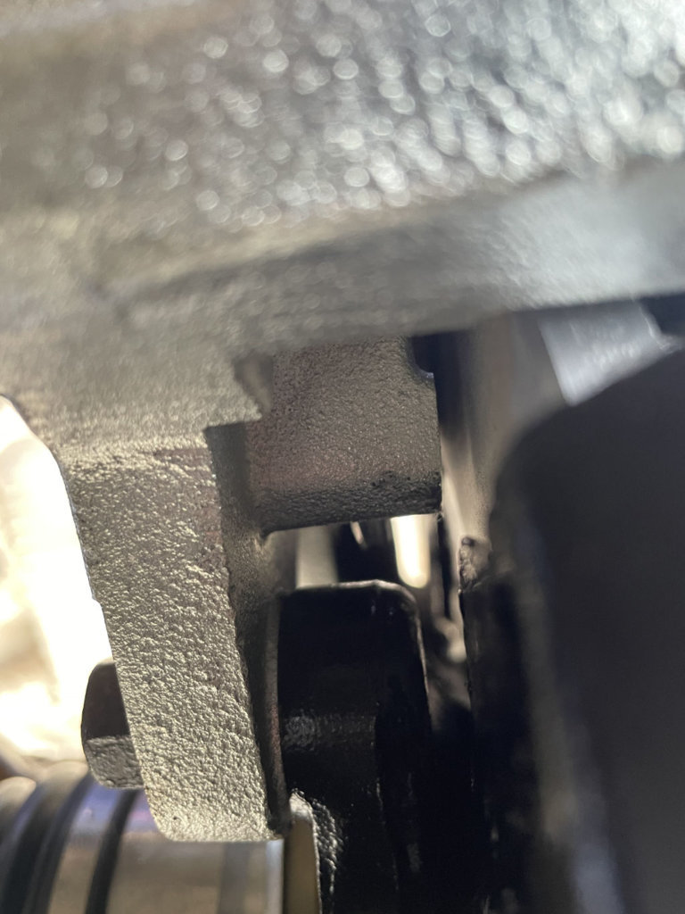

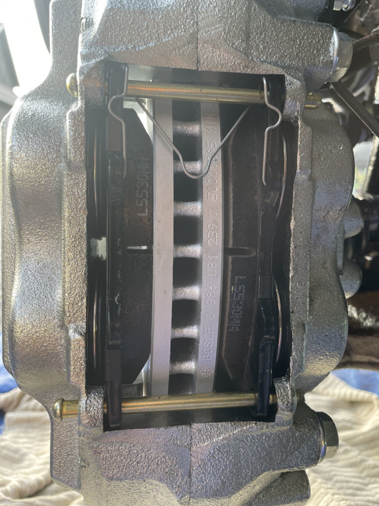

    I've recently rebuilt a lot of the front suspension and brake system including new shocks, upper lower ball joints, tie rod ends, sway bar links, hubs, knuckles, rotors and brakes. After getting it all back together the rotor and caliper are not centered.
    This has been driving me crazy. I measured all the parts and they seem to be in spec. It seems only the knuckle, hub or rotor could be causing this. The rotor sits to the outside too far and the outer brake barley squeezes into place. The caliper is about a card's thickness away from the rotor on the outside.
    It's a limited 4runner with 18" wheels (13WH calipers). Has anyone run into this before? Any suggestions on what could be causing this? Any suggestions would be appreciated.

    I just had a thought. I'm new to the Toyota world. Could it be that the rotor isn't designed to be centered on the caliper? I didn't take pictures before I started the job, but maybe it was like that before. Doesn't make sense to me, but maybe. Any 2008 4runners who can clarify if this is indeed a problem that the calipers are not centered with the rotor ? - See pict above

  21. Aug 19, 2025 at 11:09 AM
    3,379
    ^Is the rotor rubbing against the caliper? If not, then there should be no harm in leaving it as-is. When you apply the brakes the first time, the four pistons equalize against the rotor surface and stay there.
  22. Aug 19, 2025 at 11:52 AM
    2KEightRunner
    2KEightRunner [OP] New Member
    Yesterday
    #48575
    12
    Ryan
    Thanks 3JOH22A. The caliper is not rubbing but the brake pad is slightly. Perhaps it's my OCD that says it "should be" centered or close. Anyone else agree that this is okay?
