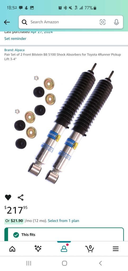

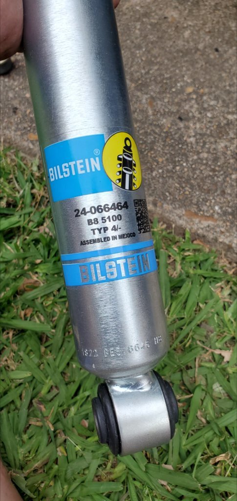

    Got the bilsteins off Amazon.... sent the screen shot of it. Running a 3 inch lift

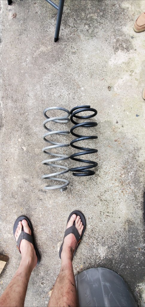

    Honestly these are the best shocks I have ever experienced... firm yet smooth on and off road.
    I went with 3 inch lift ARB springs in the rear. I had a 4 inch rough country... but it had way too much body roll for my liking
