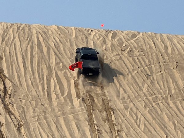

  9. Aug 20, 2024 at 3:05 PM
    2,872
    You must have never driven on sand dunes or in waist-deep snow.

    @3JOH22A Sure have. There is a reason why they call lockers low-side finders. They ruin lateral stability off road/off camber.

  13. Aug 20, 2024 at 4:01 PM
    2,872
    This happens any time you're relying on wheelspin to move forward. The only difference is you're more likely to bog without the locker. Just need to pick your lines and be mindful of your surroundings.

  15. Aug 20, 2024 at 4:09 PM
    2,872
    ^I speak from experience :notsure:

    I air down, switch to 4Lo, turn A-Trac on, and go. Haven't had any issues, and haven't gotten stuck even a single time all these months in a variety of terrains. Lockers are better, no doubt, but A-Trac is cooler. I have two lockers, don't use them and don't miss them. Use them once in a while not to lose them.

    Soon I will create a situation where the two rear wheels lose traction, one wheel in the air and one wheel in mud. With rear locker only you are toast. That's when A-Trac will lock the front wheels and get you out. In one of the above videos you can see the front locker alone is totally useless because a rear wheel also lost traction. A-Trac acted as two lockers and the truck walked right up.
