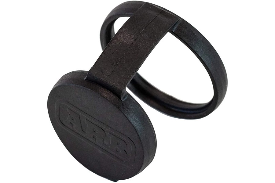

    Arb dual compressor Did come with a rocker but it was too large to fit direct spare slot for my 4runner 5th Gen. I got a CH4X4 Small Push Switch for Toyota -Air Compressor Symbol 3 - Blue LED off Amazon for direct fit. yeah had to add key and tether that do not come with kit. Hose and air give are also separate! As for bracket fitting other side could work but as it sits would interfere with air filter box need custom cut!
