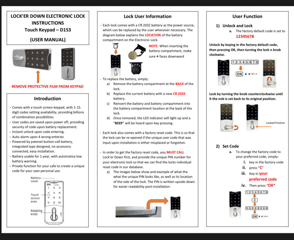

    Looking for anyone with Lockerdown console safe with upgraded electric lock. Selling my ‘23 and have lost instructions (they went out of business)
    Need a photo of instructions to change combo before turning into Toyota store.

    Is the rearmost column 0, C, OK? When do you press the c?

    According to that picture you must call Lockerdown to do a factory reset.
    Edit: I just re-read the OP's original statement saying they went out of business. Since you're selling the safe why not just give the person the current code and be done with it? What are the odd's you'll see them again.

    Would you guess you put in your present code and r the 12345678 code then hit the “C”?
    May be better to trade in with my code and let new people or store change?
    But you may know from experience.

    That's a good idea. Put in your current code (if it differs from 12345678) then hit C. If it lets you reset it, put it back to 12345678 and let the dealer know.

    Just tried this on my lock. Success in changing code!
    current code
    C
    <single beep>
    New code
    Ok
    <longer beep>
    Try new code.
