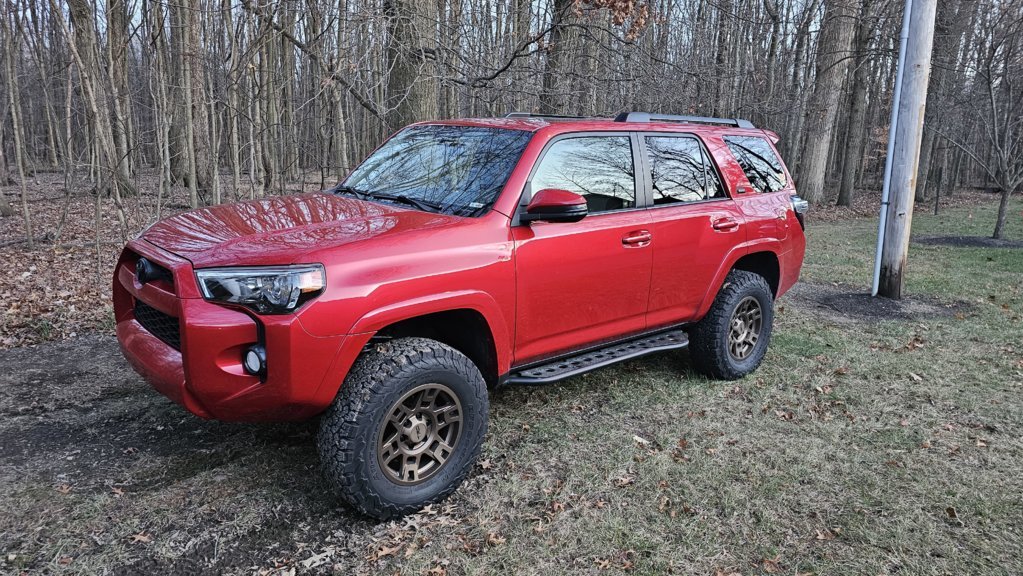

    TRD PRO Bronze Wheels, 275/70R17 KO2's, Bilstein 5100s all around with front set at 0.85, stock rear springs
    I am running 275/70R17 KO2s on an Eibach Stage 2 lift w/coilovers, Borne 1.25" wheel spacers, 1/4" Cornfed spring spacer on the driver rear to eliminate the Toyota lean and I get just a hint of rub on the passenger body mount at full lock along with a very minor trim on the front bottom corners of the fender. Hardly noticeable and looks great....but man these KO2s have gotten loud..... LOL

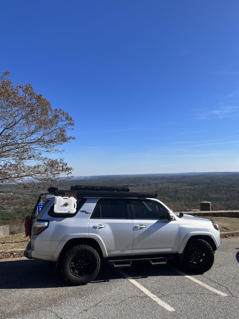

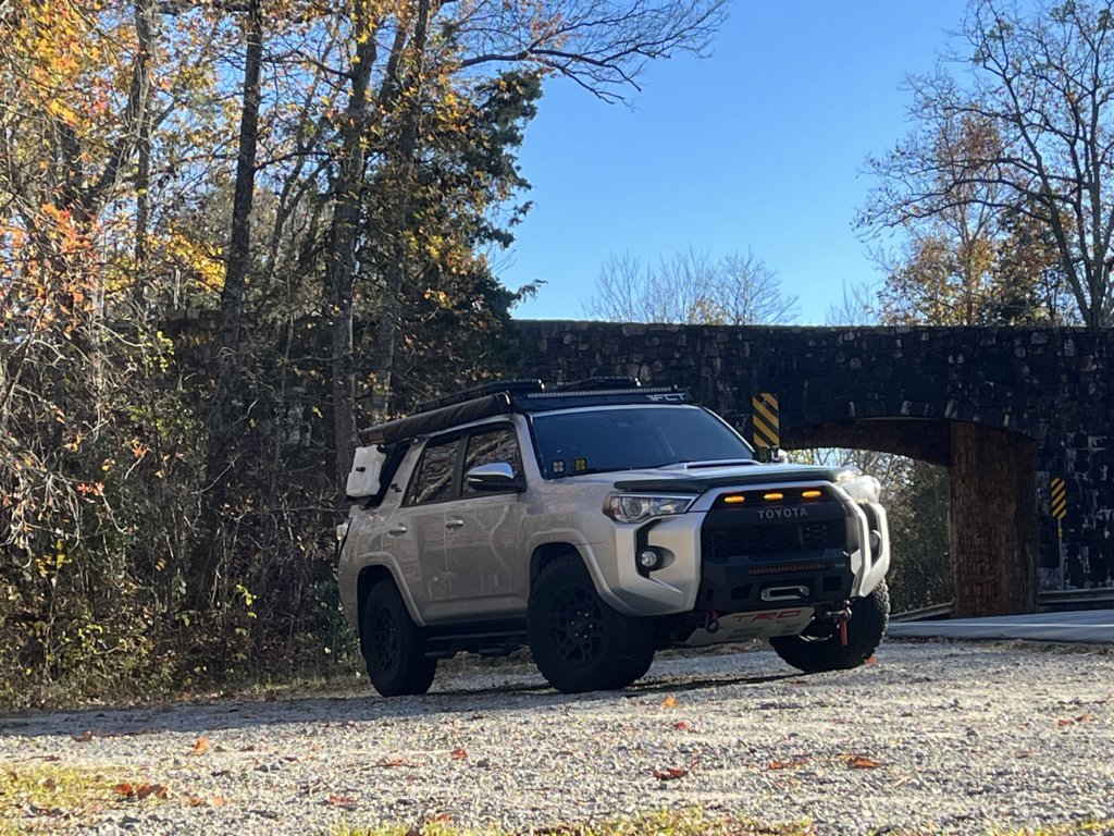

    18 ORP. Stock suspension. TRD wheels with 275/70 17 KO2s.
    Like others have said, I only get a rub in reverse when full lock on passenger side.
    Have approximately 25k miles on them.
