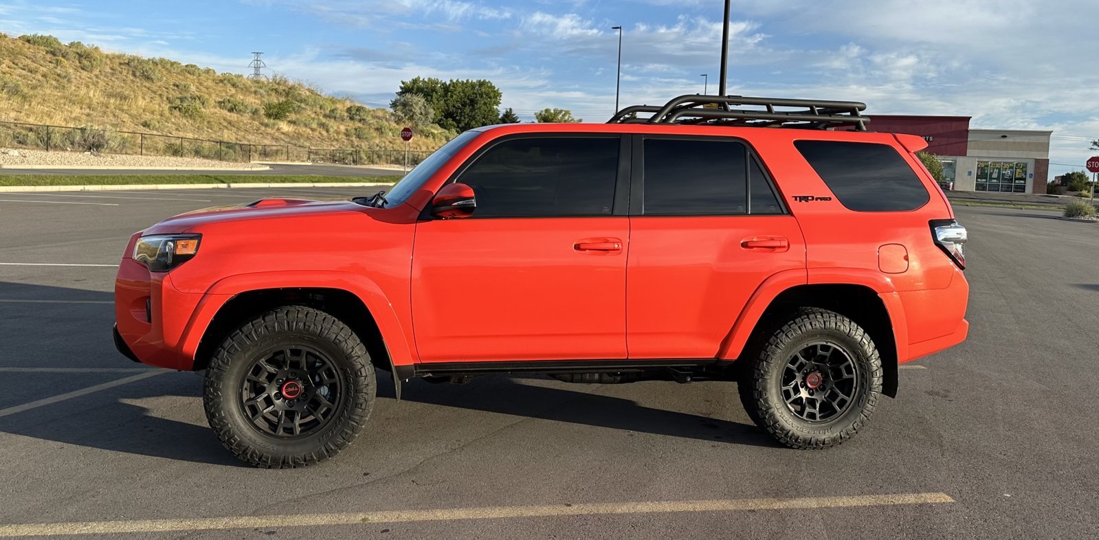

    Funny how they say no longer available. My 23 came with the old style and my dealer had the new style wheels in stock (12 of them) so I bought them because I like the new style better. Oh, and mine came with those colored lines on the lug nuts too (first pic.).
