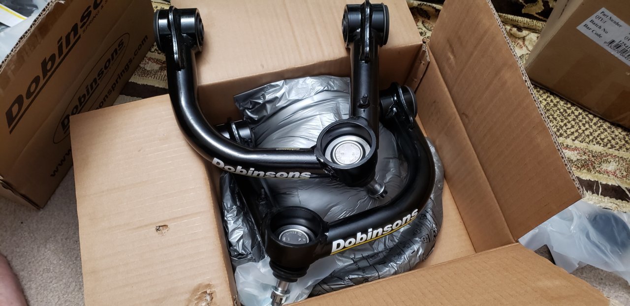

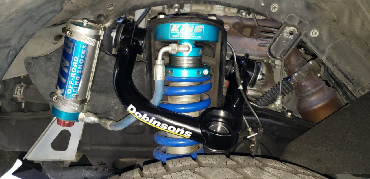

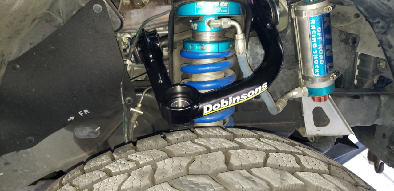

    I had Total Chaos, JBA, and Dobinson UCAs, Dobinson is my favorite. The least amount of maintenance out of the 3 brands. Still uses ball joint like factory, gusseted, 3+ degrees of positive castor built in, and rubber bushings like factory. It comes with a cover for the ball joint BTW I just didn't install until after the picture was taken.
    nimby, doublewide and Thatbassguy like this.

    These look very similar to my BDS UCA's. It doesn't appear that your ball joints have grease fittings, though.
    Doglover2003[QUOTED] likes this.
