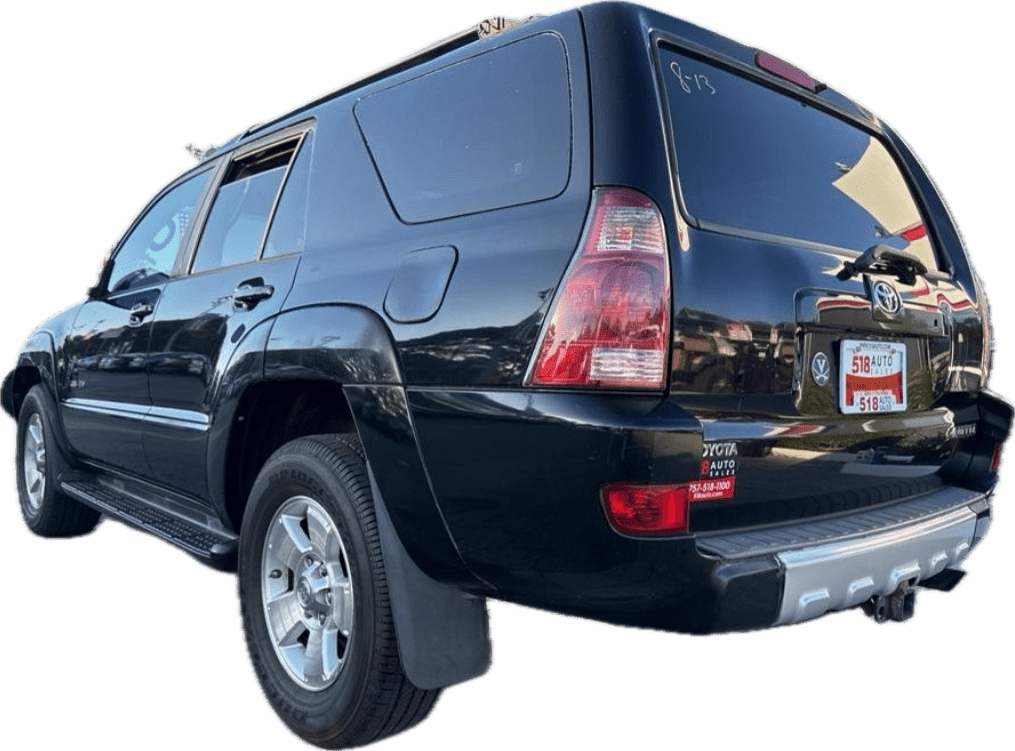

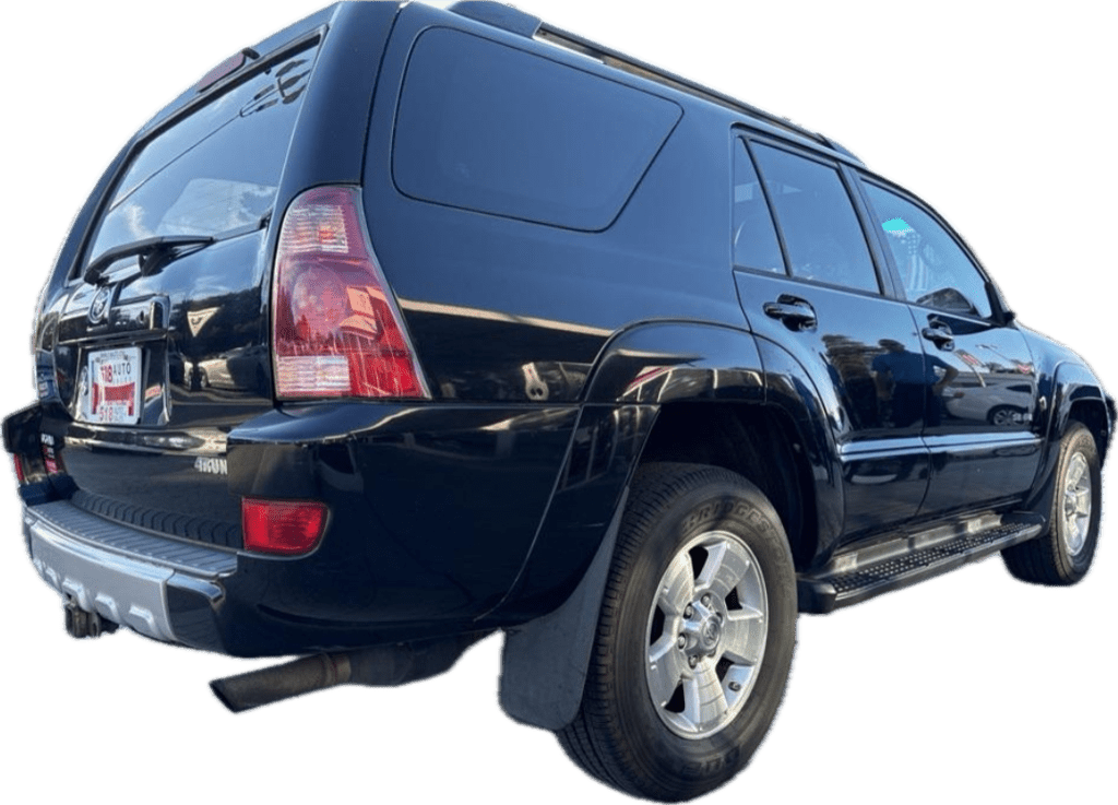

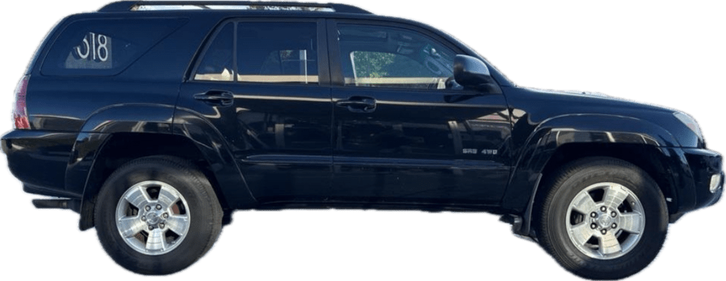

    I’m looking at a 2004 SR5, V6 4.0L with 200,000 miles. The carfax shows 45 service entries - lots of stuff like ac compressor replaced, along with standard maintenance. No rust. No accidents. They’re asking $7500. It felt great on the test drive - good pep, smooth acceleration and braking. Just looking for some pro advice. Thanks!

    First off, we ain't pro's. We're just keyboard warriors on a web forum who claim to have tons of knowledge. Post pictures of the vehicle if you can so we can check it out. But in the end........go with your gut. If the service records check out, the frame is pretty much rust free (all frames will have some rust) and the price is right.....go for it.

  7. Aug 26, 2025 at 4:28 AM
    5,148
    Doesn't seem like a horrible deal depending on where you're located. Don't see any rust bubbles or anything. But old isn't like buying new. Things get un covered on the way home.
