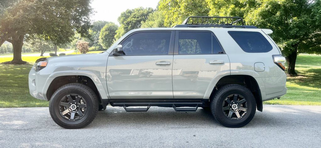

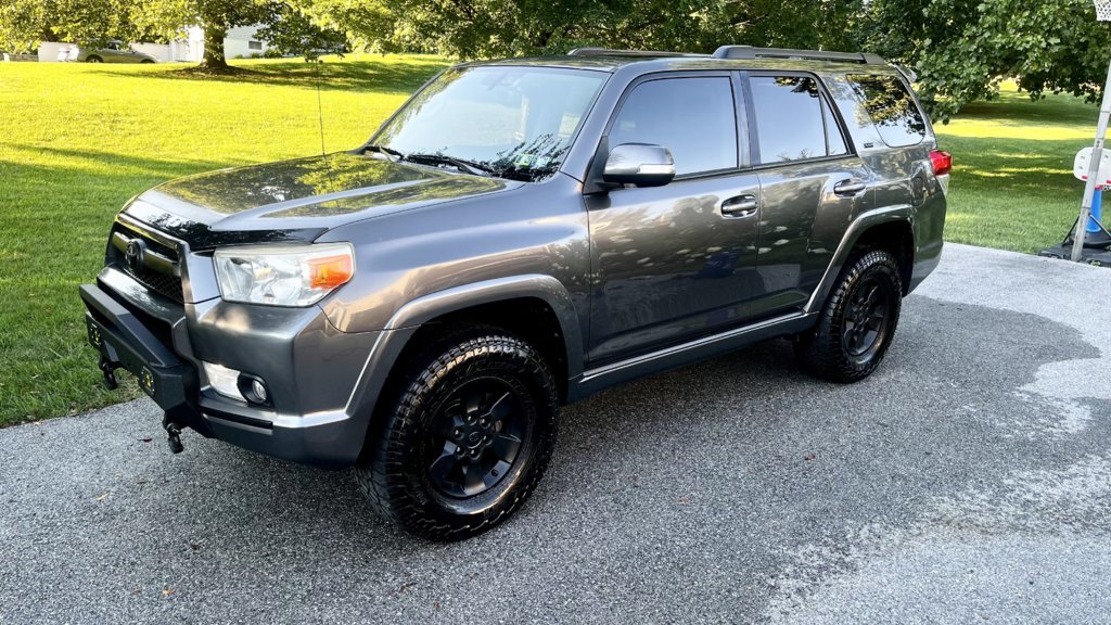

    i have 2” lift and no spacers on my 2022 running 285/70/17 with all mudflaps in place and no rubbing.
    same set up on my 2011 SR5 and no rubbing.
    spacer may induce more rubbing

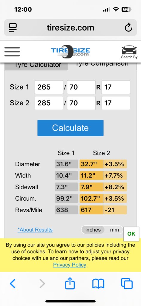

    I guess I thought I needed 285's to fill the space from the lift I put on it. I assumed they would be taller than the 265's that came stock?

    they are taller and wider

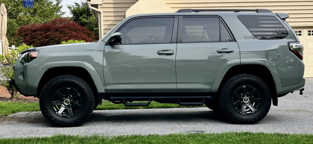

    Same lift, 265s top vs 285s bottom
    icebear, Kat5280[OP] and Thatbassguy like this.

    For looking tough, the General Grabber ATx is a great tire, looks awesome, rides awesome, does excellent in heat and rain, snow and ice, dont have to be rebalanced all the time and lasts forever. I can tell you, these tires with the tread pattern running to the edge of the carcas, and side biters look MUCH tougher and WIDER than the same size BFG. My friend has the same size tires i do, he has the BFG AT and i have the General Grabber ATX, both the same size and mine look WAY wider than his and WAY tougher than his.
    The General Grabber ATX comes in a 265/70-17 = 31.6
    The General Grabber ATX comes in a 275/70-17 = 32.2
    The General Grabber ATX comes in a 285/70-17 = 32.7

    Good shot of both sizes!! Since I ran in the past with my 4runner Pro and SCS wheels because of the more aggressive offset on the SCS wheel you get a better fit and look if you do run the 265’s even if you are lifted a little.

    No, you don't "need" them. But, they definitely look better than stock size on a lifted 4Runner.
    Yes, they're a little taller and wider than stock, as shown in the post from @TrailSpecial22

    Thanks for the comparison... That helps!.
