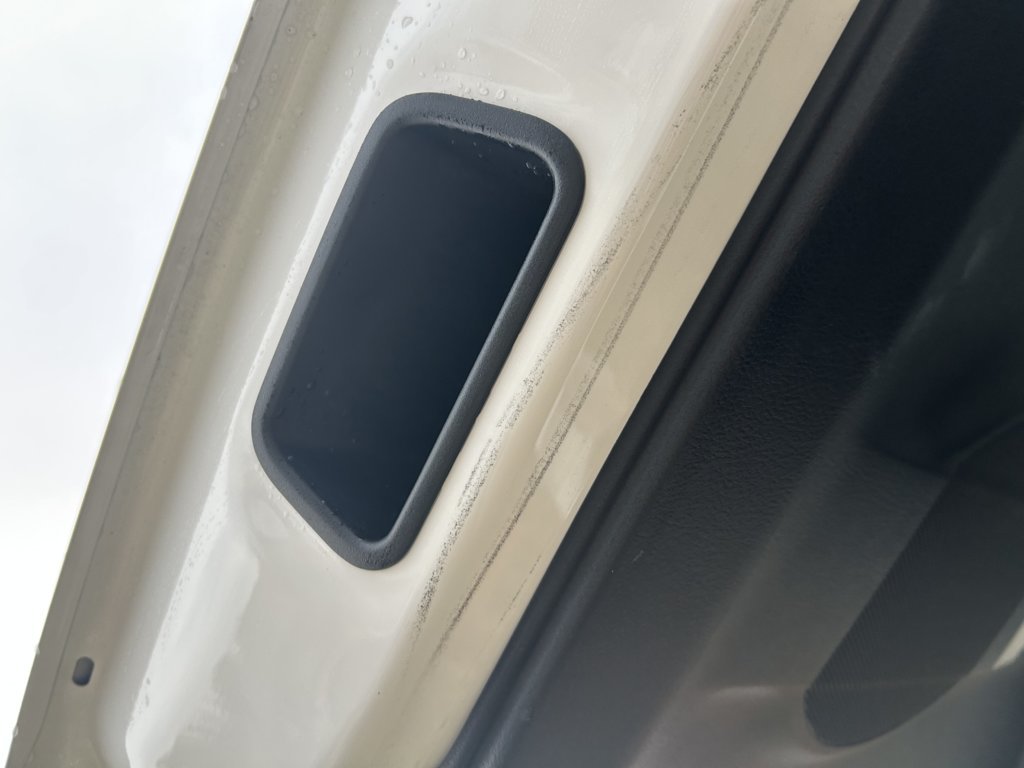

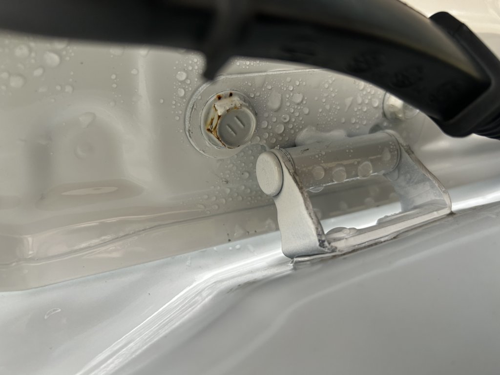

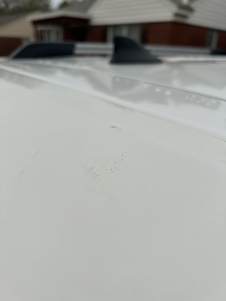

    I just drove home a "brand new" 4Runner from TN to OK. Vehicle has 150 miles on it when I picked it up and drove home with no issues. I noticed the tow hitch was bent the other day and decided to have the dealer look at it to inspect the frame and make sure there was no damage. Referred me to their body shop but I can't make it in until mid December. Anyways, I decided to clean it and noticed quite a few nicks on the top of the hatch as a well as some sketchy paint over some of the bolts. I'm starting to think that this vehicle was in a rear end collision and it was not reported (CARFAX and Dealer stated there were no issues). Does anyone have any thoughts on what my next steps would be in this situation in order for the dealership to make it right? Or that matter have any input on if my assessment is accurate? I'll go over all this with the collision center and see if they can find any more evidence. I'm willing to move on from this if everything is mechanically sound including the frame. However, I can't help but feel I got screwed over on this and I'm paying more than I should for a vehicle that was Frankenstein'd in the rear. Any thoughts on how to you would proceed would be appreciated.

    to me that doesn't look right for a brand new vehicle....

    That should not be there in a brand new vehicle. It has been touched up.

    Like I said in the other post that you created, a rental vehicle doesn’t leave the fleet with only 150 miles on it. Something is going to be wrong and these are all indications.
    As far as recourse, you’re in it for the long haul now. Once you take delivery, it becomes your problem with the exception of warranty items.

    Thats DEFINITELY not OEM paint on the lower half of that hinge and from the looks of the tint of the paint on the hinge and inner door frame that makes me think the whole rear has been painted minus the door.
    The paint marker on the corner of the window is most likely a salvage yard marking, they do that on all sorts of auctioned and salvaged stuff.

    There is certainly damage to the rear x-member to have caused the indirect damage to the rear gate and hinge alignment. You just don't see it with bumper cover still on.
