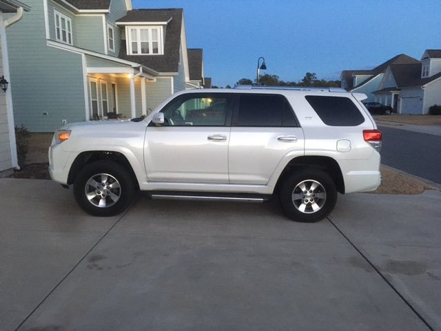

Added 2” lift
Discussion in '5th Gen 4Runners (2010-2024)' started by Sandman58, Jan 12, 2022.
  1. Jan 12, 2022 at 3:04 PM
    Sandman58
    Sandman58 [OP] New Member
    Nov 23, 2021
    #24344
    11
    Dave
    13 4Runner
    None yet
    Any tire and wheel suggestions?

    What an open ended question this is.
    • What kinda driving do you do?
    • Where are you located?
    • Do you off-road?
    • What size are you looking to go?
    • What manufacturer do you prefer?
    The list goes on…
    I would get 315/70/17 Nitto Trail Grapplers.
    btw… nice lift. Looking forward to seeing more pics. What kinda lift did you get?

    Rough country leveling kit.
    Just quick trips on the beach and regular around town driving. No crazy off-road stuff. I don’t have any manufacturer preference. Not sinking in sugar sand is my priority. I don’t think that size is fitting without modification?

    Okay you are going to want something that floats then. I would go with either 295/70/17 or 285/75/17 if you are okay with clearing a couple body parts out of the way.
    I know Matt from Matt’s off-road recovery deals with marble sand. He has Milestar Patagonia M/T radial tires if that helps. If he can get through that crazy soft sand you should have no problem. However. I would recommend some recovery boards for safety and an air compressor to deflate the tires.
    Oh and I would look at different wheels that allow you to bring the air down quite a bit. I believe Method has a wheel with beadlock technology that is DOT approved. It isn’t actual beadlock but they do hold onto the tire darn good compared to stock tires. The wider your tire you will need to be careful to get wheels that will fit the width.

    I’ll check those out, thanks. I think the 285/75/17 is what I’m leaning towards.
