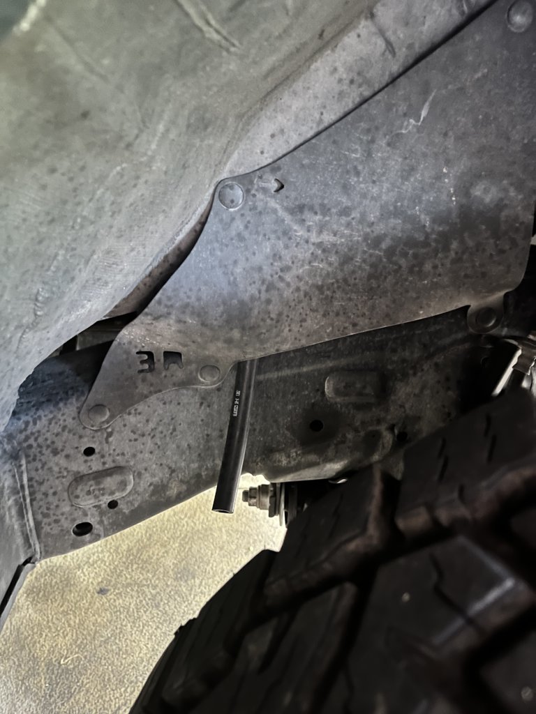

    Just watched this video on a quick fix to stop your ac drain from dumping water on your frame and rusting. Easiest fix I’ve ever done. Went to Oreillys and got a 3/8 to 3/8 brass hose connector and 10 inches of 3/8 fuel hose. Total cost $6.09. Time to install. Less than 2 minutes.
    https://youtu.be/xKxgxBI4k7k?si=p4Usl47h58cl3KHw
    LuLu, TRD_Bro, Imdav2u and 3 others like this.
  2. Jun 9, 2025 at 4:31 PM
    7,279
    A well documented fix that's been posted many times. Did you use any kind of clamps, or just the fitting into the two hoses? And, did you secure it to the side of the frame at all or just let it hang?
  3. Jun 9, 2025 at 4:37 PM
    morfdq [OP] New Member
    1,316
    No clamps just the brass connector. Routed it just like in the video behind the splash shield. Stupid easy fix.

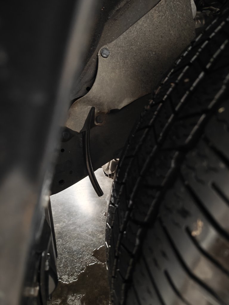

  28. Jun 11, 2025 at 2:21 PM
    Lc200
    Lc200 New Member
    Jun 16, 2023
    #33430
    1,103
    Pre Facelift SR5P
    I went overboard with the length.
