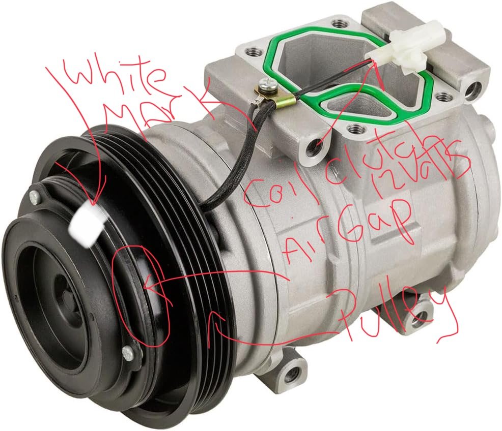

    My AC isn't blowing cold air, (fan blower is working) and the AC light is on the knob and the re-circulate button light is working. Is there a fuse that could be blown or do I just need to get my AC system recharged?
  2. Jun 23, 2025 at 2:17 PM
    3,568
    Visually check to see if the clutch kicks on. After that check the fuse and the relay. After that take it in to a pro to check pressures and if there is none then they would look for a leak.
