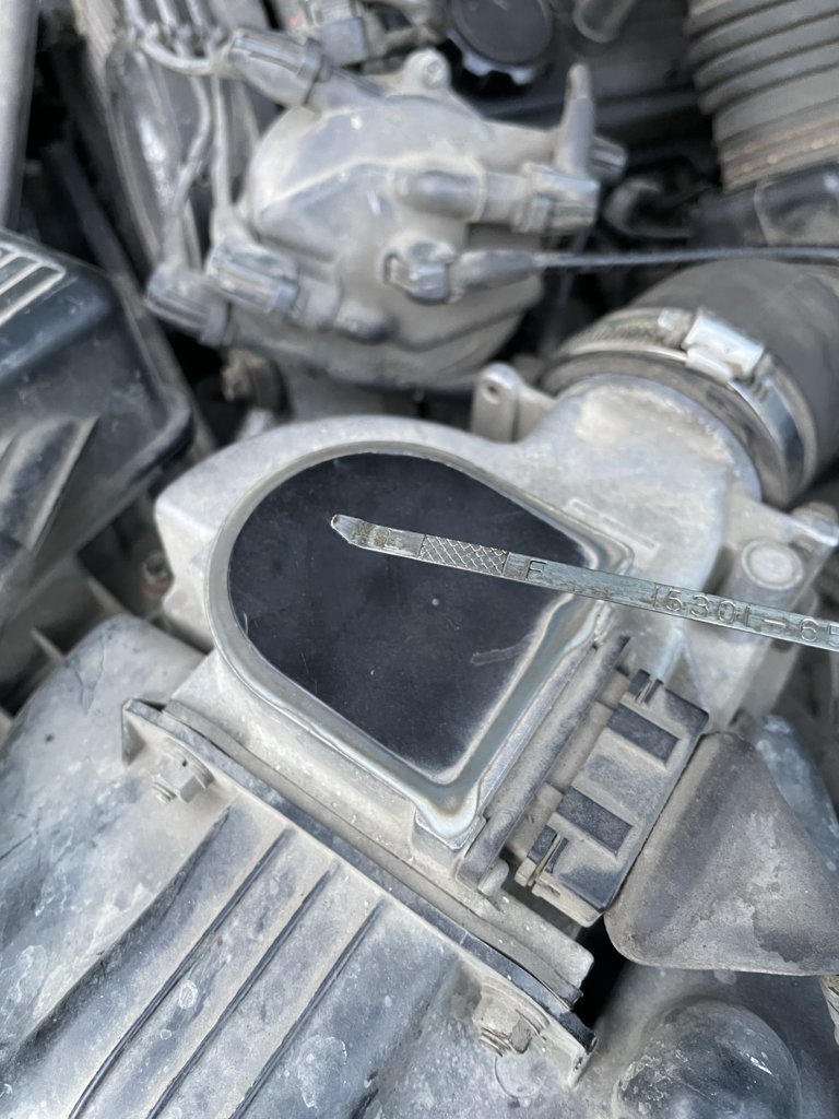

    a couple of days ago my daughter was getting ready to go to work. She started her '92 V6 4Runner (unknown mileage as odometer has been broken for a long time). It started normally (it isn't the strongest engine in the world but has been totally reliable since she bought the truck 9 months ago) and after idling for maybe 1 1/2 minutes it made a sound she described as if something metal was dropped and the engine stalled. It would not restart. I checked, it seems to crank normally and there was spark and tailpipe smells like gasoline but not even a hint of firing.

    That would tend to make me think maybe somehow the cam timing on the driver's side bank got messed up but the thing that is totally confusing me is when I went to check the oil the end of the dipstick is bent and I am pretty sure that wasn't the case last time I changed the oil a couple of months ago. What could have messed up compression on one bank and bent the bottom of the dipstick? Whatever it may be, I am guessing it is time to rebuild or maybe better yet, does anyone make a kit to drop in the 3.4 V6? In any case, she needs a vehicle and this doesn't sound like a quick fix so looks like time to buy a 'beater' car until I can get the 4Runner back in action.

    The bent dipstick is normal. The bend ensures the dipstick can only be inserted one way. On 3VZ-Es, it's almost ALWAYS the driver's side head gasket that gives out as it runs hotter than the passenger's side because of the silly exhaust crossover design. Since cylinder numbers 2, 4 and 6 are low, it'd be a logical thing to check. And conveniently, the distributor runs off the driver's side camshaft so that's a shortcut to check for correct engine timing. As for the odometer, it might be leaking capacitors on the speedometer circuit board, corroding it. Most can be repaired.

    Thanks for the info about the dipstick! That is a relief.
