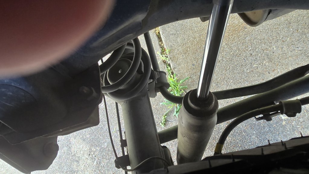

    Hey guy's I'm new here and to all of this so please be kind because I'm kinda dumb. About 2 years ago I came home from being off shore and my wife had gotten a new to her (used) 2020 4runner sr5 premium its a very good looking ride. She bought it with a 6" procomp lift that the previous owner had installed. Well its been riding like absolute ass so was trying to have shocks struts upper and lower control arms. Well come to find out procomp no longer makes anything 6" for the 4runner any longer. So we bought some rough county (because they were pretty much all i could find) front and rear shocks. The front fit great with absolutely no issues replacing them. The rear on the other hand we thought they sent us wrong part the Oring opening (if that makes sense) was way to large leaving way to much play not sitting snug in the slightest. So I guess my question is does anyone know where I might be able to get the rear that will fit? Any help is greatly appreciated

    Well I know its going to ride like ass because of the lift.. what i was referring to was the back shocks had no spring whatsoever and it would rattle a lot. We have the rattle taken care of but the back shocks definitely need replacing. I would love to go down to a 3 but unfortunately at the time the funds do not allow it.

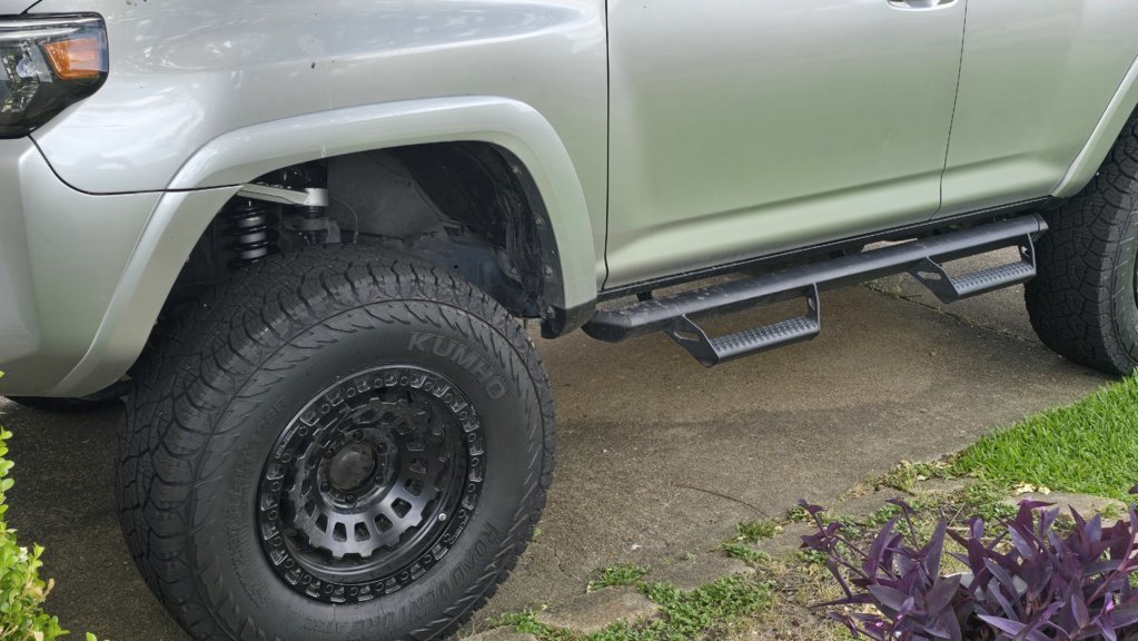

    For those that asked for pictures. If you are wanting to see anything else just let me know where and what you want pics of

    Nice pics that's a crazy lift!! Feel like you'd need a step stool to just get in lol

    Its honestly not that bad even my 70 year old parents can get in. They definitely don't like to but they can.

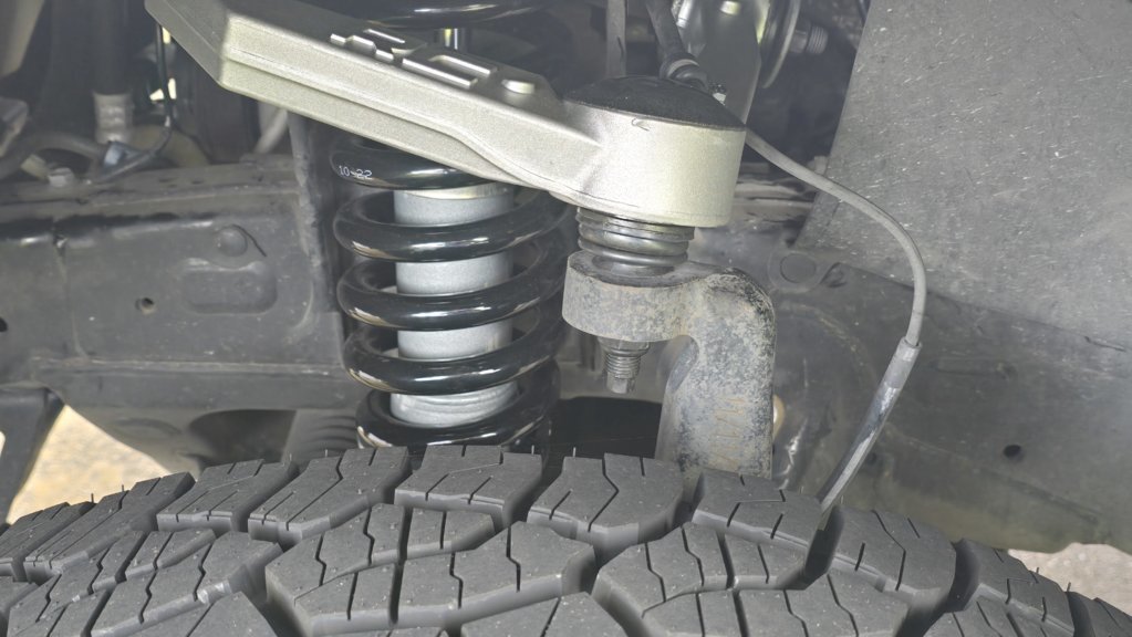

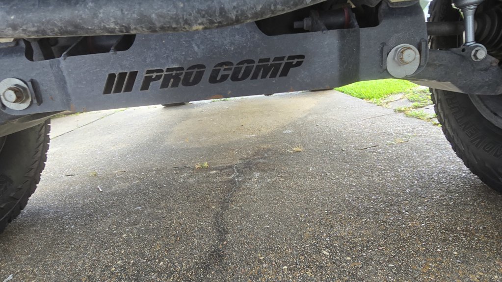

    It’s been mentioned that this lift is basically a permanent alteration due to frame structure that’s been cut out to weld and fit the new crossmembers/brackets for the lower control arms. That new bracket/crossmember repositions the LCA pivot mounts a few inches and is basically what allows you that amount of lift. This, along with a different spindle is what lets you lift it that much while keeping good angles on the front CV axles. But these lifts can cause the driveshaft angles to be at their limits, and the pinion angles might mean issues at the diffs eventually. But I guess it depends on the kit and if the installer did anything to address the driveshaft angles.
    But I suppose it’s possible to dial it down an inch or two based in the LCA droop angle in the pictures. If the front coilovers have adjustable seat height it might not require any new parts to lower it. The rears would need different coils (or shorter spacers if that’s what the lift kit used).

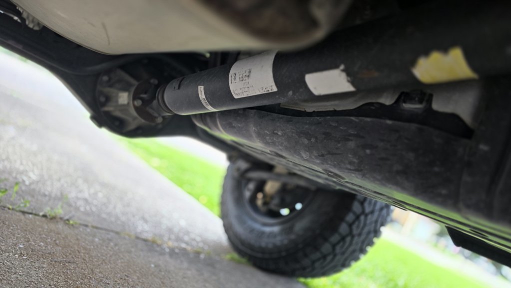

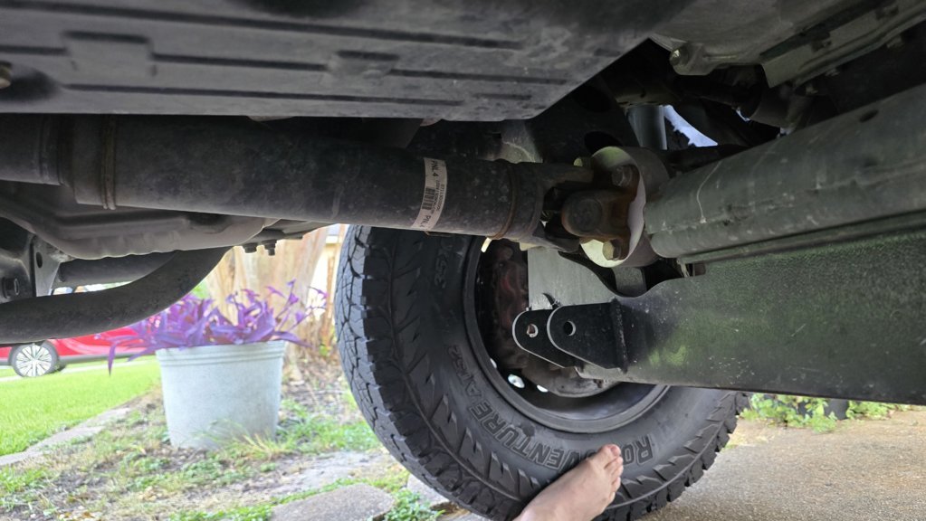

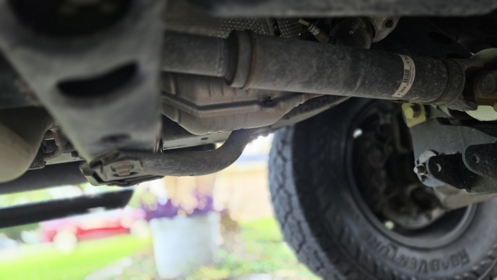

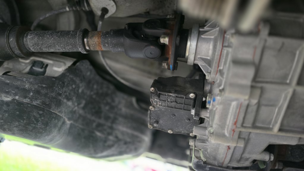

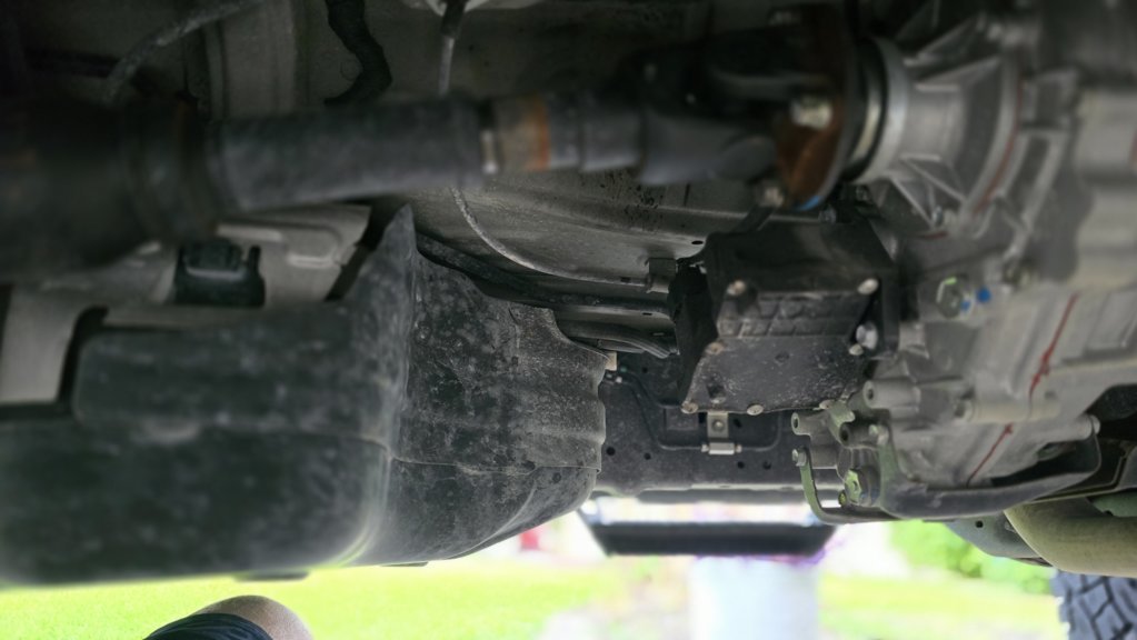

    Just out of curiosity, it would be nice to see pics of where the rear and front driveshaft meet the diffs and each side of the transfer case. I’m curious what the angles look like.

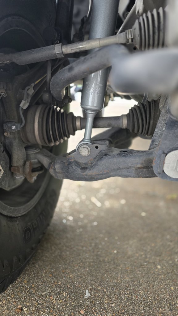

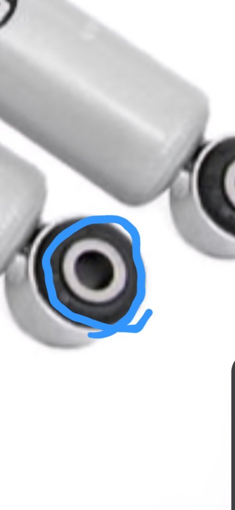

    For reference here is a picture of what is to big on the rough county shocks. Not really sure what its called. And give me I minute I'll go take picks from underneath.

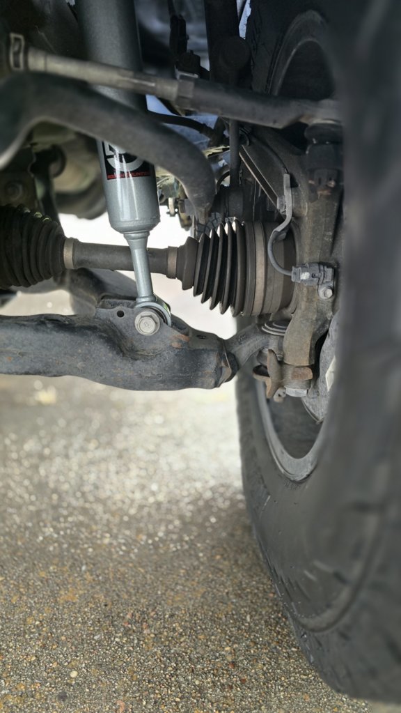

    okay now I'm curious how the cv axles look like at full droop...

    Ok here are some pictures I am not sure if this is what you wanted (I have no idea about any of this BTW) this 6in lift is not what I would have wanted on this but my wife bought it pays for it and loves it. Unfortunately she nor I know nothing about it. Yes I know thats very stupid and irresponsible to purchase something with absolutely no knowledge but what can I say.
  25. May 17, 2025 at 5:03 PM
    6,076
    That’s the shock lower mount eye. I’m not sure how much allowable slop it should have on the mounting tube on the axle. But it shouldn’t be much.
    Also, the bolt that holds them on has is shouldered and I think that bolt should grip on the metal tube within the bushing of the shock. If it’s properly torqued, and the eye is the correct depth (front to back) it might be enough to hold them still.
    But they might be the wrong shock, if so you might need to return them, otherwise it might damage the mounting tube on the axle.

    Not sure what you are referring to at full drop. But here is pics of them.

    Again I know nothing about this so just going off of what two suspension shops have said. The rough county won't work due to the diameter of the mount eye. We have called rough county and they say this is the right one. For shits and giggles one shop tried out the tacoma 6" for the 4runner and the eye was to small and would need to be drilled out which he highly does not recommend. Im going to call procomp on Monday and see if they have any suggestions.
