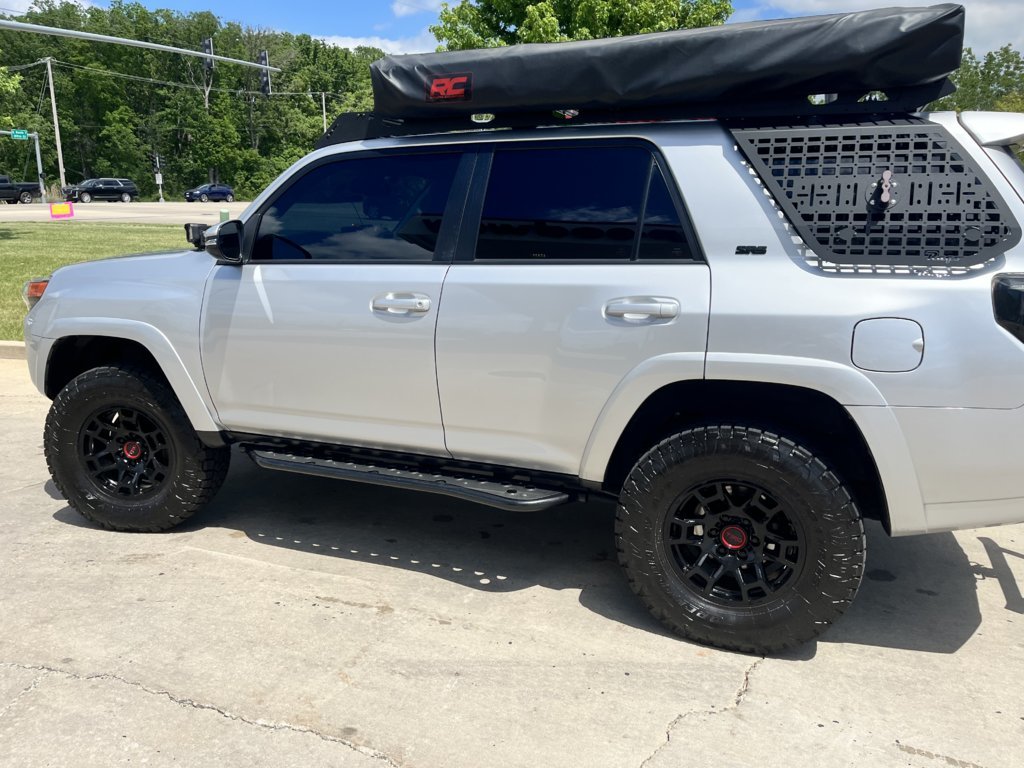

    9,092
  7. May 18, 2025 at 1:40 PM
    1,163
    I have a 22 sr5 with the eibach stage 1 lift. Absolutely love it. Been off roading in Texas ,AZ and Moab totally solid if you call eibach and get them through them and say you want them but would like a discount they will take 10% off.

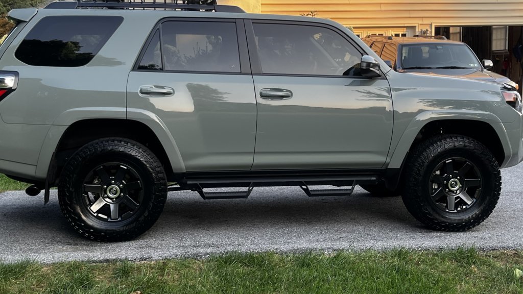

    is that ceramic coated or wax. If wax, which brand do you use.
  18. May 19, 2025 at 2:43 PM
    2,393
    ceramic coated
