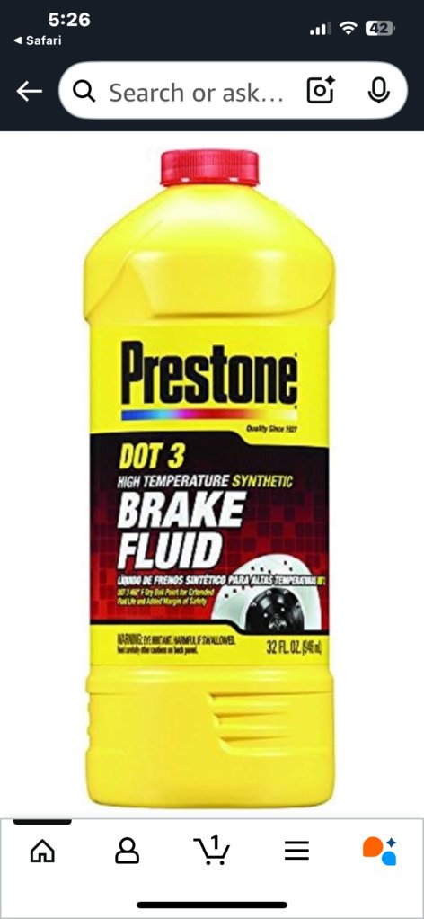

  3. May 31, 2025 at 2:26 PM
    2,410
    My choice
  4. May 31, 2025 at 6:24 PM
    3,016
    I use Prestone DOT3 from O'Reilly in both of my Toyotas. I keep a sealed bottle as a trail spare. Large 32oz size helps if you suffer a leak on the trail. https://www.oreillyauto.com/detail/...restone-32-ounce-dot-3-brake-fluid/prs0/as401
