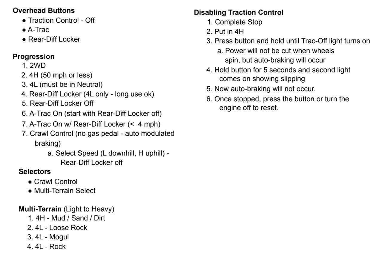

    Yeah, I'm an idiot or the system isn't intuitive. Years of ownership and I finally had to put this together to help me. I just figured out I've been doing donuts wrong. I hope this helps somebody else out of a bad spot.
    Update: edited to correct misinformation, create PDF version, and then re-uploaded.

    There's just a lot going on, hard to keep it all straight. I like this a lot, I might laminate and put in the glove box. Thanks!

    Nice work Bodie! It would be great to have a PDF version of that cheat sheet. The text is a little fuzzy to these old eyes in the jpeg.

    Love the inset with “donut” button! Lol.
    I didn’t figure that out until after a group snow trail ride. As we pulled into a huge empty parking area with fresh powder, a few in the group did some sweet donuts. I decided to jump in, but failed…for all to see.
    :annoyed::p
    I couldn’t figure, it out since I had turned off traction/stability control. Eventually somebody told me about the three second press lol.
    Just yesterday I had to try it again in some fresh snow. I left it in 4wd and was almost able to pivot around the front inside tire. Scha-weeeet! :p

    I see a few changes I want to make, and will create a two page PDF afterwards.

    For the Donut button, add that you must be stopped while holding it down. A lot of people still don't know that you can truly defeat the traction control.

    I'm 99% sure the only MTS mode that can be used in 4H is Mud/Sand if you want to clarify that.

    This checks out, I tried it this morning. I also had to be stopped in order to turn the MTS mode on (I was still in "D" just not moving). For the other three modes I got a message telling me to switch to "N" and then to "4L".

    Yeah, Multi terrain select is not crawl control so the first part looks wrong, but the descriptions seem good.
    Crawl control is just low speed cruse control that happens to also assist with maintaining slow speeds down hill. (this is noisy)
    Multi terrain select just limits/allows a certain amount of slippage depending on terrain you select in the picture.
    A-Trac is just a front/rear locker simulator.
    Rear locker is just that.
    All can be used in 4L only.

    Yes, 100% correct. The first symbol/setting in MTS (Mud/Sand) can be used in 4H, everything else 4L.

    Not too bad. MTS is ABS pump volume control, mall control is offroad cruise control and ATRAC and the locker are there for when you're off camber. ATRAC needs heavy throttle to work properly.

    isnt atrac just front?
    Edit: I guess not, according to the owners manual “The active traction control system automatically helps prevent the spinning of 4 wheels when the vehicle is started or acceler- ated on slippery road surfaces”

    If you have the rear differential open, it will work on all 4 wheels. If you have the rear differential locked, it will only work on the front.

    Seldom discussed, we have TRAC traction control which is always on unless you deselect. It works in 2wd and 4H. Similar to ATRAC which only works in 4L.

    Sorry to be a nitpicker, but in the first photo you have mislabeled multi terrain select as crawl control.
    MTS is just a control that varies how hard TRAC/ATRAC engage.
    You can make it much simpler:
    1. Normal driving 2H
    2. If you get on ice/snow/mud and feel slip when accelerating (vsc light may flash) go 4H. MTS to sand if needed.
    3. If you start slipping in 4H or get on big rocks, stop and go 4L. I usually just leave ATRAC on in 4L, but you may need to turn it off in situations where you want wheelspin to dig out.
    4. If still struggling, appropriate MTS mode.
    5. If even that doesn’t work or it’s big rock and you have wheels in the air, or your stuck in mud and nothing above worked: try rear locker.
    6. If you need help getting unstuck or going up/down very steep inclines use crawl control.

    Those videos were pretty good, although this one recommends always driving with the rear locker on, while the Toyota manual says turn it off as soon as possible. I'll go with the manual's recommendation.
    Thanks again, everyone, for your input. Couldn't have figured it out without you, or a lot more searching online.
