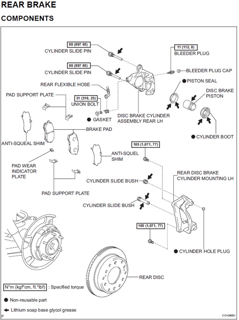

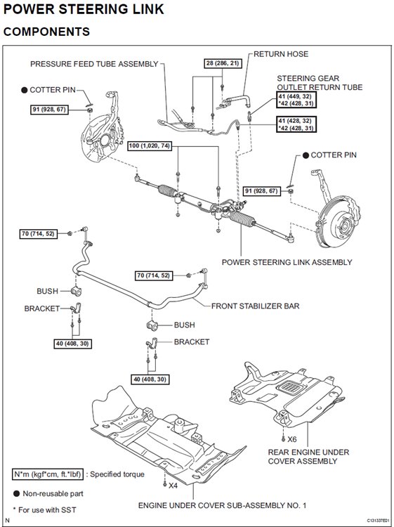

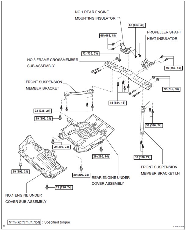

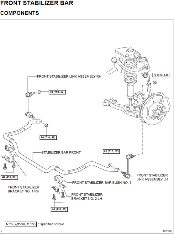

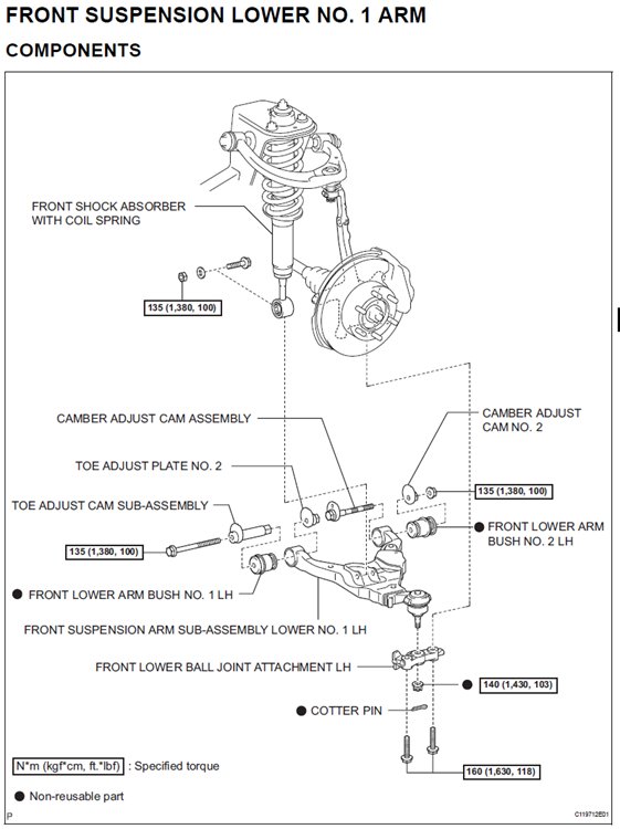

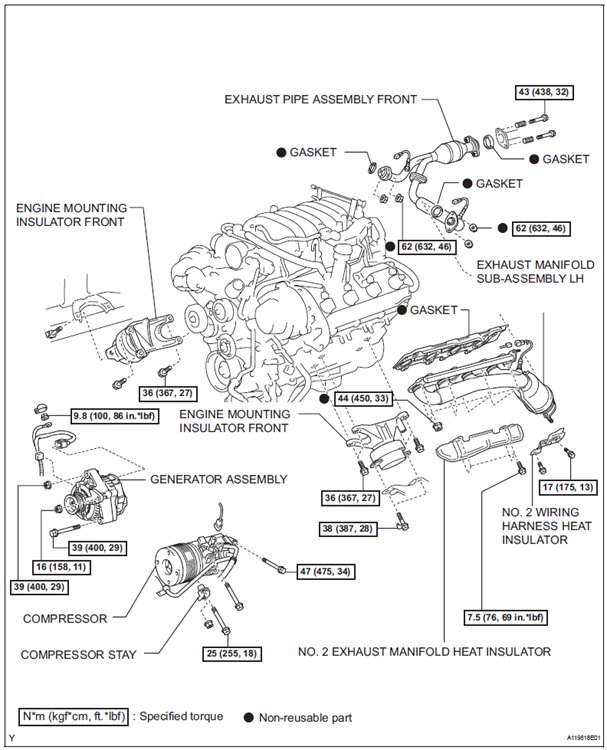

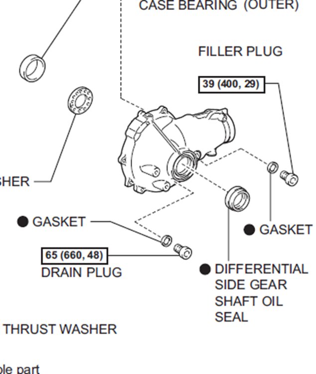

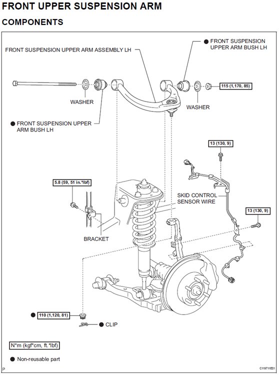

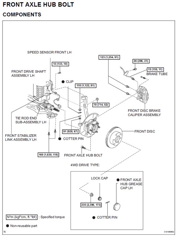

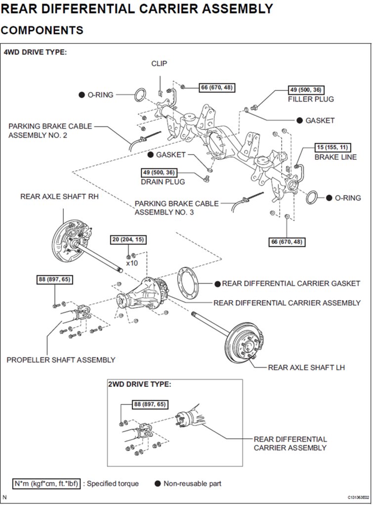

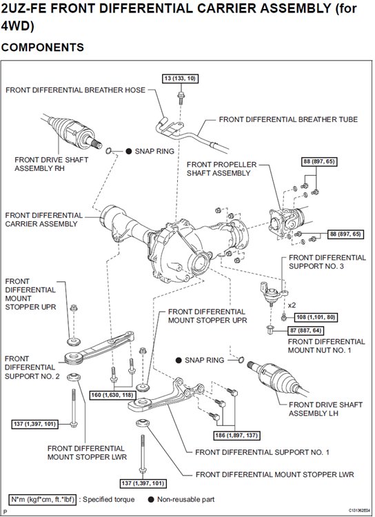

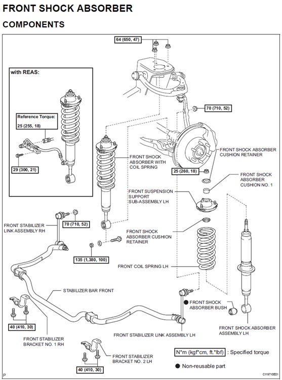

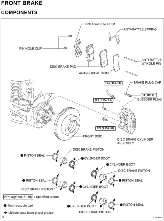

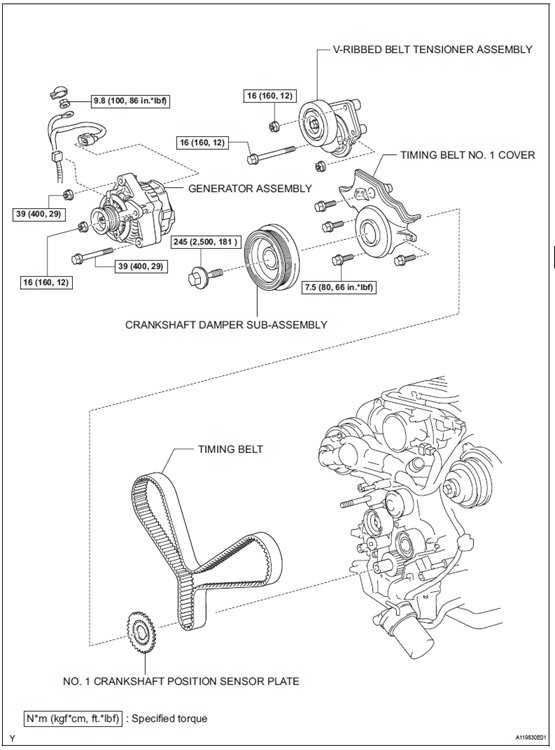

    Hello,
    Last week I brought home a new-to-me 2005 2uz-fe. I have previously owned a 2003 first gen Tacoma for 14 years and have done just about all the work on it myself. (timing belt twice, clutch, suspension, bearings, whatever...)
    I always found it difficult when working on something to look up on my phone the proper torque specs for a bolt through different forums, websites, sources (sometimes they don't match so you need to do more digging) so with the Tacoma I compiled a list of the most common specs to keep on a google doc so I can just look it up in one place and get the number right away.

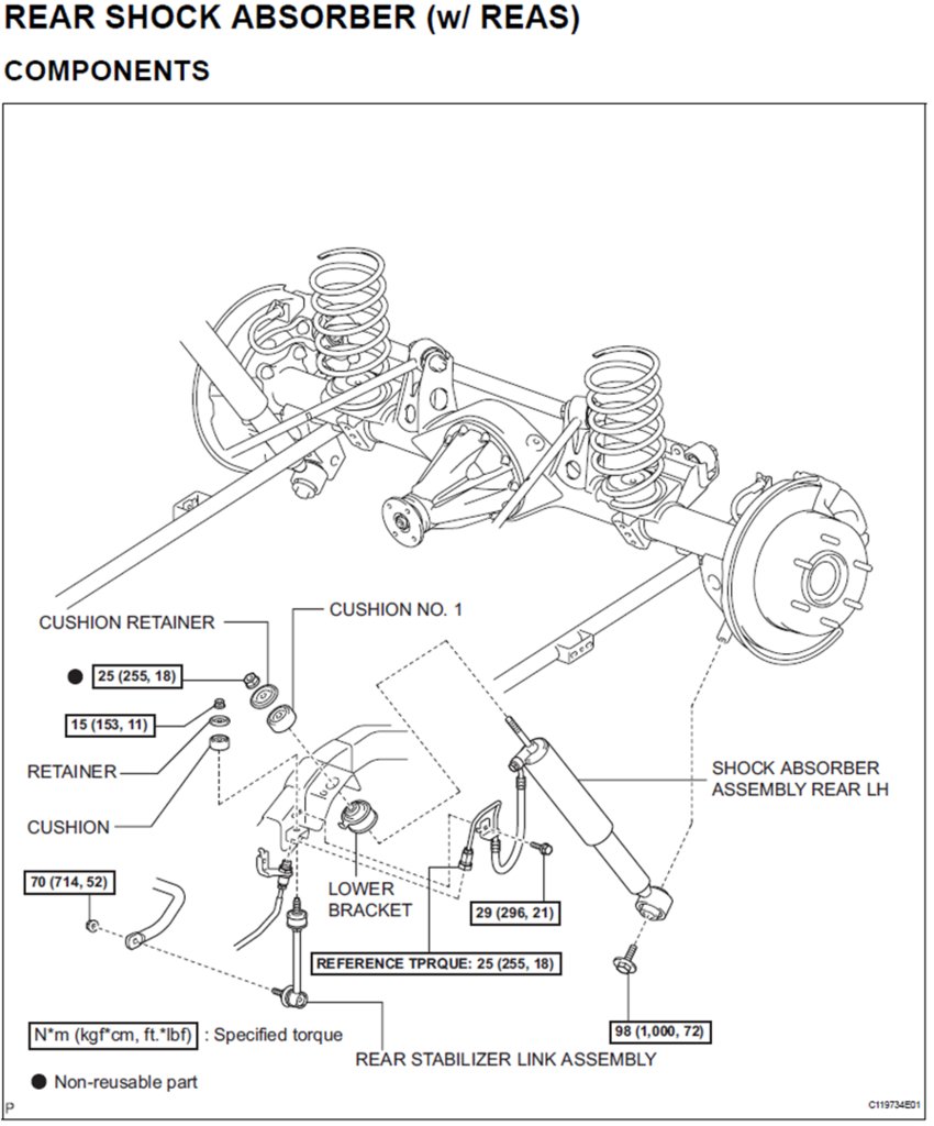

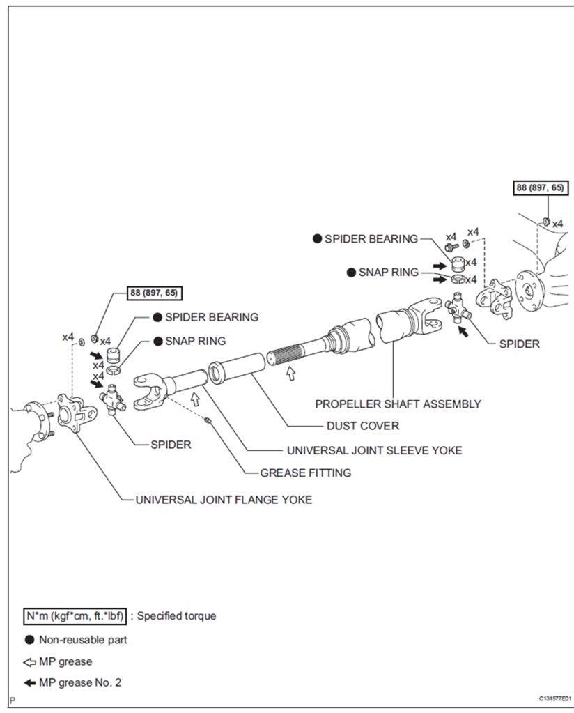

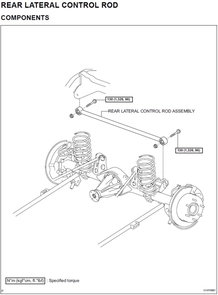

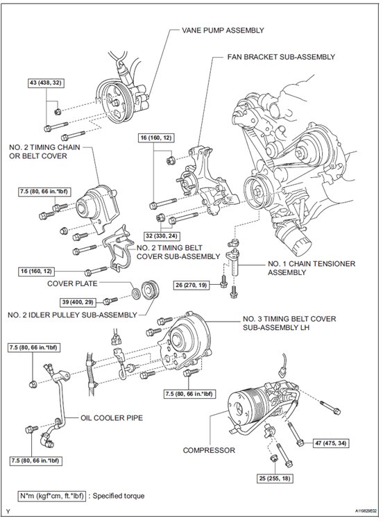

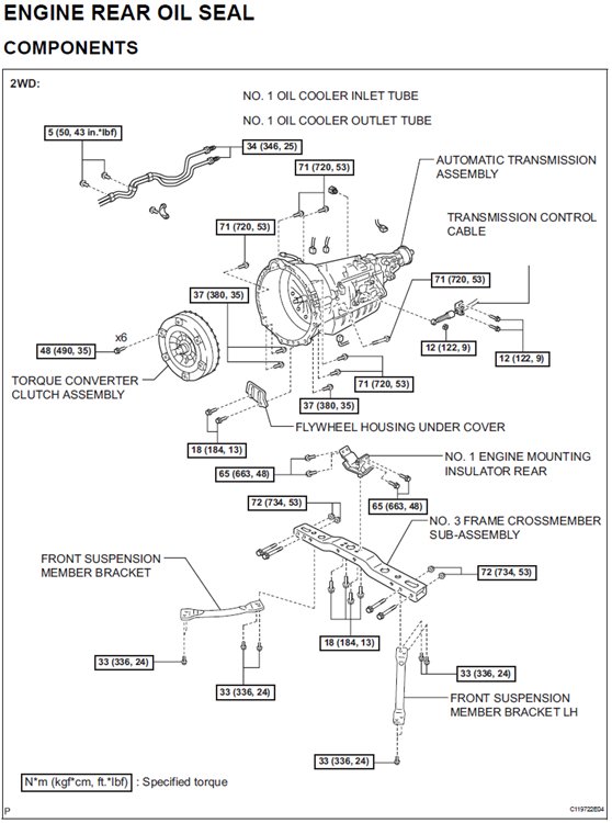

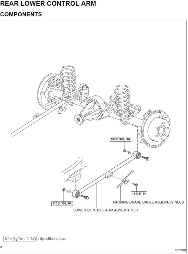

    Anyways, I did that for the 4runner and am just posting it here incase others thought it would be useful for a quick reference, pictures also included for reference.
    (sorry I didn't add any V6 engine specs, but at least the suspension should be the same!)
    (Also, its not everything, I figured if you were getting inside the engine or trans and doing main caps, rods.. you know where to look)
    Hopefully this can help some.
    If there are any discrepancies or incorrect values let me know and I can take a look.
    Engine
    Spark Plugs: 13 ft-lbf
    Oil drain plug: 30 ft-lbf
    Fan Bracket sub-assembly: upper bolt and nut 12 ft-lbs, lower bolt and nut 24 ft-lbs
    No. 2 Timing chain cover: 66 in*lbs
    No. 1 timing chain tensioner: 19 ft-lbs
    No. 1 timing belt cover: 66 in*lbs
    No. 2 timing belt cover sub assembly cover plate: 12 ft-lbs
    Power Steeting pump (vane pump): 32 ft-lbs
    AC compressor: bolts 34 ft-lbs, nut 18 ft-lbs
    Oil cooler pipe: nut and bolt, 22 in*lbf
    No. 2 idler pulley: 29 ft-lbs
    Alternator: nuts 29 ft-lbs, bolt 12 ft-lbs
    Crankshaft bolt: 181 ft-lbs
    V-ribbed Belt Tensioner Assembly: Nuts and bolt, 12 ft-lbs
    Engine to engine isolator: 53 ft-lbs
    Engine isolator to frame: 28 ft-lbs
    Exhaust manifold nuts: 33 ft-lbs
    Transmission
    Transmission A750F fill plug: 29 ft-lbs
    Transmission A750F overfill plug 15 ft-lbs
    Transmission crossmember to frame: 53 ft-lbs
    Transmission crossmember to transmission isolator: 13 ft-lbs
    Transmission isolator to transmission: 48 ft-lbs
    Starter assembly bolts: 29 ft-lbs
    Front suspension/differential/brakes/steering rack
    Lower shock absorber bolt: 100 ft-lbs
    Alignment cam’s: 100 ft-lbs
    Lower Ball joint Castle nut: 103 ft-lbs
    Lower ball joint bolts: 118 ft-lbs
    Upper control arm through bolt: 85 ft-lbs
    Upper shock absorber nuts: 47 ft-lbs
    Spindle to upper control arm: 81 ft-lbs
    Brake caliper to spindle mount: 91 ft-lbs
    Sway bar end link to spindle: 52 ft-lbs
    Sway bar end link to sway bar: 52 ft-lbs
    Sway Bar Bracket to frame: 30 ft-lbs
    Front differential drive shaft flange bolts: 65 ft-lbs
    Front Differential support No. 3: bolts 2x 80 ft-lbs, front mount nut 64 ft-lbs
    Front diff support No. 2: differential bolts 137 ft-lbs, long through bolt 101 ft-lbs
    Front diff support No. 1: differential bolts 118 ft-lbs, long through bolt 101 ft-lbs
    Front differential fill plug: 29 ft-lbs
    Front differential drain plug: 48 ft-lbs
    Front Axel hub nut: 173 ft-lbs
    Steering rack to frame: 74 ft-lbs
    Steering rack to spindle: 67 ft-lbs
    Rear suspension/differential/brakes
    Rear brake slide pin caliper bolts: 65 ft-lbs
    Rear brake caliper mounting bolts: 77 ft-lbs
    Brake hose union bolt: 23 ft-lbs
    Rear lower shock absorber mount: 72 ft-lbs
    Rear upper shock absorber mount: 18 ft-lbs
    Rear sway bat end link to frame: 11 ft-lbs
    Rear differential to propellor shaft nuts: 65 ft-lbs
    Transfer case to propellor shaft nuts: 65 ft-lbs
    Upper lateral control rod bolts: 96 ft-lbs
    Rear lower control arm link bolts: 96 ft-lbs
    Rear differential fill plug: 36 ft-lbs
    Rear differential drain plug: 36 ft-lbs
    Rear differential third member nits to axel: 10x 15 ft-lbs
