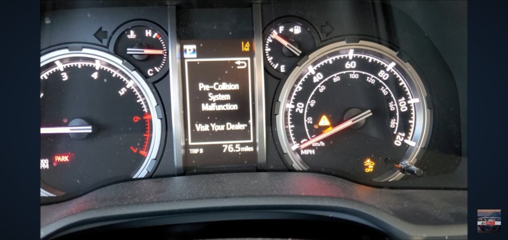

    Hello all,
    I’ve recently purchased a 2023 4Runner trd sport and on the third day of driving the car a pre collision system “please clean sensor” alert pops up on my dash. I ignored it thinking that it may be from the heat and then the next day I get a pre collision system malfunction please visit dealer.
    before going to the dealer I would like to try to clean the sensor first but I haven’t figured out how to remove the front cover of the sensor and I don’t want to remove the sensor all together and have to recalibrate it.
    Any tips and tricks would be appreciated.

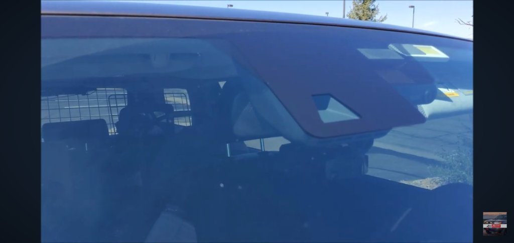

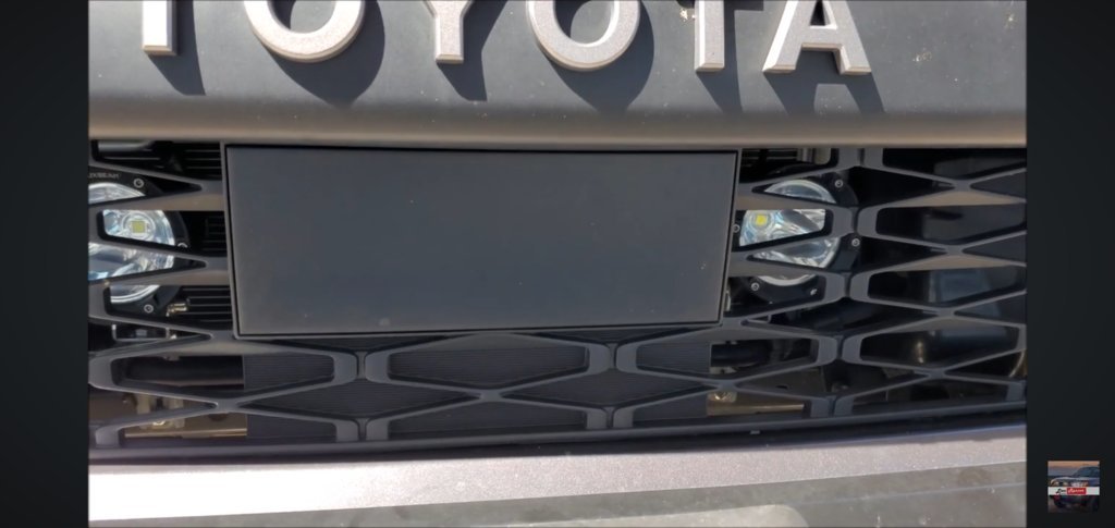

    You just have to clean them, why remove cover? the radar is right in the front grill(black rectangle), the camera is located by the rear view mirror, make sure the windshield is clean, no bugs etc.

  6. Sep 2, 2025 at 5:02 AM
    5,730
    I have seen warnings from Toyota Safety Sense for no apparent reason. Turn off the car and back on it went away.
    On another note it had apply full brakes on me when trying to turn quickly. There was another vehicle in front but I had reasonable distance. I just wanted to turn before the vehicles coming straight. The vehicle behind me could have rear ended me. After that incident I try to take turns / merge like a grandma leaving ton of space to the front vehicle.
    Screenshot_20250902-055403_YouTube.jpg Screenshot_20250902-055421_YouTube.jpg Screenshot_20250902-055447_YouTube.jpg

    In addition, I’ve tried cleaning all the cameras and sensors I could reach and disconnecting my battery terminal for a reset. I personally don’t believe that it’s heat related since the alert is on the dashboard day and night. The only thing I haven’t tried is to clean the sensor that’s behind the rectangular cover which I can’t seem to figure out how to remove without breaking anything.

    The message you got didn’t mean that you need to disassemble to clean it. It just means wipe off whatever is the rectangular outside plastic of the sensor. I get those errors when snow sticks to it, when it’s raining heavily, and bugs that splat onto it.
    Honestly, I doubt these sensors are serviceable. And since they are safety critical electronics, I’d be inclined to think they’re probably pretty well built parts that rarely fail at the individual component level.
