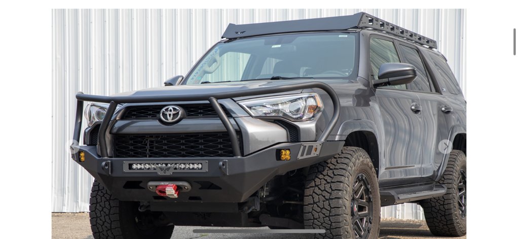

    Time for a real custom bumper!
    Post pics so that people can weigh in.
