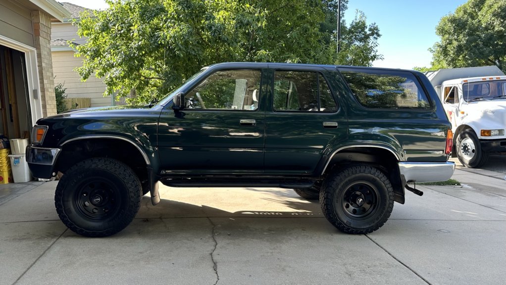

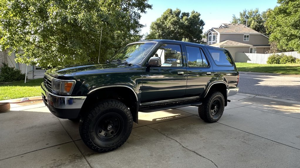

    Thank you for your reply. I may be using the wrong terminology. The final result of adding what is described in the accompanying Old Man Emu attachment is that an extra 2" of ground clearance was achieved in the front of my 4Runner, and the body was lifted 2" off the frame in the rear (which eliminates the rearend body sagging down when the 4Runner is fully loaded for backcountry travel). The ground clearance for the rear differential was not increased by the rear lift.
    I've also attached a couple of pictures of my 4Runner with the current lift and 31" tires, if that helps.

    It should be torsion bars up front and coils in the rear to achieve the lift. I wouldn't go 33s without a re gear with the 22re. I would go 4.88s.
