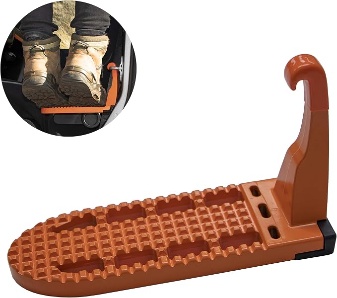

  7. May 21, 2020 at 11:08 AM
    4,911
  8. May 21, 2020 at 12:07 PM
    2A4R
    2A4R [OP] New Member
    Dec 17, 2019
    #12363
    238
    Northern VA
    19 4R TRD PRO
    nimby[QUOTED] likes this.
  9. May 21, 2020 at 1:45 PM
    7,309
    I picked up one of those at a local REI, you'll be glad if you get one. Very useful.
    2A4R[QUOTED][OP] likes this.
