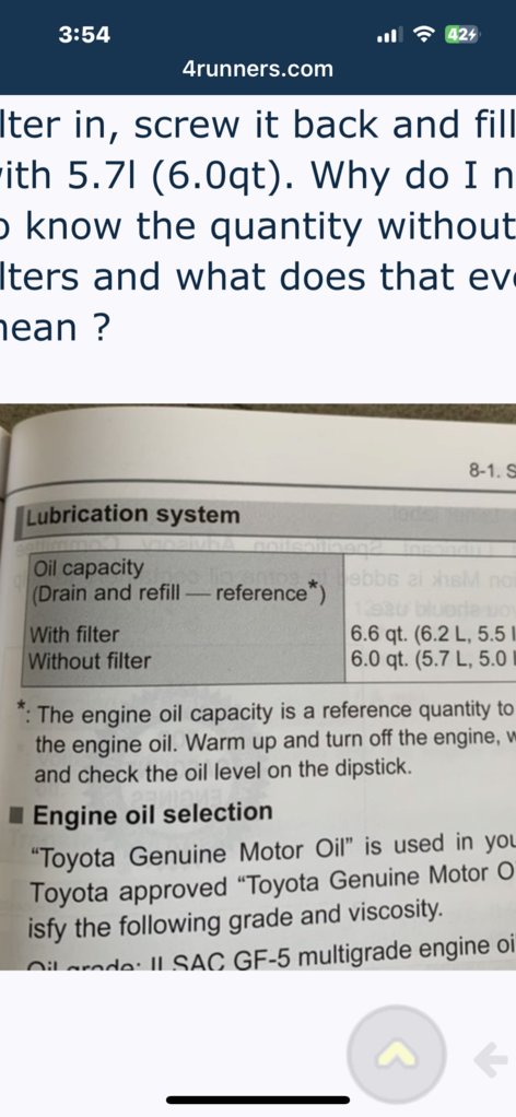

  16. Aug 24, 2025 at 12:14 PM
    3,414
    6.6 is needed. I dump 7 in and call it a day

    From draining mine, I got exactly 6 qt which implies 1/2 qt stayed in. If I were to add 7 qts that would be a total of 7.5 qts in there, a full quart over. That cant be good.
  19. Aug 24, 2025 at 12:51 PM
    3,414
    i have a 2011 with 175k, been putting in 7 quarts since newand no issues. i also drain the same volume out that i put in. Same with my 2022 with 53k.
    maybe you’re not draining all the filter oil out properly

    When I drain my oil, I drain it from a hot engine. I let the thing drain for several hours, with the oil pan drain plug, oil filter cap, and dip stick all removed, vehicle level, on a level garage floor. (Not driven up on an angle on Ramps.) One time though, I did let the thing drain over night, lol.
    Each time so far, adding 6.5 quarts of new oil gets me right on the full mark on the dip stick. I’ll add only 6 quarts initially, and start the engine and let it run for a few minutes. Then I’ll leave her set for quite a while and go off and go do something else. Upon checking the dip stick, I’ve always needed to add that final half a quart to get right up to the full mark on the dip stick.

    You could have burned some oil or the last person may not have put enough oil in. The manufacturer says to put in 6.6 quarts of oil so that’s what it should get.

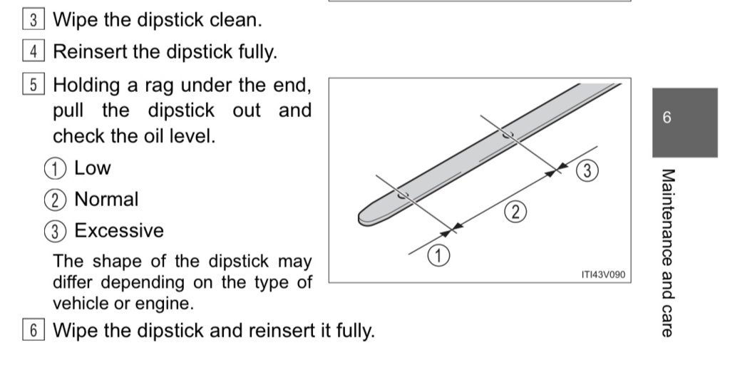

    The dipstick should be the ultimate arbiter of how much oil is put in.
    Spare Parts and catbrown357 like this.

  26. Aug 25, 2025 at 11:02 AM
    2,226
    Not when refilling after draining. The manufacturer knows exactly how much should get put back in.
