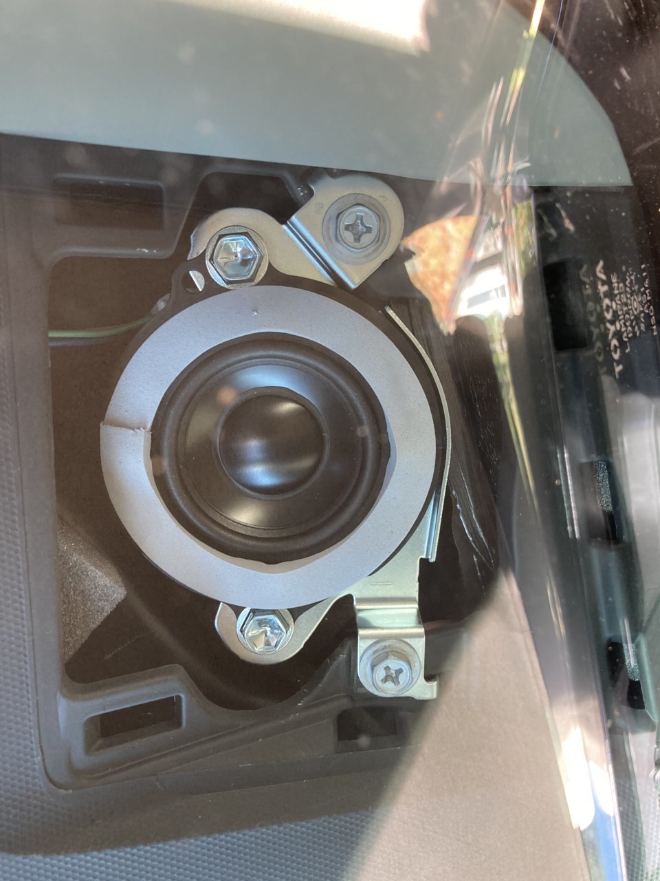

    I chose the AP 2 because it looked like the perfect speaker for this location. There's no physical modification of the space required, the bracket works, and this speaker handles 150Hz to 20kHz. It's like putting the entire sound stage in the dash. My only eh on these is their power handling, 25W RMS - 50W peak, but paired with the AP8.9 Bit, I think they'll do fine. My plan was a lower power SQ system for this truck anyway. If I don't like them, the AP690 goes up to 5000Hz and I've got some Voce tweeters I can toss in.
    Here we go. At some point I'll install the amplifier and run new speaker wire, but I wanted to put these in, listen to them, see the difference, and assess them using the OE stereo's tune.
    Toyota parallel wiring harness -
    https://www.amazon.com/gp/product/B07RMZ4CR6/
    Metra 2.5" Speaker Adaptor -
    https://www.amazon.com/Metra-82-4201-Chrysler-Speaker-Adapters/dp/B01LXF9JNQ/

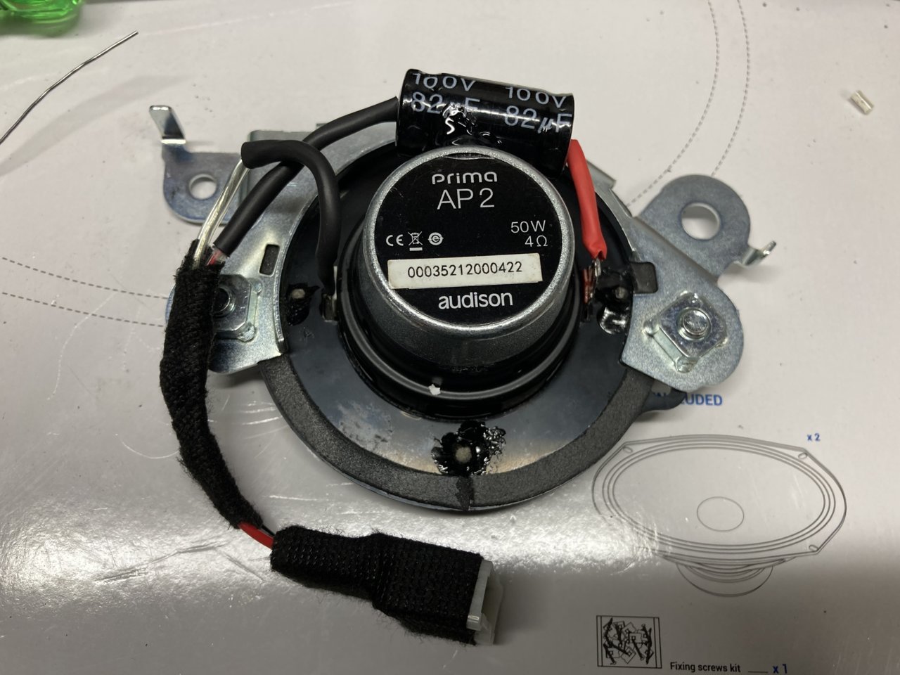

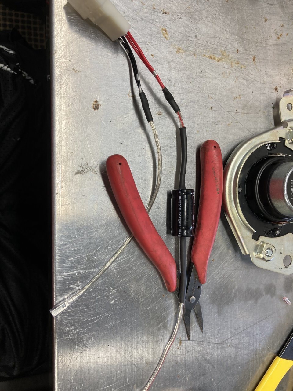

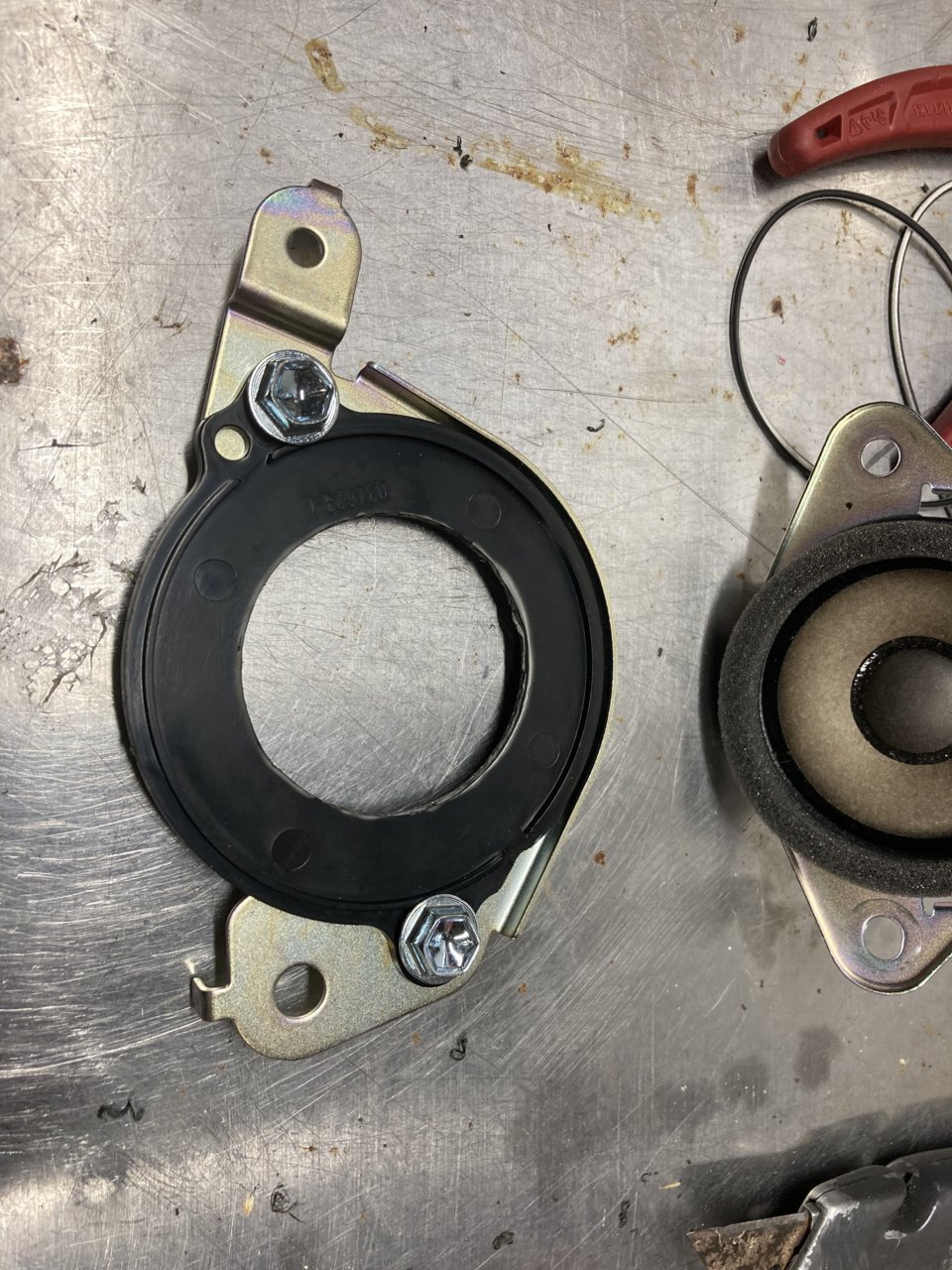

    I used a 1 1/2" electrical conduit knockout to make the hole in the Metra tweeter mount plate for the AP 2 and mounted it onto the OEM dash speaker bracket. The fit is snug and I ended up having to make a rectangular notch on each side to make room for the terminals on the speaker to fit through. I also trimmed off one of the plate's mounting holes.

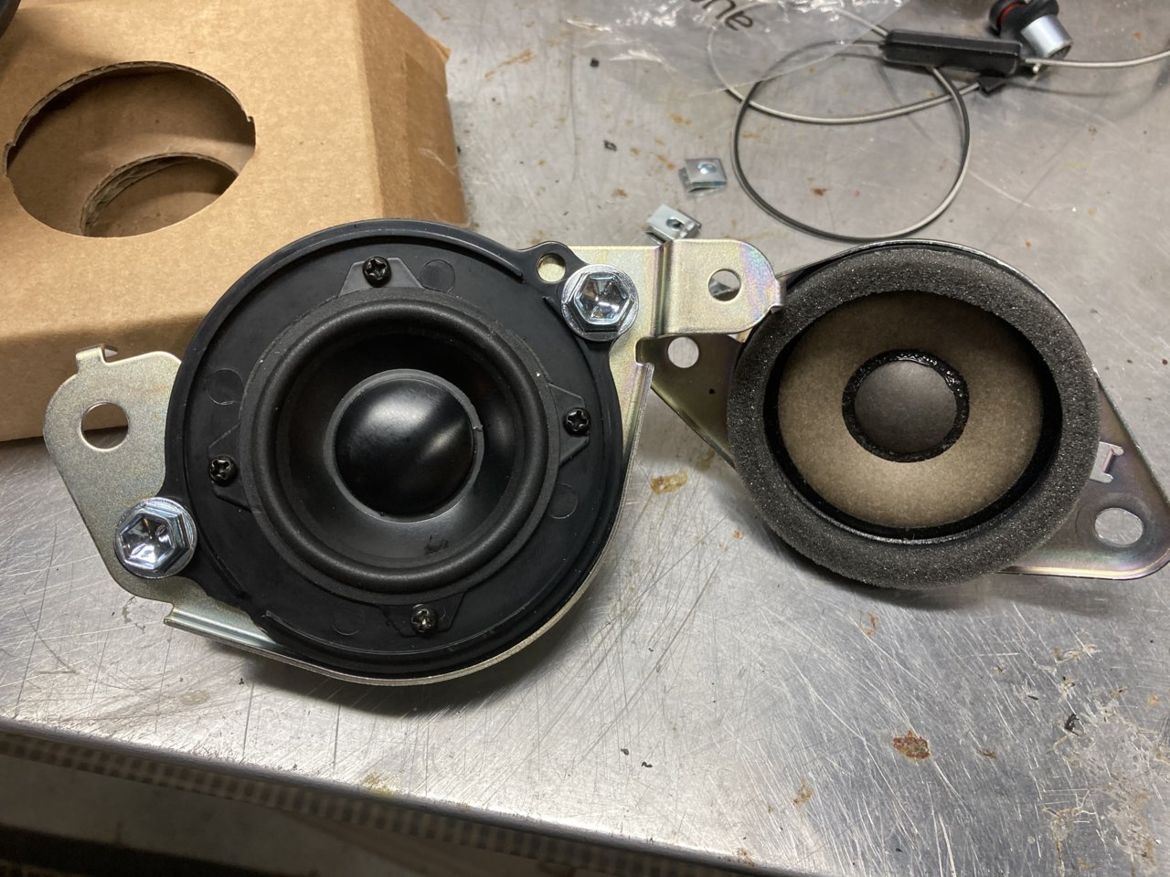

    Here's the AP 2 compared to the OEM dash speaker.
    I went ahead and soldered in the filter capacitor because for now I'm not bi-amping the front.
    Here it is all wired up with the parallel speaker adapter harness. I used silicone on the back of the mounting screws, as well as a dollop to hold the capacitor in place.
    This is what it looks like all mounted in there. The alignment with the dash cover is perfect.

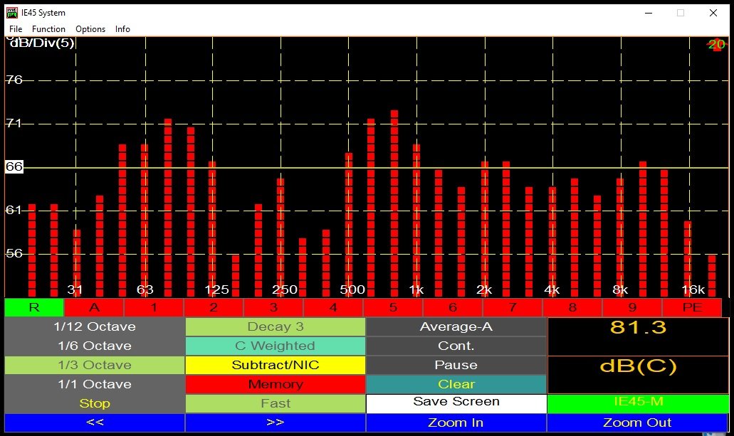

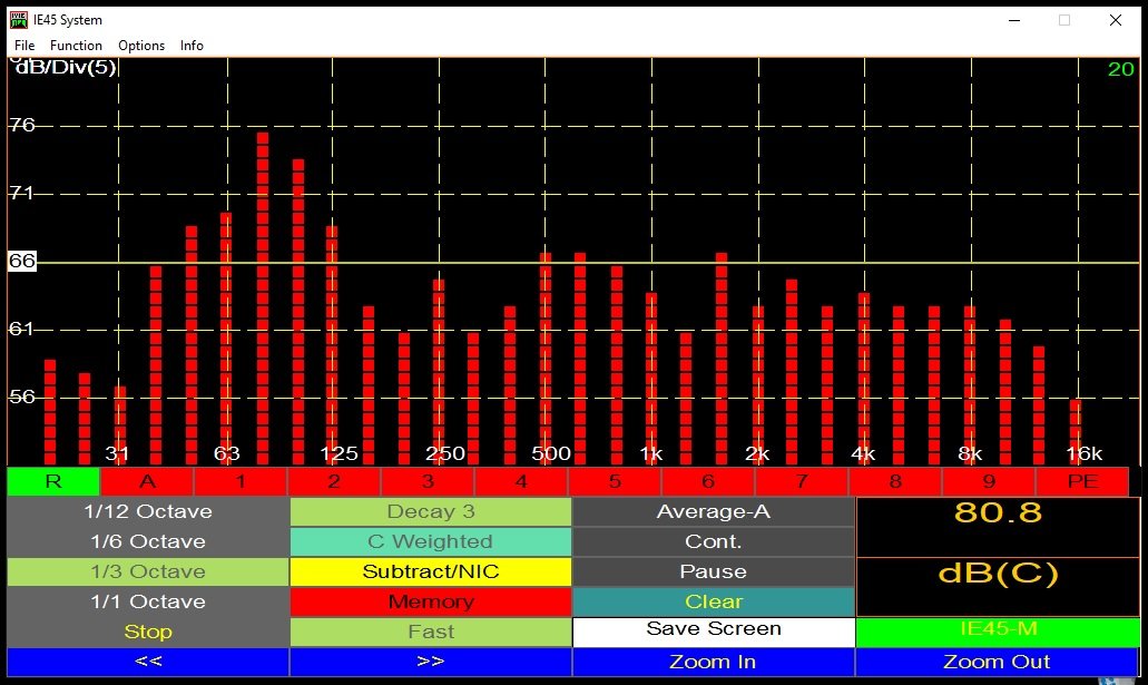

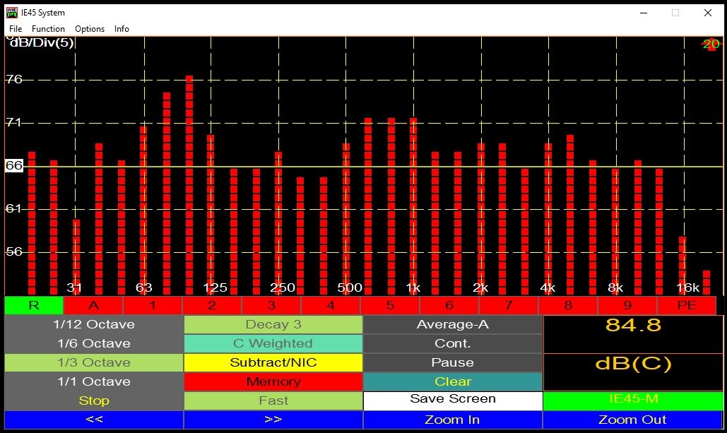

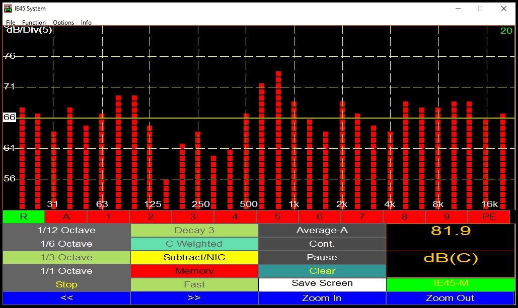

    Here are some measurements I took after installing the AP 2 speakers in the dash. It looks to me like the Entune system is definitely aligned to the driver's seat based on these results. All the audio balance/fade and High/Mid/Bass controls are set to Null.
    Microphone is on the center console - Stock Dash Speaker
    Microphone is on the center console - AP 2 installed
    Microphone is in the driver's seat - Stock speaker
    Microphone is in the driver's seat - AP 2 installed
    The AP 2 is definitely more sensitive. To listen to music I had to turn the treble down several clicks. Without being able to do any EQ it's hard to say how smooth/flat I can get them, but I will say that they sound much more competent than the OEM dash speaker and I quite like what they sound like so far. It looks to me like they really want to be high pass around 500Hz. I think the filter capacitor is a 6dB Butterworth at 300Hz.

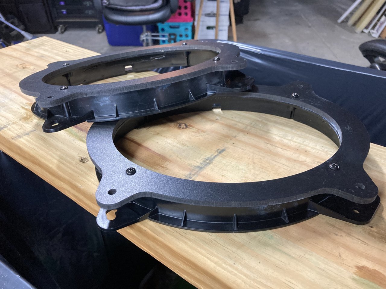

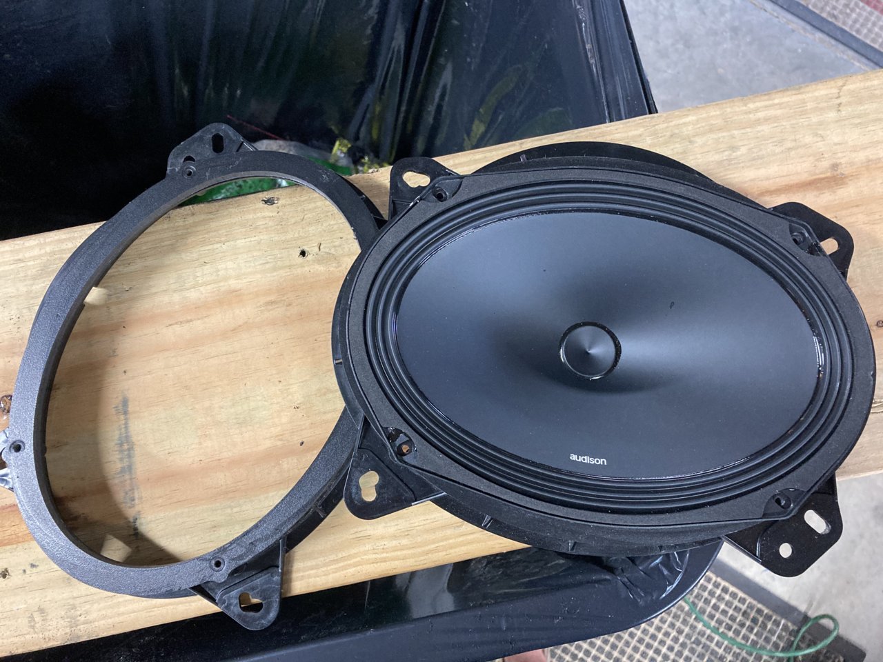

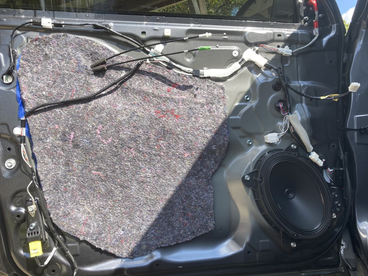

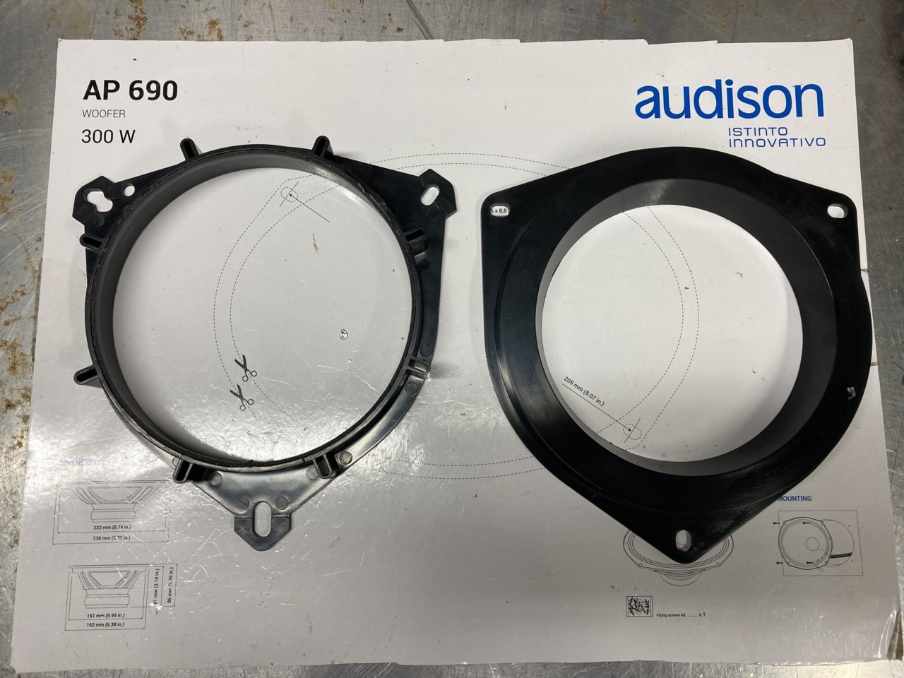

    So the Metra adapter isn't tall enough to make a good seal between the weather strip I was adding to the speaker, and the oval flange that seals against the speaker on the back of the door panel. Once I took the OEM speaker out, I made measurements and decided I needed a 1/4" spacer to make up the difference. So I mounted and glued the spacer onto the Metra speaker adapter to get the right height.
    Once the glue was dry I took a router and cut off all of the extra material so the spacer matched the top profile of the Metra adaptor. Then I painted them with FlexSeal. I don’t really like the Metra speaker mounting brackets because they are so cheap and flimsy, but after adding the spacer and painting them, they were more rigid and less overall shitty so I didn’t worry about it. Maybe next time I will look for or make something else.
    I put Noico on the inside of the outer door skin. I didn't go crazy, I just did whatever large pieces I could on the large areas without getting too nutty about piecing things together. I probably have more than 75% covered, but I found that the 4Runner already had a large square of something stuck there for the same reason I assume, and a piece of structural foam is bolted in there too so I removed that, put Noico behind it and bolted it back in.
    Here's where I did something a little different. I planned on replacing the vapor barrier but wanted something a little extra. So I looked around and found this product that is designed to go under laminate flooring that is a vapor barrier, but is also a layer of felt for noise reduction. The description said tolerant to extremes so I decided WTF and got it as well as some butyl tape to install it in place of the OEM vapor barrier. I put some weather stripping on the speaker and put the door back together.

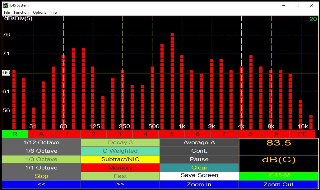

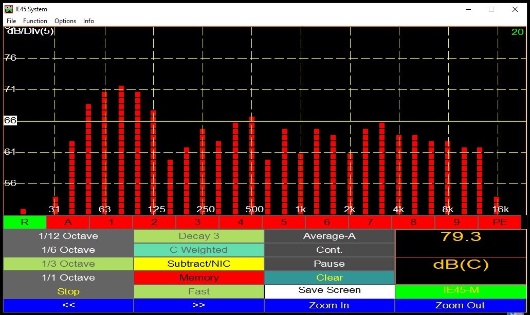

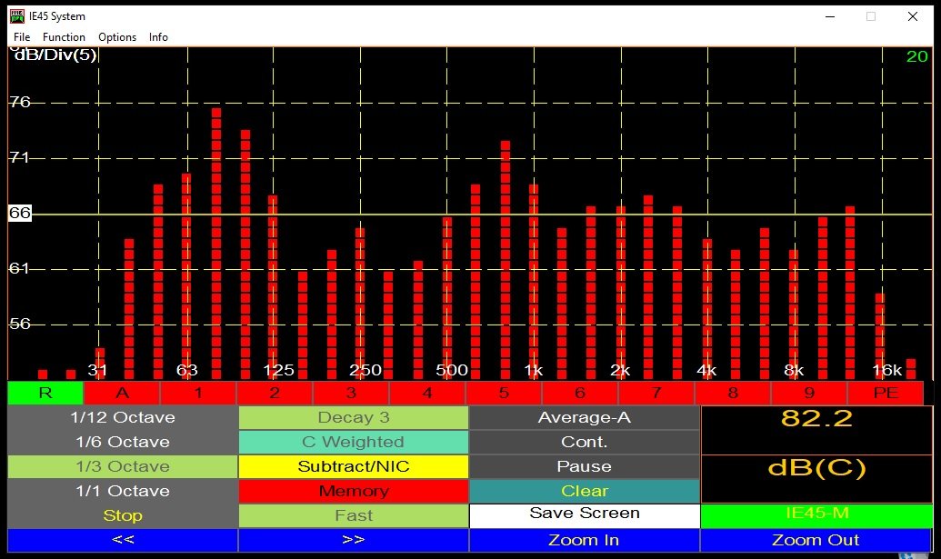

    After the door woofers were done I took measurements again. To the ear, it sounds a lot more tight/controlled. The factory speakers were really boomy, but I'm sure all of the door treatment is a contributing factor. I've been listening to this setup for about a week and all I feel like I'm missing is some of the area where you hear musicality in bass guitar, which is probably that dip area between 160Hz and 315Hz, and there’s nothing I can do about it right now because the center frequency for Bass in the Entune is 100Hz and there’s nothing until Mid, which controls 1.25/1.6kHz.
    Microphone is on the center console - AP speakers installed
    Microphone is on the driver's seat - AP speakers installed

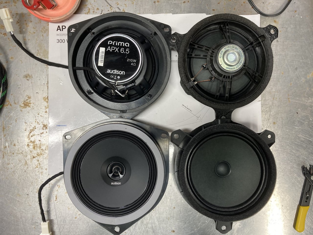

    Rear Doors
    Mosuch 6.5" speaker mounting bracket -
    https://www.amazon.com/gp/product/B007ZQGZWO/
    Rear doors were a repeat of the front. I removed the vapor barrier, put Noico on the inside of the outer skin, and replaced the vapor barrier with new butyl tape and the stuff that's felt lined. I did not like the Metra speaker adaptors however, and used an alternative that I found on Amazon. The inside angled flange of the new bracket interfered with the terminals on the speaker, preventing them from seating so once again I used a router to trim it down for a perfect fit. I used these same materials and methods for the rear hatch speakers as well.
    Metra on the left, Mosuch on the right.
    Mounted and wired for installation.

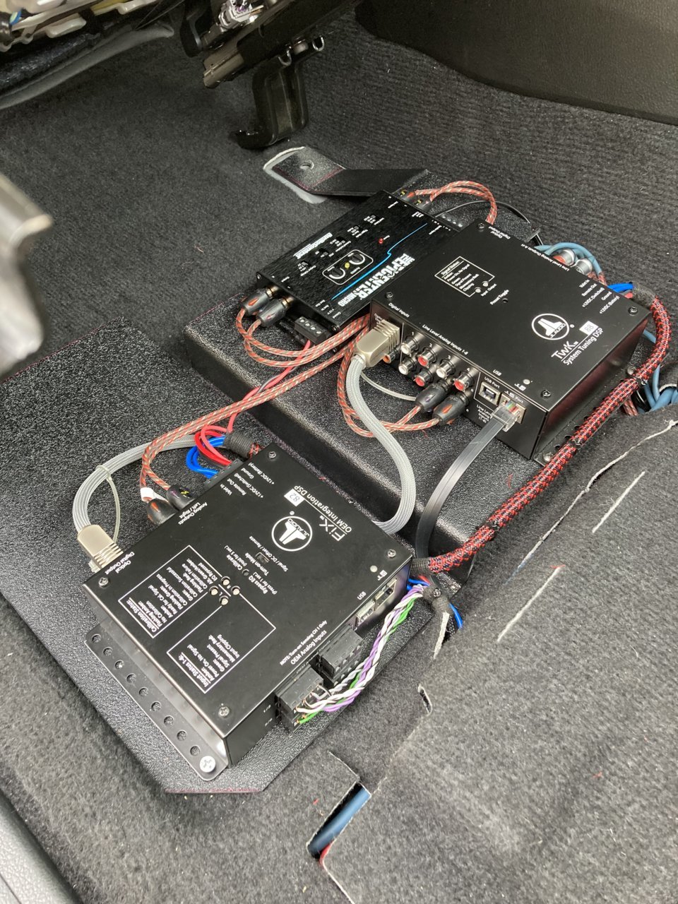

    Amplifier/DSP Installation

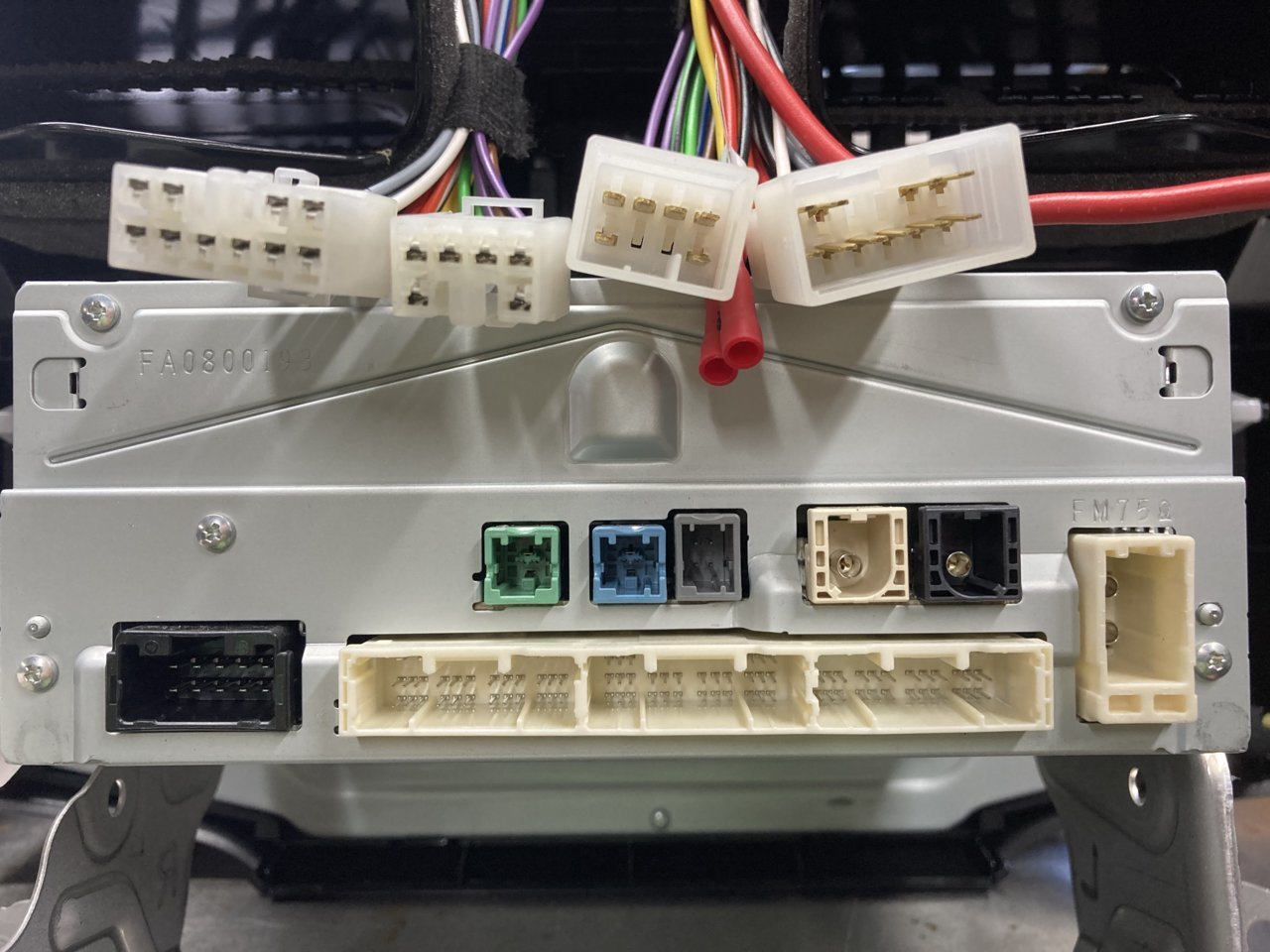

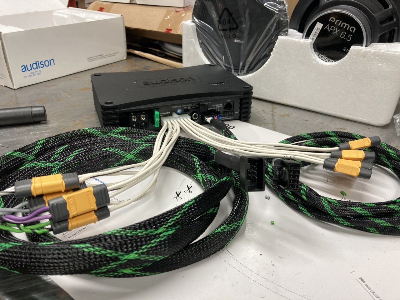

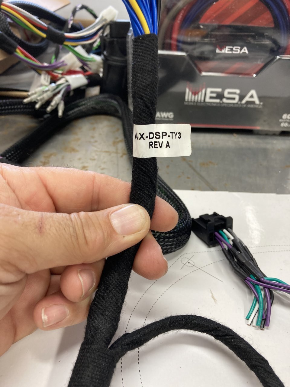

    The Audison Toyota T-Harness vs. the connectors on my 2020 OEM stereo. I hadn't taken the stereo out to look at what the connectors looked like, and I didn't think necessarily that the Audison plug and play harness would work in this application, but I wanted to get my hands on it and see.
    So I made the guy at my local audio shop aware of my harness situation and he dug around in the cabinets for a minute or two and handed me this and said "K, use this one." He didn't charge me for it, probably since he assumed the Audison harness would work when he ordered it. Another reason to have a good relationship with your local shop.

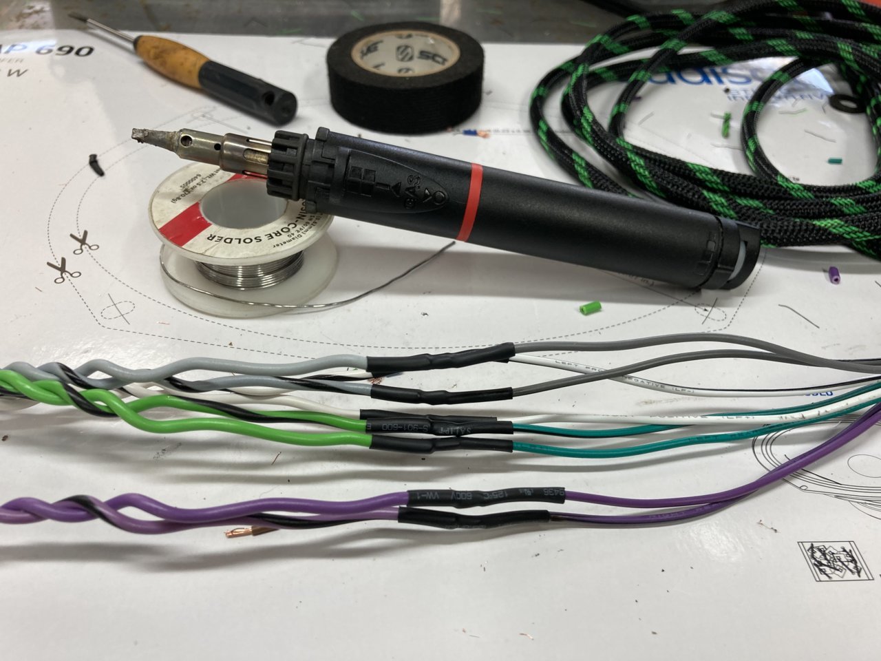

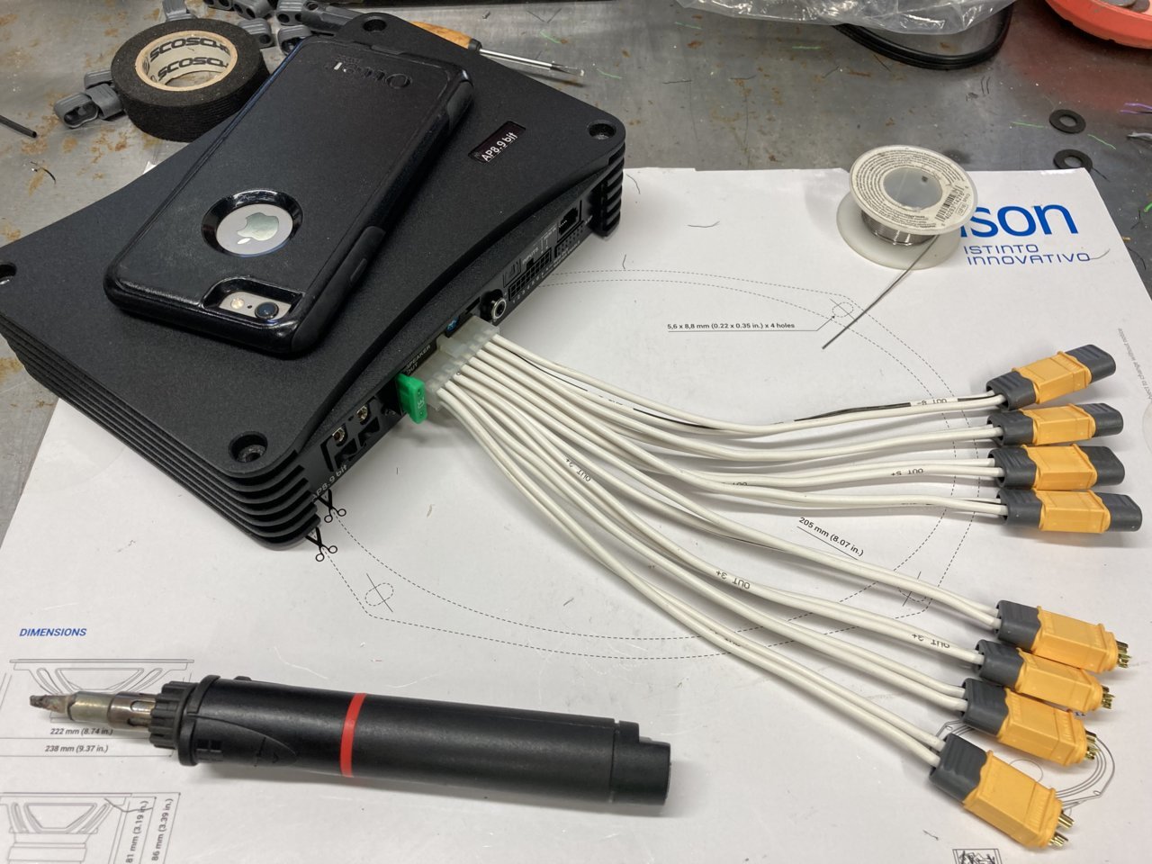

    Just normal solder and heat shrink for sending signal back to the OEM harness to the speakers. Essentially I chopped the connectors I needed from the AX DSP harness and replaced the Audison plugs that were wrong for this stereo. Conveniently, it looks like all of the speaker terminals are combined into one plug on the stereo, so it was a straight single connector swap on both ends.
    Since I like to change things up often, I decided to put these connectors on the output of the Audison amplifier. This way I can wire up different configurations and make changes to the speaker side and not have to get into this pre-made pigtail that plugs into the amp.
    Over time this configuration has gone through several changes and these connectors have come in handy for changing what each amplifier channel is doing. For a while I was using a hybrid configuration where some channels were bridged and others not, some channels wire back through the factory harness, some to replacement speaker wiring I added so I can run active crossovers to the front. I now have a separate amplifier for the tweeters and I'm using this amplifier bridged to 4 channels to power the front woofers on two channels and the entire rear from the other two through the factory harness.
    All loomed up and ready to install.
    I wanted to get the thing in there so I installed it dirty until the rest of my supplies show up. Primarily I wanted to check out the de-EQ function as well as get a basic tune in the truck. Let me first say that I'm still not a fan of the BIT software. While it is perfectly capable, it's just a pain in the ass to use and there are some things you can only do inside the Wizard, which pisses me off because I like to try things and do A/B comparisons. That being said, it's connected and I was able to run through a few of its features.

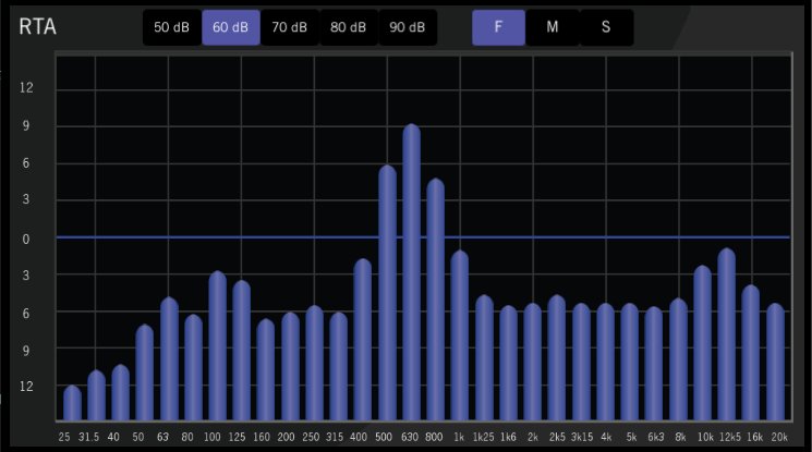

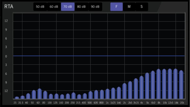

    This is a comparison of the response in the vehicle with and without the deEQ function activated. Based on these results, IMO the deEQ is total shit. I ran through it several times and I just don't understand WTF this piece of shit is trying to do because every time the results were worse than just leaving it disabled. I connected the speakers and took a listen to the Audison test files, the Pink Noise is band limited, which is fairly normal for setting levels, and it uses a Sine Sweep for the de-equalization process. You can only run the deEQ inside the Setup Wizard, and as far as I can tell, if you disable it and disconnect, you have to perform the process over so I don't think it keeps this file on standby in case you wish to enable it again. Annoying.
    Microphone is on the center console - deEQ on
    Microphone is on the center console - deEQ off
    Microphone is in the driver's position - deEQ on
    Microphone is in the driver's position - deEQ off

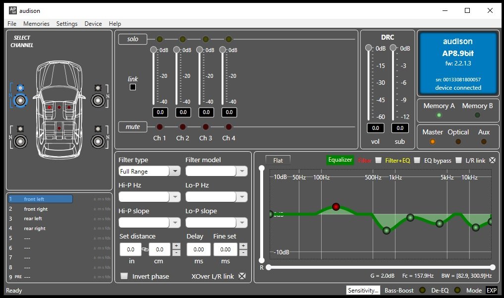

    Let me just say that personally I believe deEQ is a flawed concept irrelevant to these results. Often, at work when I'm setting up a large sound system there are several components in the signal chain that have the ability to manipulate the signal and I try really hard to only use one device rather than stack anything. This is simply because I think LESS EQ IS MORE, taking an input that has been equalized and then adding more equalization to it runs contrary to my philosophy of "leave it the hell alone if possible" because more EQ is just more potential distortion, more unnatural manipulation of the waveform, and in the case of deEQ, you could very well be turning something down that was turned up in the previous device. IMO this should be called counter-EQ, as that is a more precise description of what's happening.
    The same reasoning applies to crossover filters. When you have crossovers in your stereo and also on your amplifier you have to pick one. When you set a low pass on the head unit, then stack another crossover filter from the amplifier, even if it's the same frequency, all you are doing is skewing the signal's phase even more. Consequently, if you want to time align, you're making larger adjustments.
    Anyway...
    After I decided to leave the input equalization disabled, I ran a quick tune and here's what the result looks like. I left the microphone in the driver's seat for this.

    Like I said earlier, this is a constantly evolving project and as such, more changes have been made. After installing the JL TwK-88, all of the crossovers, routing and EQ have been relocated from the AP8.9 BIT to the JL DSP and I wired the 8.9 as a regular amplifier bridged to handle four channels. I never really liked its connectors and eventually I started getting a little sound moving around when I hit bumps, which to be fair is probably more of a consequence of how shitty I installed it. Nevertheless, I wanted to pull it out and install a good four channel amplifier. Conveniently, companies are all the time improving and adding things to their product lines and in the time between relocating my amplifiers to the rear and now, Soundigital has expanded and improved their selection. Behold, the Tiny-Punch-Packing 800.4 EVOX2. No lie, this thing is small and finally there's something out there that can easily fit about anywhere with decent power, 4x 132W @4Ohms.

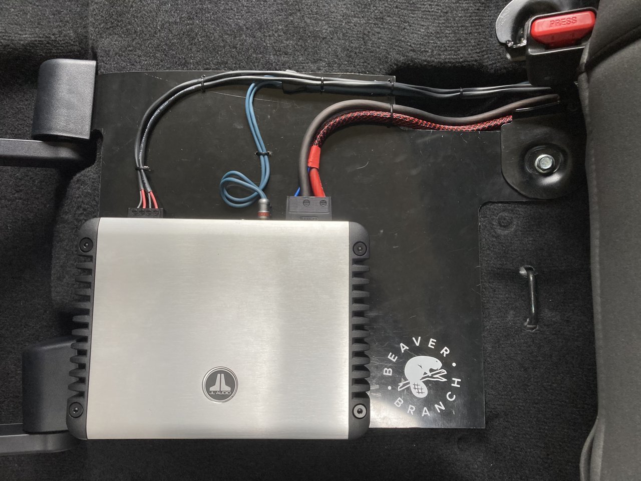

    I remade the plastic mount for everything under the front passenger seat. My original one was not adequate after all of the changes. I mounted the DSPs all there and moved the amplifiers to the rear.
    Final piece ended up being the Epicenter Micro. GET AN EPICENTER!

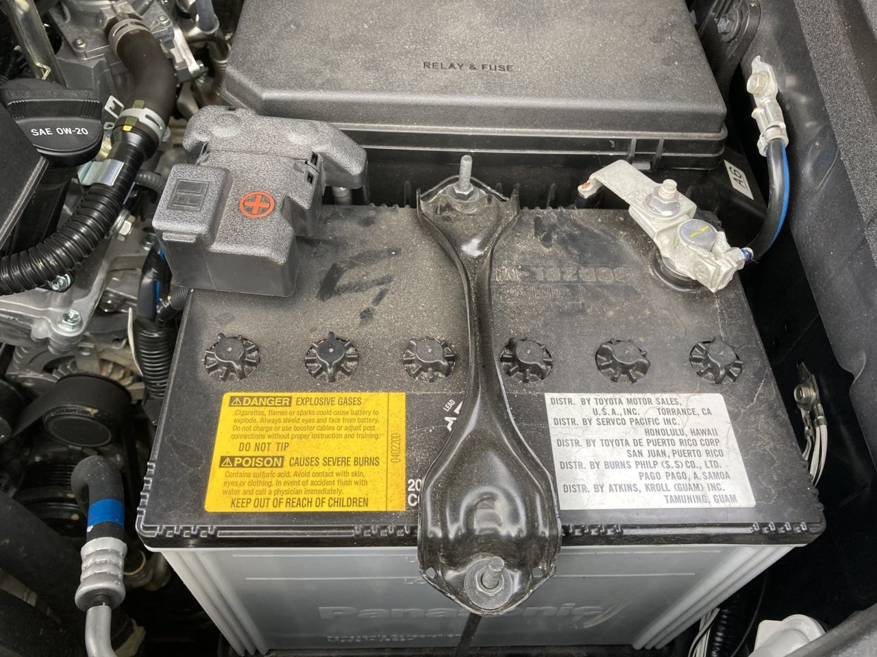

    I took this opportunity to clean up my shitty amplifier mounting, it all fits in the oddly convenient channels located under the rear seats.

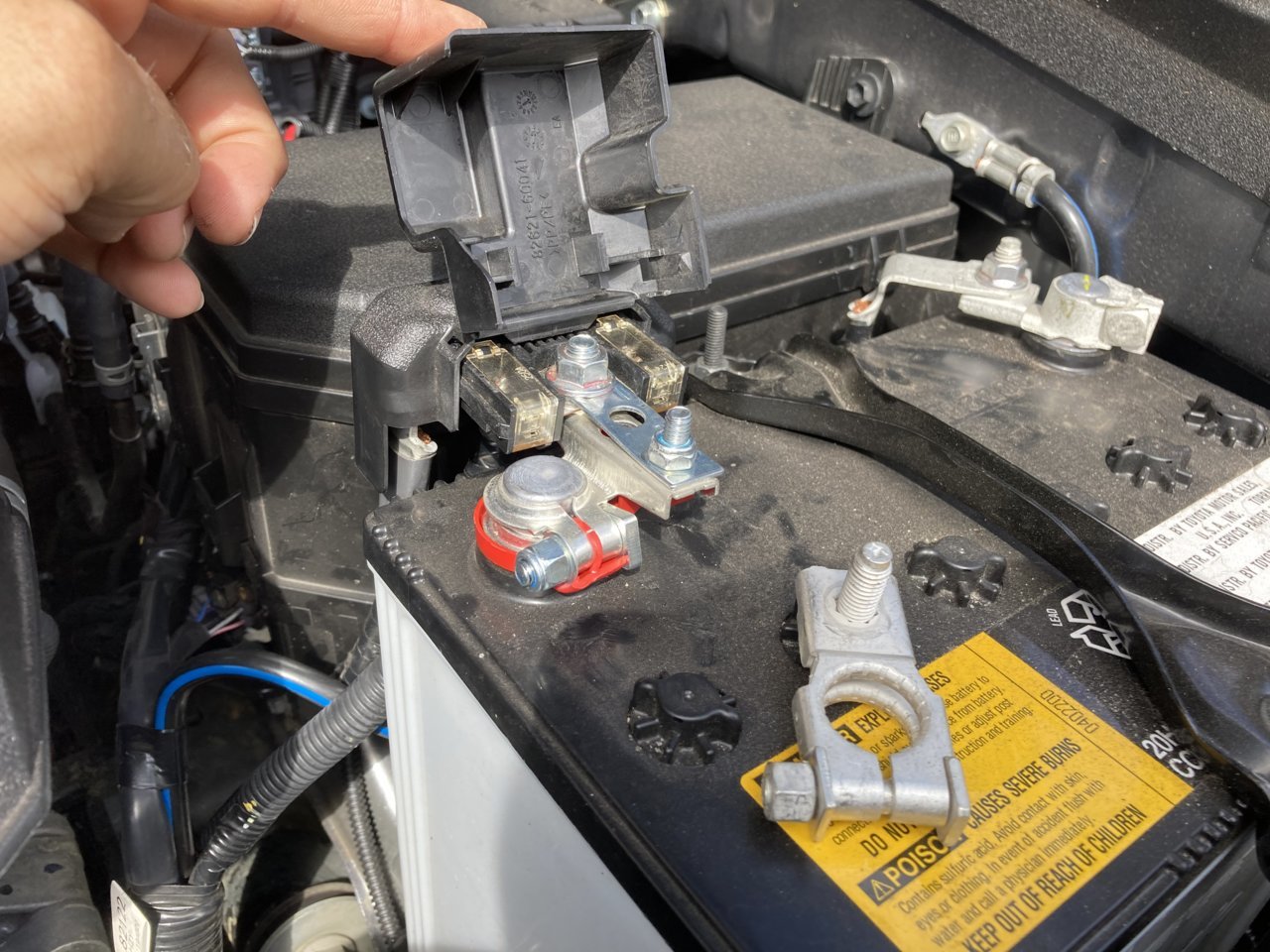

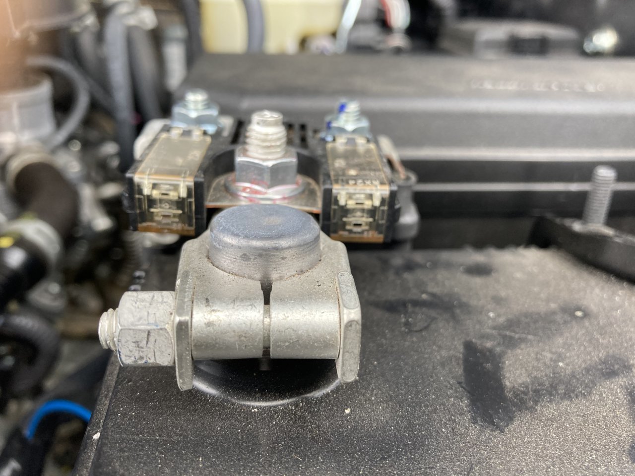

    The 2020 4Runner battery terminal is total bullshit for trying to bolt on one more big fat wire. My god what a massive plastic block over the positive terminal, wonder what’s underneath?
    Oh WTF! Where am I going to stick the power cable for my amps?
    After digging around I finally found a solution and threw it on.
    Fuse holder mounted and beefed up factory ground.
    Penetration into the cab.

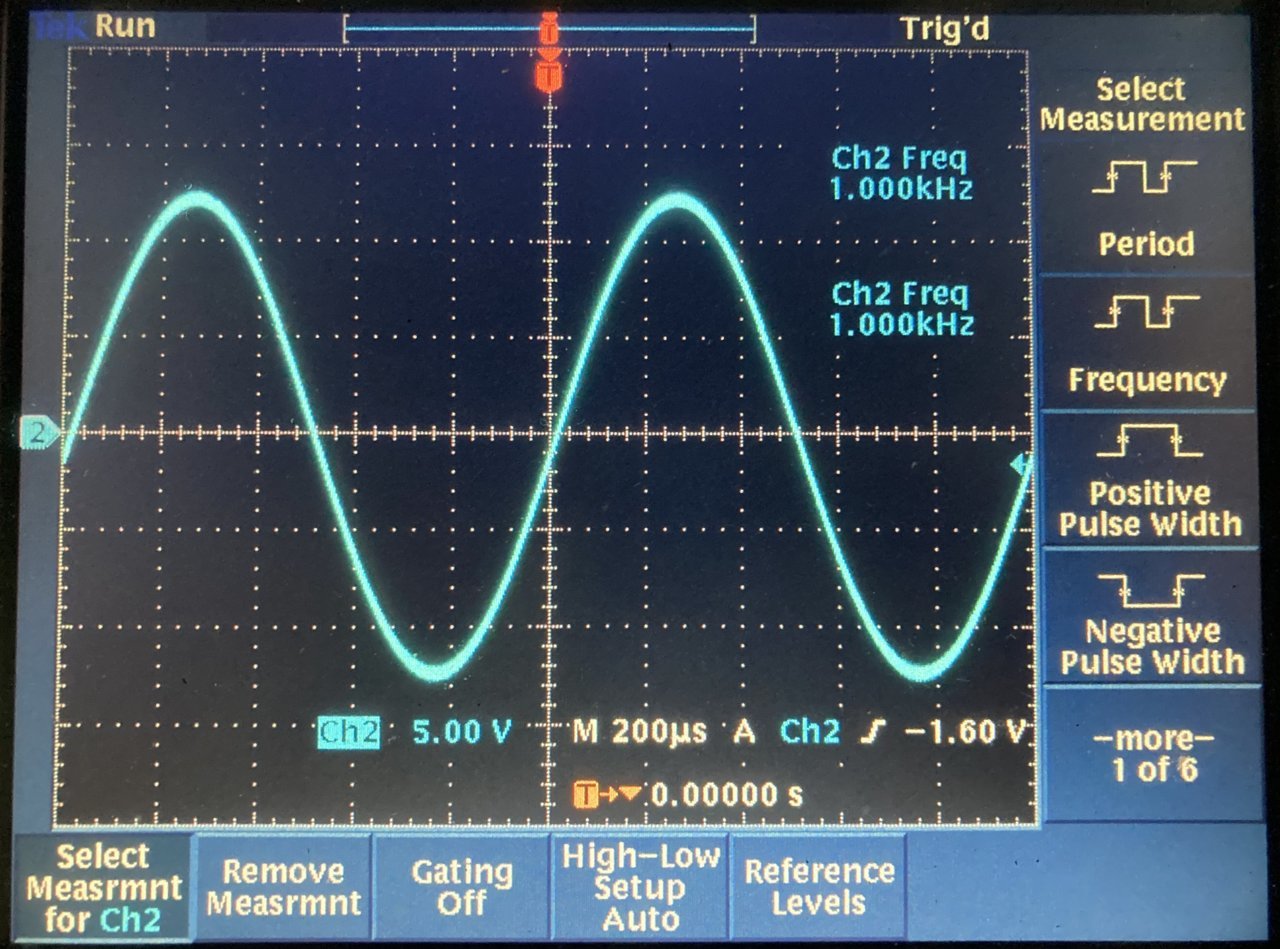

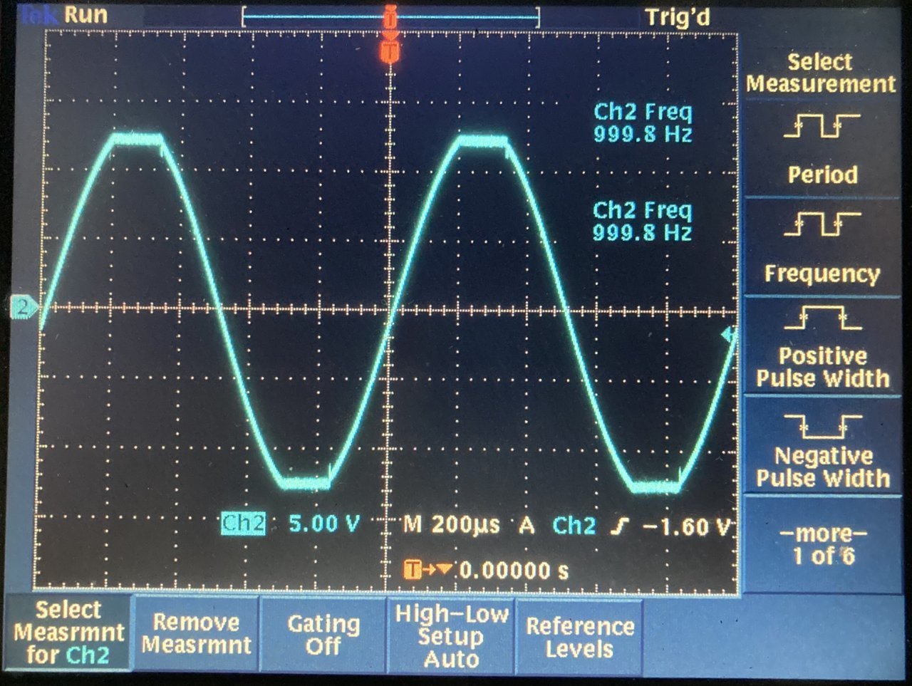

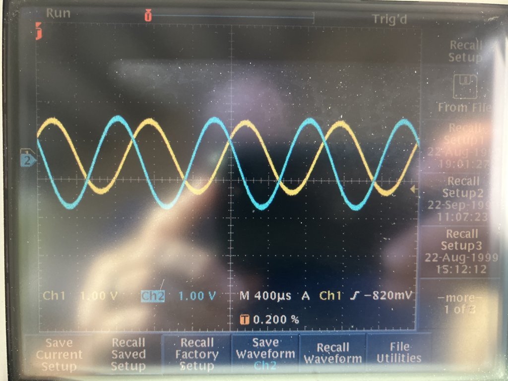

    Alright so there are times when you wanna know when your stereo starts clipping, usually this happens automatically when you have one of those new fangled amplifiers and it gives you lights and shit and you don't know what's going on but you do know GREEN = GOOD! So, I'm here to show what's happening to the signal, but also to figure out where the factory radio begins to distort. Interestingly, and annoyingly each channel begins to clip at the same voltage but the fader is slightly different for each channel when it reaches this voltage... You may or may not care, but generally, aftermarket stereos can reach full volume and not send a distorted signal. Nice ones anyway.
    I put on the 1KHz sine wave and with the speakers disconnected, I connected my oscilloscope to the amplifier input connector for each channel and checked the fader setting when each begins to square off.
    This is what a 1KHz tone looks like with no clipping.
    This is what a 1KHz sine looks like just as clipping begins, note the slight square shape of the wave at max amplitude.
    And here it's just damn obvious the wave is square and definitely distorted.
    Here's the list of fader settings for each channel where the signal just begins to clip, one notch down and no clipping occurs.
    Front Left - Fader 55
    Front Right - Fader 49
    Rear Left - Fader 52
    Rear Right - Fader 51
    I guess the only explanation for these differences is that the output is attenuated for the driver position, or some position anyway, as the right side of the vehicle reaches voltage sooner than the left side, and the driver front reaches voltage last which makes sense, being the closest set of speakers to the driver's seat.

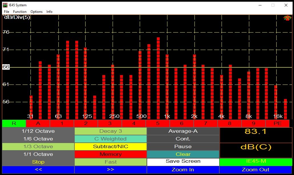

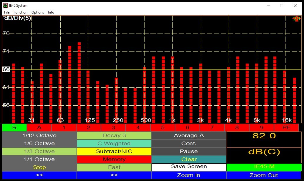

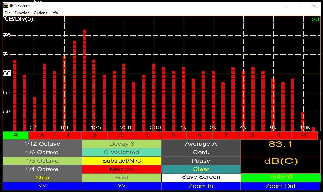

    I took screens of the factory signals so you could see what you are sending to your amplifier from the factory radio (these are not acoustic measurements). It's very sad but good to know.
    Front L/R Factory Stereo output spectrum response.
    Rear L/R Factory Stereo output spectrum response.

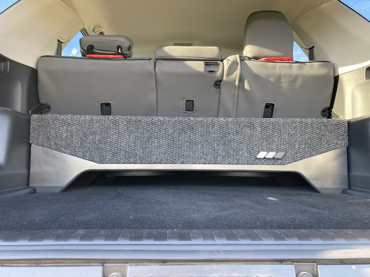

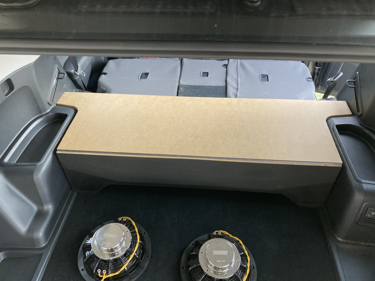

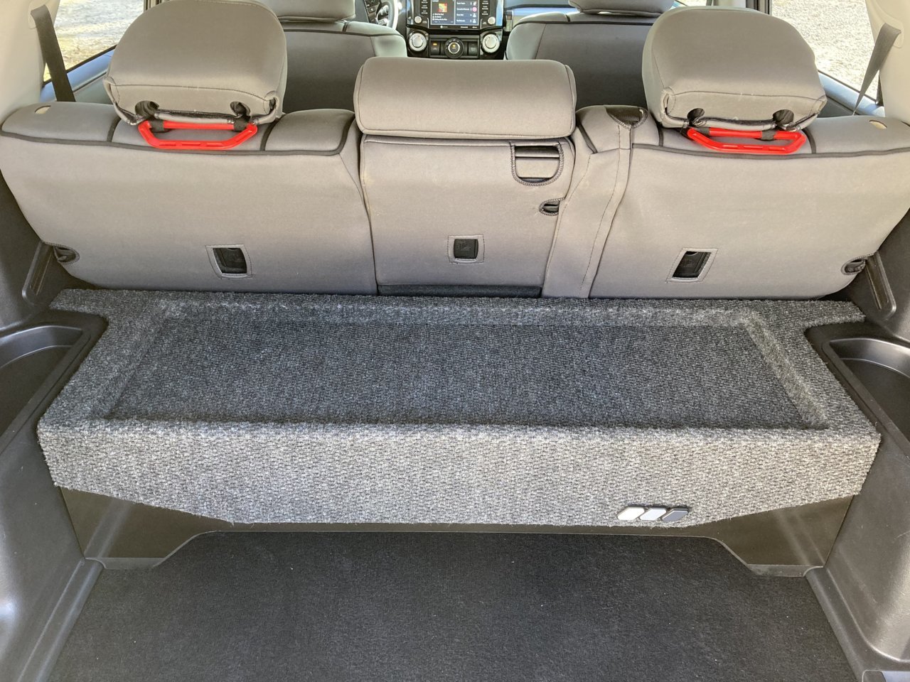

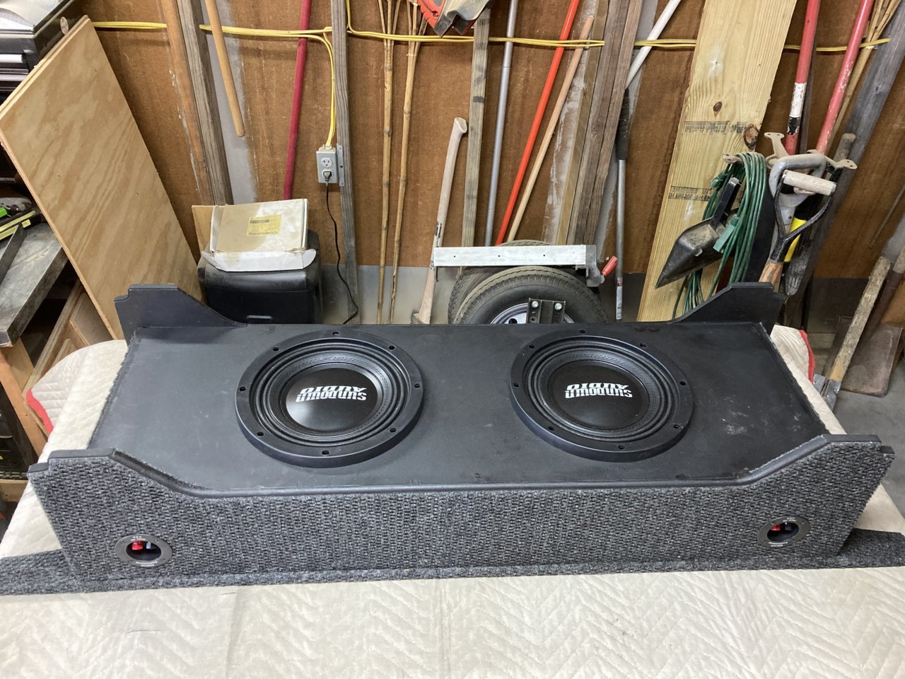

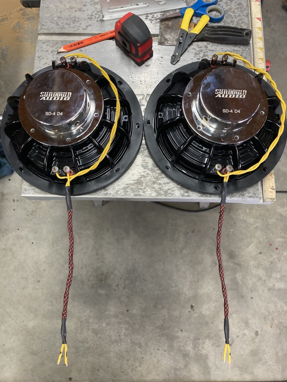

    Subwoofer

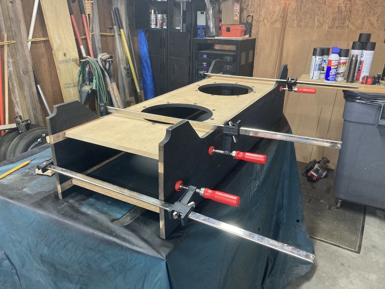

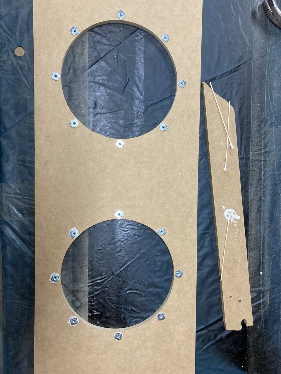

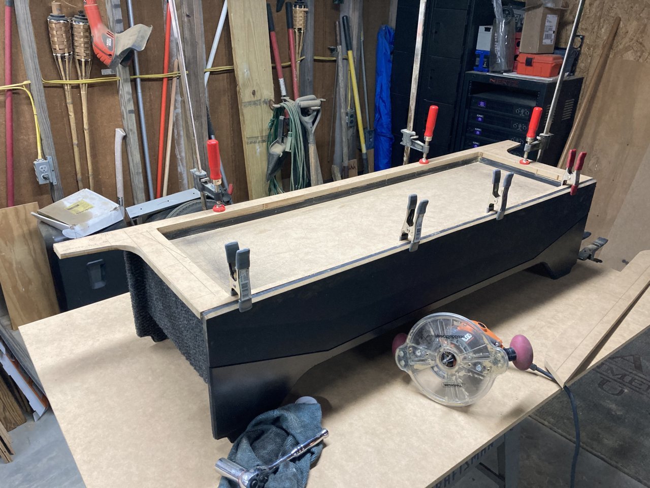

    I opted for JL Audio HD 1200/1 and a pair of Sundown Audio SD4-10 subwoofer drivers. I want to run at 4 Ohms, hence the JL amp, since it puts out rated power anywhere between 1.5 and 4 Ohms, but also the JL HD amplifiers are nice and compact. I've been running the HD 900/5 in my Tacoma for about 10 years now and it's been flawless, powerful and clean.
    I opted for MDF because it’s universally agreed upon as one of the most uniformly dense materials, a trait beneficial to subwoofer performance. Originally I was thinking fiberglass pods over the wheel wells but I was kind of sold on this once it was suggested to me by a friend to add a tray on top and try to match it up with the wheel well trays. The built in tray has been extremely useful.
    The shape of the legs matches the shape of the 4Runner grille, and the carpet in front mimics the hood line. The paint on front looks remarkably like Magnetic Gray. The rest is just trying to make it look like it belongs instead of tossing a generic sub box in the back.
    Subwoofer amp installed. I’m annoyed by how long that took but I didn’t really have a plan until I figured out under the rear driver’s side seat is the only place it would go.

    Working on a 12 channel system for mine soon, and found this thread. That enclosure looks great!
    dolbytone[OP] likes this.

    I am new to the audio world but I am a custom cabinet maker would you mind sharing the cut list for the sub box ?
    roooo likes this.
