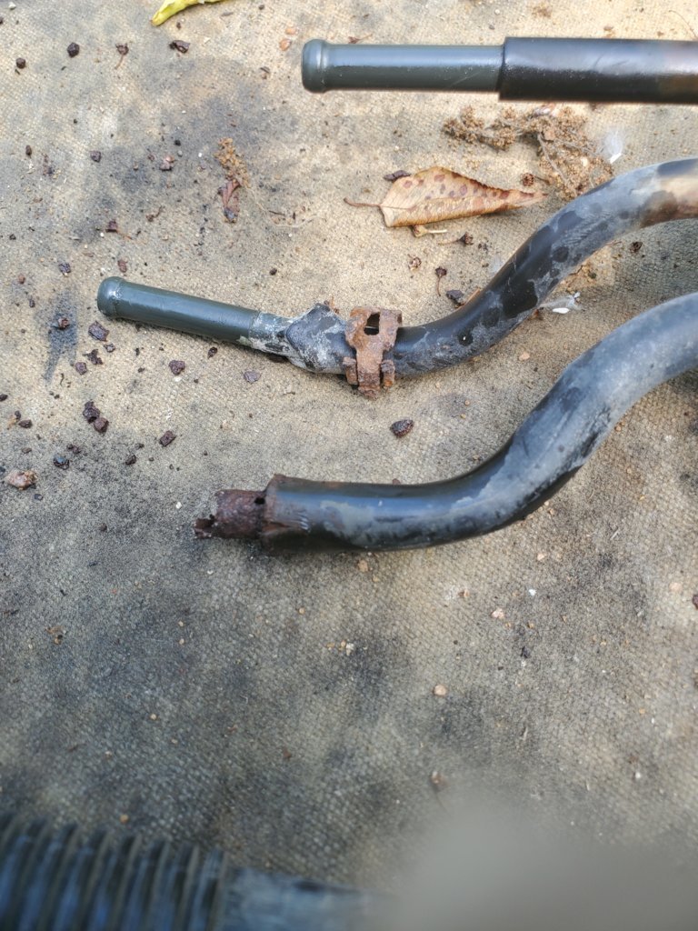

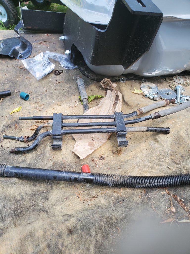

    These are lines that connect to the charcoal canister above the spare. Tubes are rusted beyond saving. Do I just bypass the hardlines with fuel line and barb unions, or is this part available? I can't find a part number for it

    Part number for that should be:
    7702635120
    That's what partsouq.com gives me.
    It is discontinued. So yes, you'll have to rebuild it with fuel hose and connectors. Looks like just that 1 line needs replacing.

    I'm sure you can remake the lines using nicopp which wont rust and will be much easier to shape.
