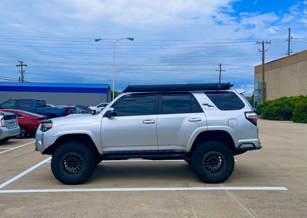

    33's look great with no lift imo. But if you want it, keeping the lift mild at <2" is probably the best bet to keep your suspension geometry intact. Over 2.5-3" you may benefit from UCA's and a track bar correction kit. Which adds some cost and complexity.
    The tire fitting/cutting concerns will have a lot to do with wheel choice. With the stock wheel size you can get away with very minimal cutting for 33s. If you choose a wide wheel with negative offset to get some tire poke you'll be trimming quite a bit.
    Since you asked for pictures, here's mine.
    34" Tires (285/75/17)
    RRW 8.5" -12 offset wheels with spidertrax spacers
    Extended Travel Dobinsons suspension set to 3.5" of lift.
    Full skids, low profile bumpers, winch, roof rack, and all kinds of misc mods.

    What is that guard/skid plat behind your rear wheel?

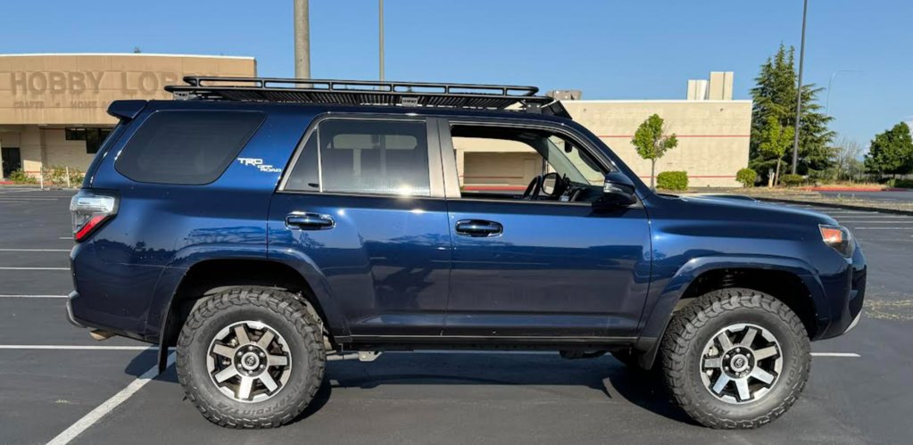

    As stated above, just adding a more aggressive tire will change the look of your ride quite a bit. I struggled with this decision myself and ended up going with a mild lift; I installed the Eibach Pro Truck Stage 2, which is a 1" lift in the rear and adjustable coilovers in the front that will give you between 2" and 4" of lift. After several adjustments, I ended up with somewhere around 2" to 2.25" of lift in the front. I have 285/70R17 BFG KO2's on OEM TRD ORP wheels and the only time it rubs is in reverse with the wheels cranked all the way to the right. It rubs the front fender, which isn't a big deal as it can be easily trimmed with a utility knife.
    Here is a picture after the final height adjustment.

    Just a bash bar with side hoops. It's a DIY kit from 80% Off Road. They send the bent and notched tubes all I did was cut to fit and weld them on.
    Got REALLY tired of ripping the rear bumper off. Departure angle on these rigs suck.
    Its taken some hard hits
    https://www.youtube.com/shorts/micixzVWqMg
    ^One of those oh shit moments where you know stabbing the brake will roll you, so you let off the brake a tad to let gravity take the vehicle down hill instead. Not a great habit as I definitely picked up a little too much speed at the end... but better than panicking, stomping the brakes and rolling the vehicle.
    This video is nearly a year old now but I still tend to do the same thing on steep downhills when I start lifting rear wheels! lol

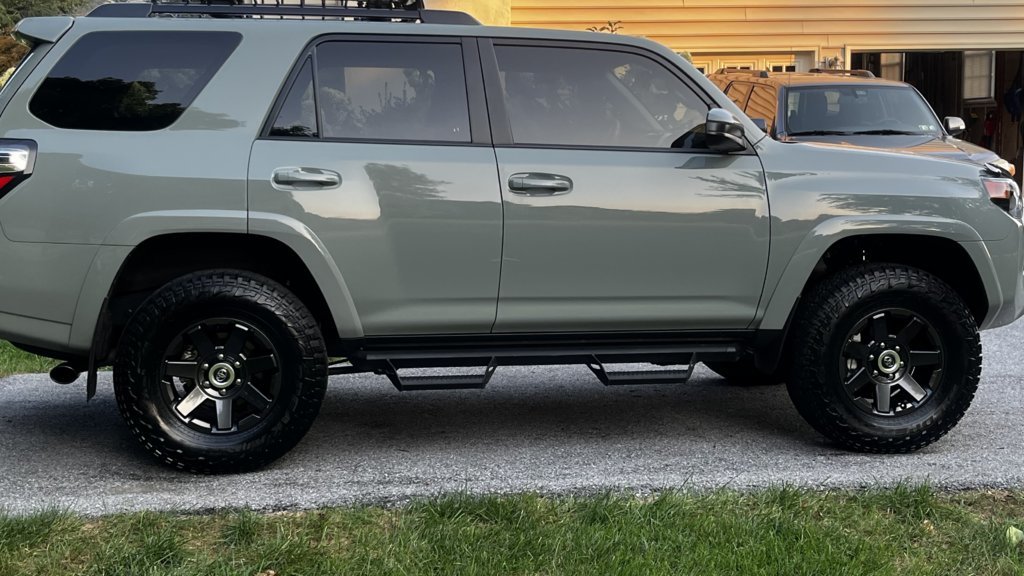

    i agree. Do a proper lift, 2” lift and no spacers. No cutting no BMC and keep stock UCAs

    Cesar
    2021 TRD ORP
    Your 4rnr looks perfect. You have 2” lift all the way around or just leveling up front ?
    What did you do to paint the wheels ? I would love to do mine like that .
    Tnx , cesar
  10. Jun 4, 2025 at 7:52 PM
    2,420
    Thank you! Heres my set up:
    2” lift Bilstein 6112 w/600 lb coils front, 1.5” lift Eibach T13 coils rear, Bilstein 5100 rear shocks, TRD skidplate, 285/70/17 Falken WP AT3, Energy Suspension front bumpstops, SSO Slimline Bumper w/ Badland Shackles, Durobump bumpstops 4.25” rear
    Rims are factory Trail Special rim.

    I’m likely going to purchase a 6112/5160 setup to try out. I think I’d like the firmer valving. Having seen you recommend this, (you win the award for how many times) has helped convince me to do it!
    I’ve previously narrowed it down to this or Dobs IMS since I only want 1.5” up front.
  13. Jun 5, 2025 at 4:18 AM
    2,420
    nice. You wont regret it, I believe you can go from 0-3” in lift with 6112. I love the ride quality on and of road as well as handling. Let us know how you like the 5160s in the rear. I was thinking about swapping to those at some point.
