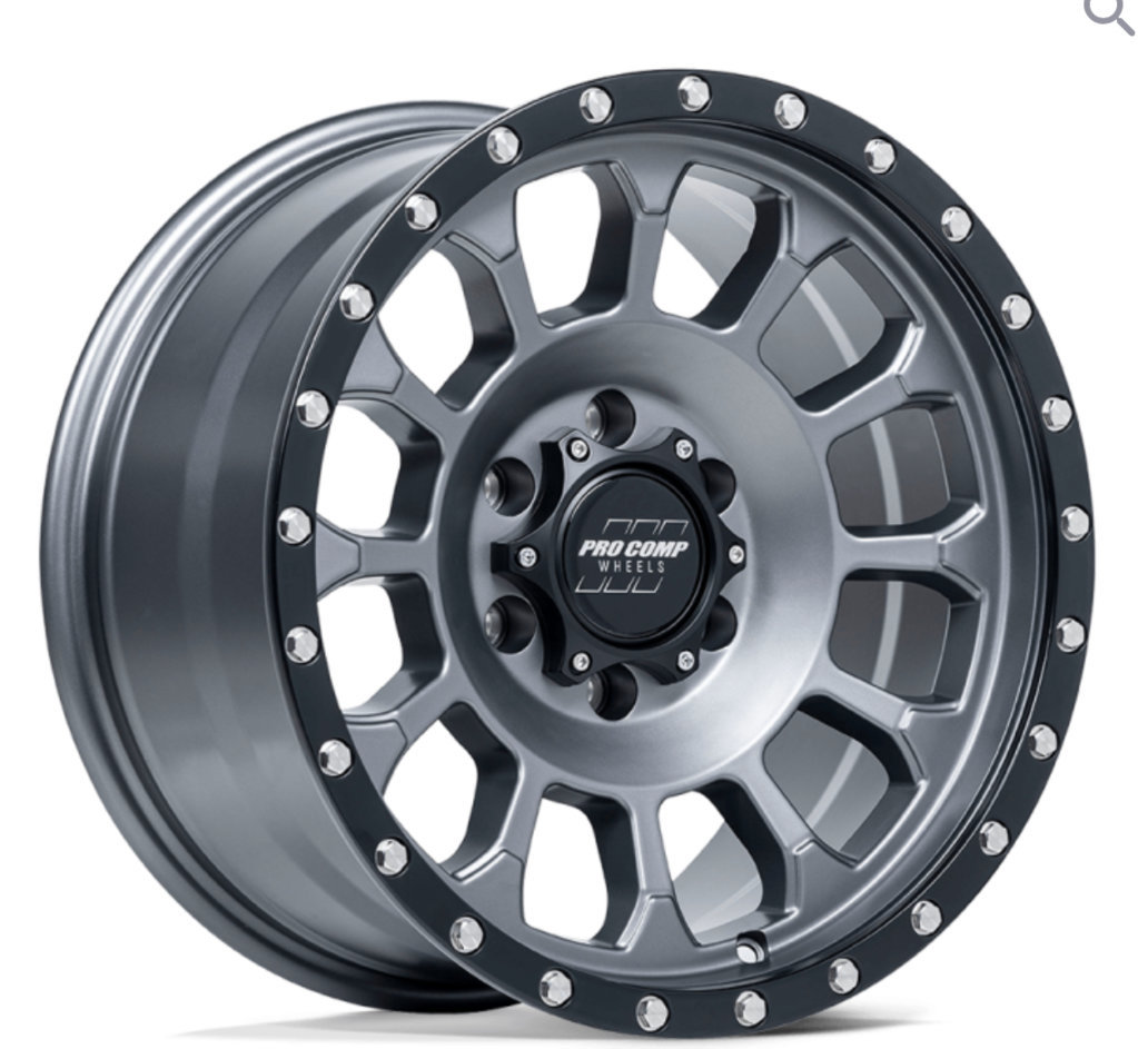

    Purchased ProComp PA34 Rockwells 17x8.5 0 offset and putting them on stock Bridgestone Dueler H/T 265/70R17
    Anyone have this combo and can send pics? I’d like to see how far they stick out past the fenders and also find if you’ve experienced any rub? I don’t want to do any cutting, levels or lifts.

    0mm offset won't stick out past the fenders with stock size tires. Might rub a little though (probably tire dependant). I have Toyo AT3's on 17x8 with 0mm offset and get a slight rub at full lock in reverse.

    I have same spec wheels (different brand) with stock size Falken Wildpeaks AT3. No rubbing at all. (Though I have a front 1" leveling spacer for front). But even with stock suspension I don't think you would rub or need to do mods.

    No they do not.

    I have SCS Blaze 10's in 17x8.5 with a -10 offset, and with stock size Wildpeak AT3's they rubbed pretty noticable on my passenger front mud flap at full lock. I didn't want to do a delete yet so ended up cutting away the bulk of the middle of the flap to get rid of the rub. And mine is lifted 2.7" in the front. And with stock size, on that wheel, they look much larger than a 265.

    I have this same size wheel and offset with stock suspension and stock size AT tires. No rub

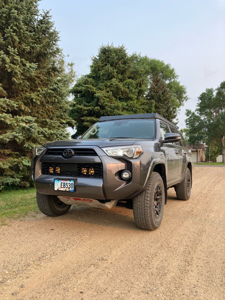

    Not mine but these are 17x8.5 0 offset with factory duelers. It may have a 1" level if I remember right.
    sgoet13[OP] likes this.

    2021 Grey 4Runner
    This looks great, I think I’ll be happy with my choice then.
    Trees91[QUOTED] likes this.

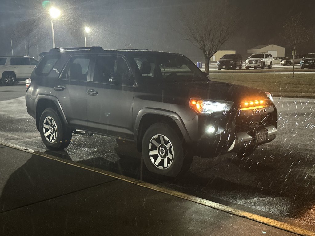

    Yep, it'll look just fine. Using the stock duelers on different wheels was originally my plan as well but I ended up finding geolandars on a really good deal.
    These are replica wheels...17x8.5 0 offset and 255/75 tires

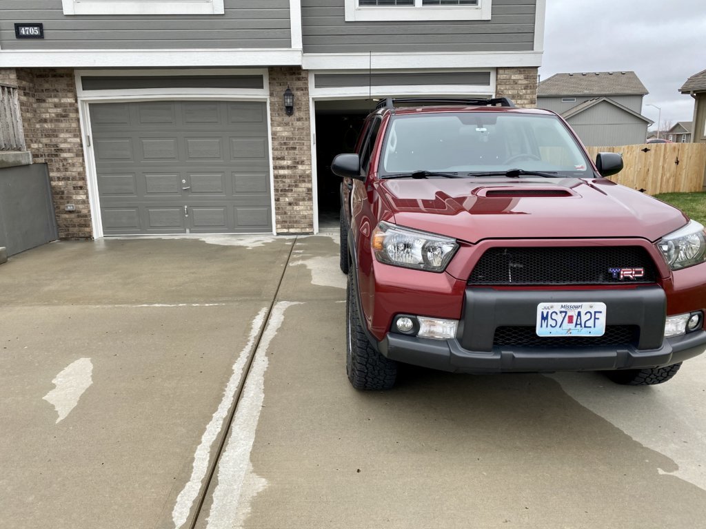

    This was my 2013 Trail with 17x8.5 wheels with -6 offset. The tires were 265/70/17 Falken AT3’s and they did not stick out past the fenders. Also had no issues with rubbing. IMG_7068.jpg
