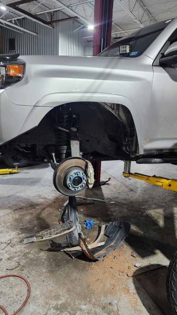

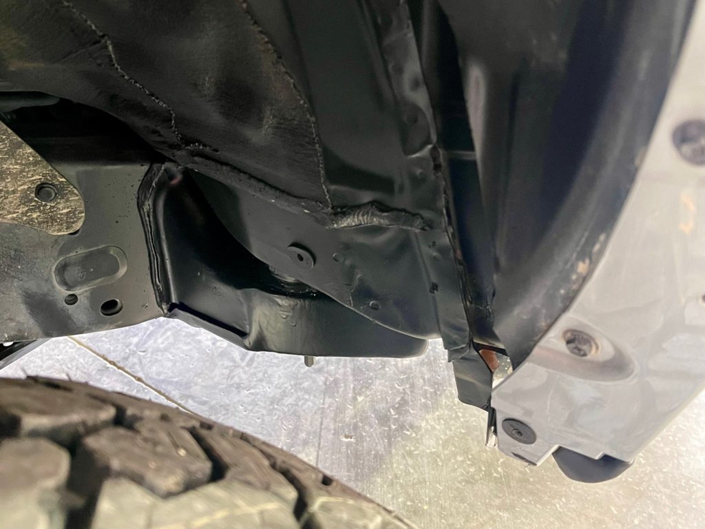

    KING shocks 2.5 - OME rear springs - SPC upper/lower control arms -285/70R17 Mickey Thomson Baja boss A/T tires - power stop Z36 brakes - professional undercoating & detail with ceramic coating - tints - full LED interior lighting bulb replacement - Bora 1.25-Inch Wheel Spacers - professional body mount chop to accommodate bigger tires and the wheel spacers. Sherpa crestone sport roof rack. - Pelsee 12 pro max dash cam. AlphaRex Universal Toyota Dual Color LED Projector Fog Lights.
    I have 285/70/r17 mickey thomson baja boss a/t - bilstien 5100s & OME suspension - 1.25 wheel spacers Spidertrax - I had to do a body mount chop and cut a little of my lower front fender. Couldnt be happier, I get compliments all the time on the look. I is a perfect stance/aggressive look. I have had my spacers on for about 10k miles. every tire rotation I check all bolts. Never had an issue so if that helps ya any!! PM me if you have any other questions
